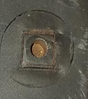

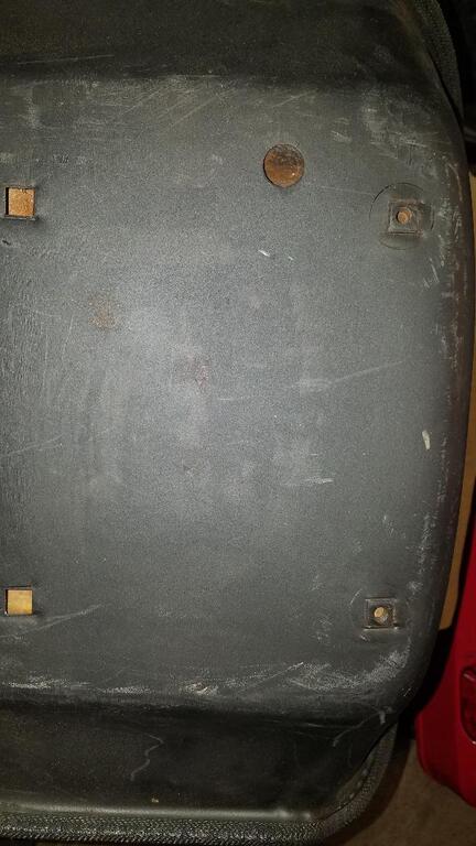

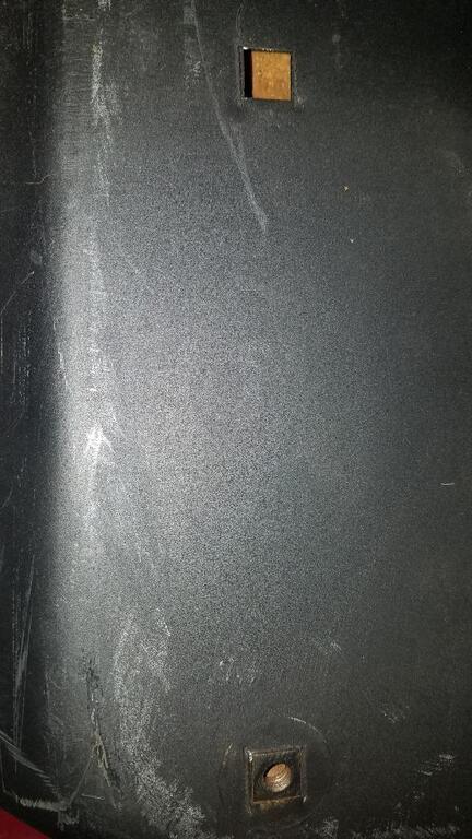

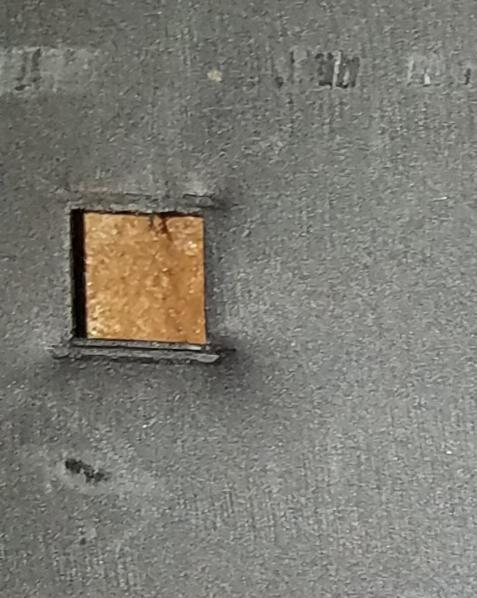

Brockport Bill 2,432 #1 Posted April 15, 2022 See photos ---- I have a seat with 2 missing hole anchor tabs on the back -- thus, no threads for seat bolts to screw into? The seat is in excellent condition but the seat is missing two of the 4 "female" anchor tabs. Does anyone know of a solution for this problem? thanks 1 Share this post Link to post Share on other sites

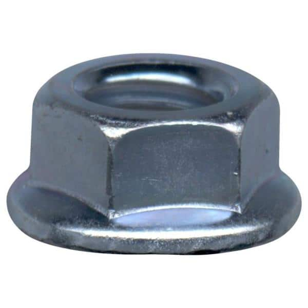

edgro 680 #19 Posted April 16, 2022 Weld in a flange nut. If you do one small weld at a time and immediately cool it with a spray of water, it shouldn't bother the foam too much. 3 1 Share this post Link to post Share on other sites

roadapples 6,987 #22 Posted April 16, 2022 I really think those cage nuts would work. Also can't tell by the picture which are missing. I've used only the 2 fronts. Don't have to worry about the seat tilting forward, only backwards.... 1 Share this post Link to post Share on other sites
Brockport Bill 2,432 #23 Posted April 17, 2022 1 hour ago, roadapples said: I really think those cage nuts would work. Also can't tell by the picture which are missing. I've used only the 2 fronts. Don't have to worry about the seat tilting forward, only backwards.... the two front holes -- so yes, a bit unsettling if leaning back 1 Share this post Link to post Share on other sites
