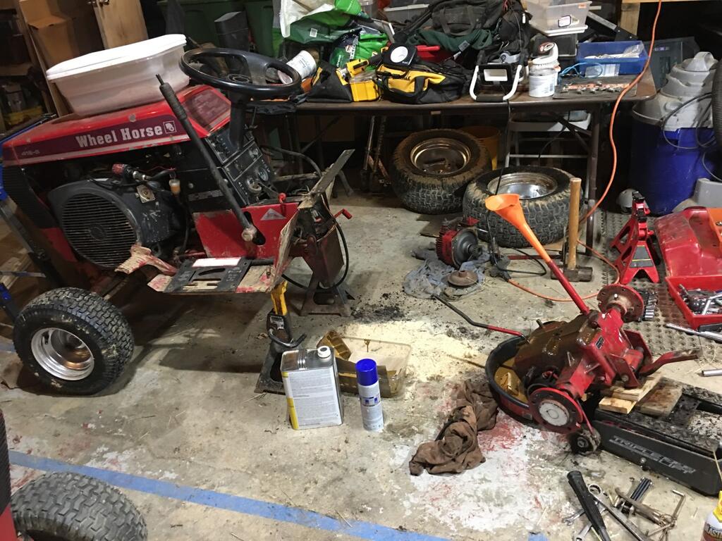

davem1111 2,374 #13 Posted April 26, 2022 (edited) I didn't realize that the mounting bolts that connect the trans to the frame went all the way through, so since I was unable to get the drain plug out ahead of time the trans made a big mess when I pulled it off! Ah well, nothing some Gunk and sawdust can't handle. Going to flush this trans a couple times then clean it up nice for some fresh paint. Heck, I'm into it this far, might as well do it all, right? Edited April 26, 2022 by davem1111 Share this post Link to post Share on other sites

davem1111 2,374 #15 Posted April 28, 2022 (edited) Two questions: 1. Is there some "trick" to removing the hitch pin on the rear of the 8-speed trans? I read a reference to it somewhere recently but can't find it now. I don't "have to" remove it, because I'm not splitting the case, but I thought I'd at least loosen it and maybe remove it for some re-painting. It was frozen up pretty tight and only had one circlip on one end, but I took that off, sprayed it with a lot of PB Blaster and got it to move. Sprayed some more, hammered it back-and-forth a bit. Now, it gets to one end if I try to punch it all the way out and stops. I'm guessing that the hammering has buggered up both ends to where they won't pass through (pretty obvious on one end before I started). Would the best approach be to take a grinder to one end to get the diameter back down where it's been hammered out? Or is this thing typically not worth messing with unless you really have to? 2. Somewhat unrelated - I thought as a "Supporter", I could edit the topic of a thread I started, but I can't seem to find a way. This thread started out a bit different but changed when I found oil in the trans and decided to drain and flush it, but couldn't get the drain plug out and now have pulled it. Edited April 28, 2022 by davem1111 left a word out Share this post Link to post Share on other sites
Handy Don 17,486 #16 Posted April 28, 2022 (edited) 16 minutes ago, davem1111 said: removing the hitch pin on the rear of the 8-speed trans Avoid hammering it and mushrooming the end? Oh, wait, too late for that. The fit is very tight. Any distortion of the end will hang it up. My most interesting success was to fit a large 3-leg gear puller. Legs on the shoulder of the slot hitch to the right and drive screw centered on a ¼" hole drilled into one end of the pin on the left. Heat, penetrant, patience (a hammer whack on the drive screw whenever I walked by once I had it under tension), and finally a solid whack on the drive screw and it popped free. From there I was able to drive it out with a punch in the ¼" hole. About 2 hours start to finish but only about 10 minutes of actual work. They are readily duplicated with simple ¾" rod so some guys have just cut off the ends between the hitch and the casing, applied penetrant, set a punch in a guide hole in the end (5/16 or even ⅜") and then gone at it with a hammer and punch. 16 minutes ago, davem1111 said: can I edit the topic of a thread? Nope. You can edit the content of any of your posts for up to a month. Ask a moderator (blue handles) via PM if you really think the topic should change. Edited April 28, 2022 by Handy Don 1 Share this post Link to post Share on other sites
