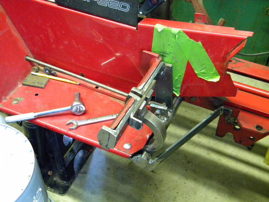

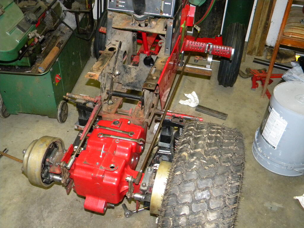

jeepdan 337 #35 Posted April 9, 2022 Been working on brake linkages. The left side I'm very happy with, especially with keeping the factory parking brake system. Still haven't finalized what I'm going to do on the right yet. The drive belt is in the way to allow discrete routing of a rod. The rod for the right pedal may end up on top of the floorboard, but at least it will be inwards close to the belt guard. Will have to fabricate a cover over it. 4 3 Share this post Link to post Share on other sites
Snoopy11 5,731 #36 Posted April 9, 2022 (edited) 1 hour ago, jeepdan said: The rod for the right pedal may end up on top of the floorboard, but at least it will be inwards close to the belt guard. Will have to fabricate a cover over it I think it would look fine even without a cover. Just as a thought... what I wonder... is can you bend the rods to go under...? Is that possible? Would probably require heating the rods in the places that you want to bend. Don Edited April 9, 2022 by Snoopy11 3 Share this post Link to post Share on other sites
jeepdan 337 #37 Posted April 9, 2022 2 hours ago, Snoopy11 said: I think it would look fine even without a cover. Just as a thought... what I wonder... is can you bend the rods to go under...? Is that possible? Would probably require heating the rods in the places that you want to bend. Don Could be done with a cable. If I remember right, my 36"RD mower deck has bumpers that rest up against the underside of the floorboards. Need to investigate further. 2 Share this post Link to post Share on other sites

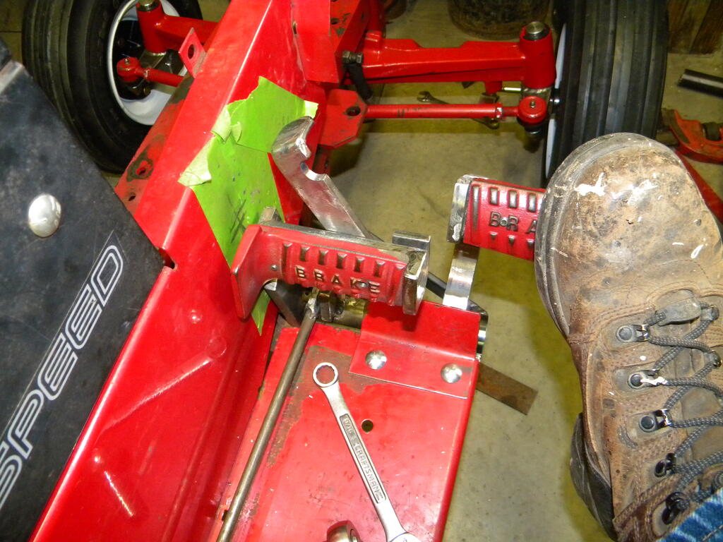

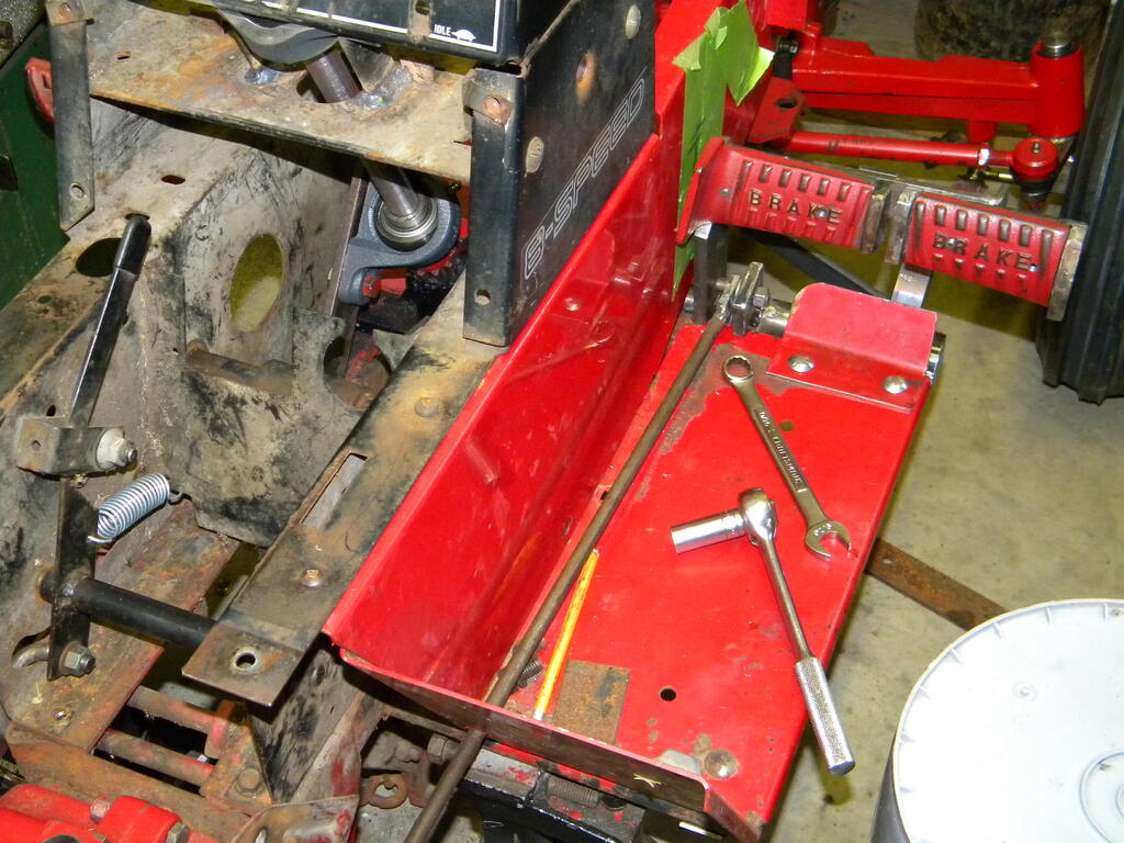

jeepdan 337 #38 Posted April 14, 2022 (edited) Almost have the pedals finished up. I think that the 3/8" rod passing over the foot board will be fine. Not going to make a cover for it at this time. Edited April 14, 2022 by jeepdan 1 7 Share this post Link to post Share on other sites
ebinmaine 81,047 #39 Posted April 14, 2022 1 hour ago, jeepdan said: pedals Can ya 'splain me how 'dis works?? I'm not seein' how the pedals are independent of each other. 1 Share this post Link to post Share on other sites
Pullstart 71,482 #40 Posted April 14, 2022 @ebinmaine there’s a lever that will likely rotate 100+ degrees inward that will unlock the brakes. During normal use, they’ll slow together. Unlocked, they are independent. It mirrors many large tractor pedal designs. 1 1 1 Share this post Link to post Share on other sites
ebinmaine 81,047 #41 Posted April 14, 2022 13 minutes ago, Pullstart said: @ebinmaine there’s a lever that will likely rotate 100+ degrees inward that will unlock the brakes. During normal use, they’ll slow together. Unlocked, they are independent. It mirrors many large tractor pedal designs. Only one I've ever seen up close is my 1949 Ferguson. That has a pedal on each side of the tractor for independent usage. 2 Share this post Link to post Share on other sites

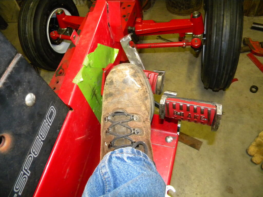

jeepdan 337 #42 Posted April 14, 2022 (edited) 45 minutes ago, Pullstart said: @ebinmaine there’s a lever that will likely rotate 100+ degrees inward that will unlock the brakes. During normal use, they’ll slow together. Unlocked, they are independent. It mirrors many large tractor pedal designs. Correct. And, being a photo is worth a thousand words, here are two. Edited April 14, 2022 by jeepdan 2 7 Share this post Link to post Share on other sites
ebinmaine 81,047 #43 Posted April 14, 2022 I love it. I love it. I love it. I love it. 1 1 Share this post Link to post Share on other sites
Pullstart 71,482 #44 Posted April 14, 2022 @jeepdan it would be really cool if you could flip that lever from the seat… toe action? 2 Share this post Link to post Share on other sites
jeepdan 337 #45 Posted April 15, 2022 2 hours ago, Pullstart said: @jeepdan it would be really cool if you could flip that lever from the seat… toe action? Pretty sure that I can lean over and reach the lever with my fingers. My Kubota is set up the same way with the lever behind the pedals, and I can reach it fine from the seat. Toe action? Not for me as I'm a below the knee amputee. 1 1 Share this post Link to post Share on other sites
