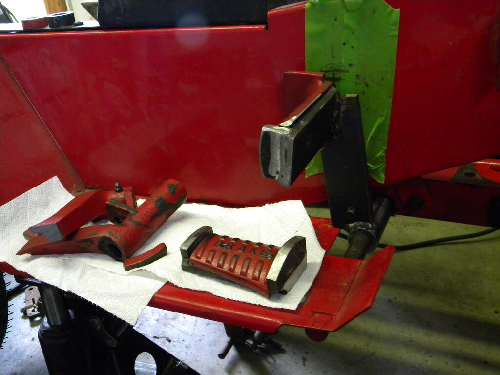

jeepdan 337 #1 Posted April 6, 2022 Brainstorming on this modification for a while. Mocking up the pedals. Wanting to keep a factory look and feel. So, I hesitantly cut up two good pedals (my 312-8 pedal and a 520H pedal) 4 3 Share this post Link to post Share on other sites

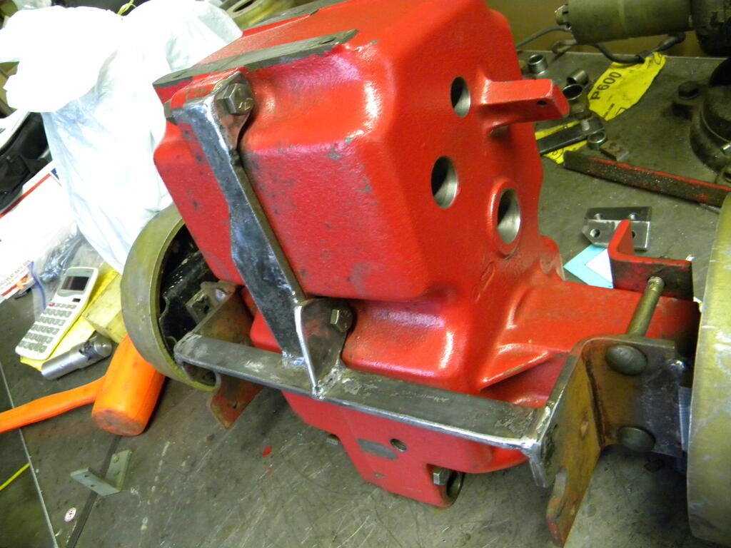

jeepdan 337 #7 Posted April 6, 2022 (edited) I have a girdle brace tied into the rear hitch assembly. Hopefully this will accurately locate and hold the backing plates for an expanding drum brake setup. More pics to come as progress is made. Edited April 6, 2022 by jeepdan 3 6 Share this post Link to post Share on other sites

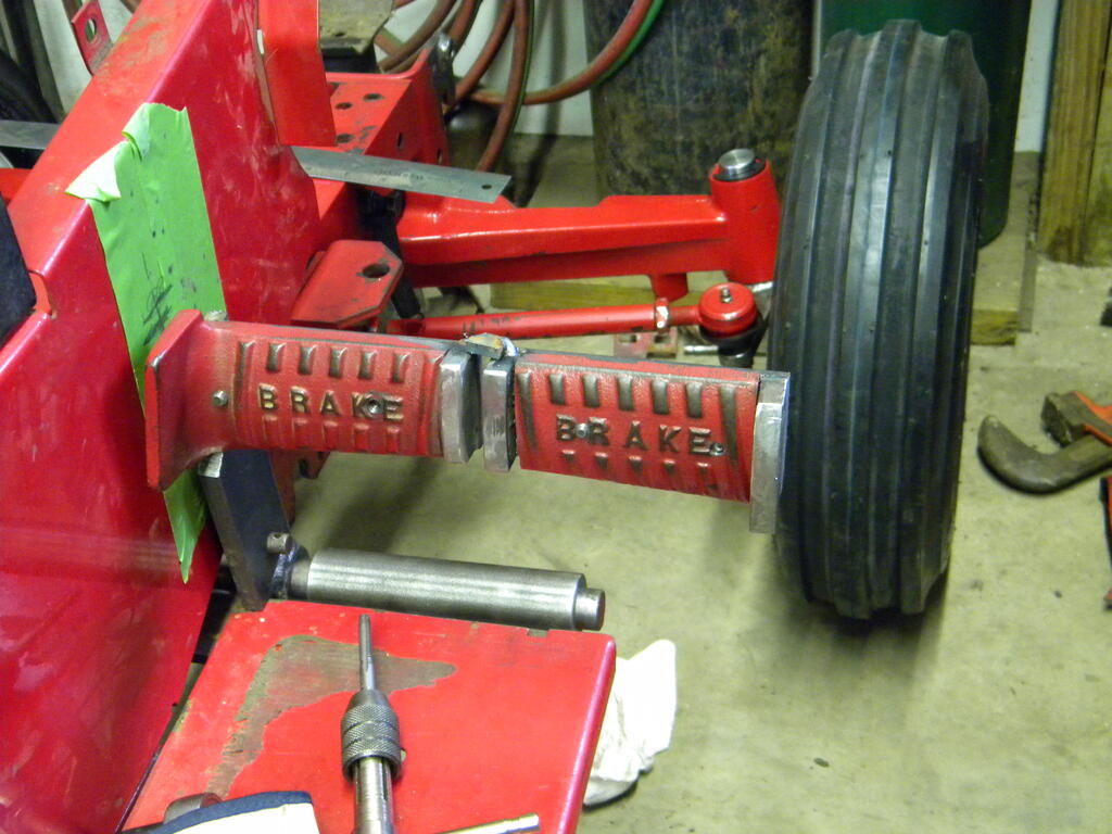

jeepdan 337 #14 Posted April 6, 2022 Here is a "teaser" photo. I will post more detailed info in the near future. 1 8 Share this post Link to post Share on other sites
