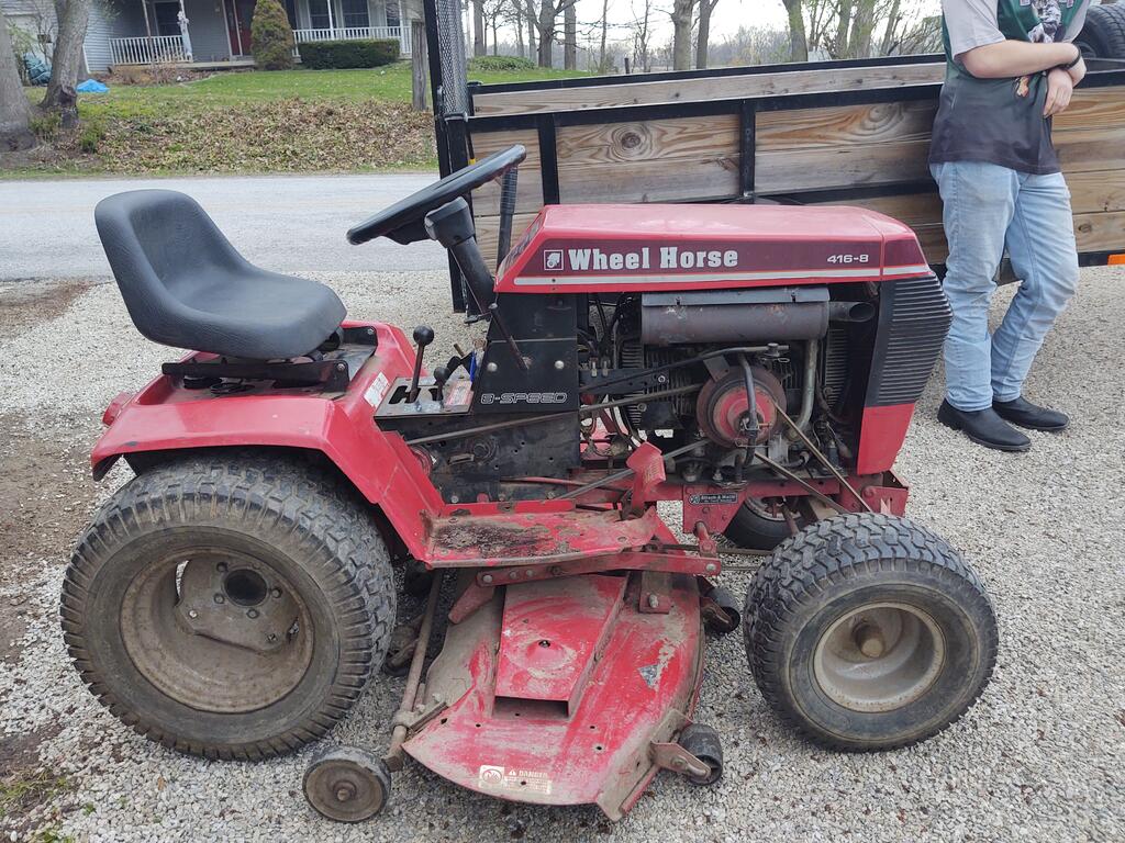

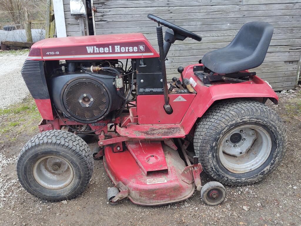

Woodbutcher 56 12 #24 Posted April 13, 2022 I finally had a one to get in to this machine a little today . She's pretty dirty . I started by blowing it off with the air compressor. It's gonna take a bit to get it cleaned up. Once cleaned I have an air filter ,oil filter ,fresh oil , spark plugs and I put a new battery in today.Im gonna try and post some pics. 4 Share this post Link to post Share on other sites
