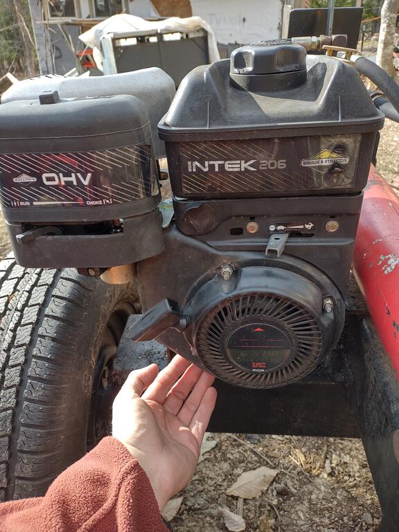

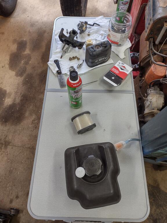

ebinmaine   81,139 #1 Posted April 5, 2022 Folks I've got this here B & S:    This is the powerplant for the Monster Splitter.   Last year it would not run right unless the choke was 1/2 closed/open depending on your outlook. 😀  I changed the fuel filter and cleaned out the carb. It got better... But not quite correct.    Sooooo...... This week I'm gonna:  Remove, empty, and clean out the fuel tank. (How?)  Change fuel filter, line, air filter, spark plug, rebuild carb and mount with new gaskets.   Should I remove the welch plug? Can I clean behind it if I don't remove it?   It's been suggested I should adjust the governor if possible. How do I accomplish that?  What else am missing?  Thanks.    1 Share this post Link to post Share on other sites

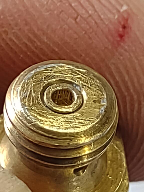

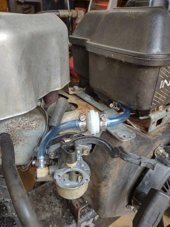

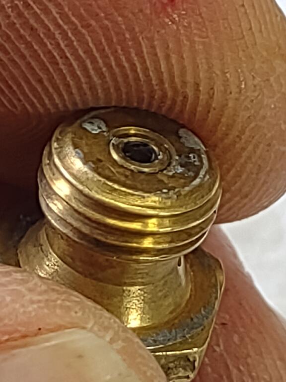

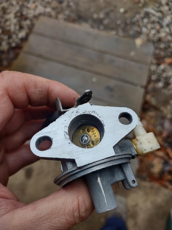

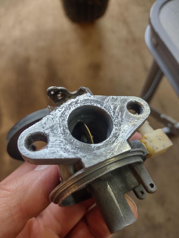

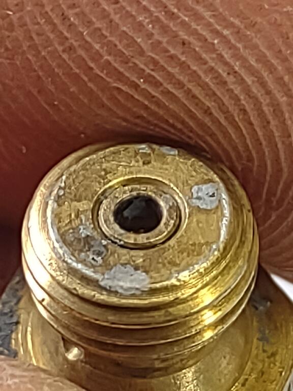

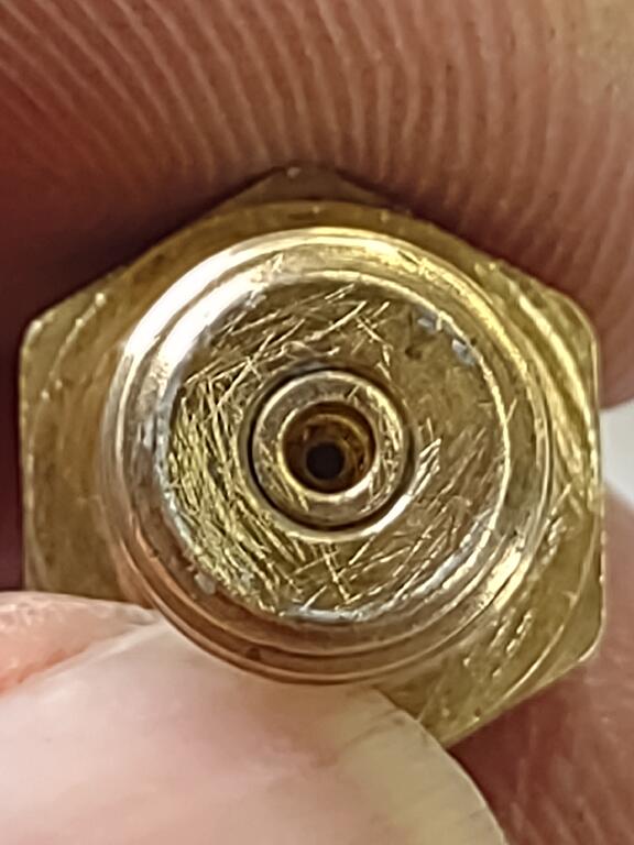

ebinmaine   81,139 #18 Posted April 9, 2022 Well peoples. The beast is up n runnin' again.  First things first. Thanks for the excellent ideas and help, as usual.   Today I commenced to the cleaning up and reattachifying of the crabutrader.    Turned out it had water throughout. Through-in too now that I think about it.  I sprayed brake clean through it every which way but loose, then did that too, just to cover all my bases.  (Never did figure out who's on first though)  The main High RPM feed bore was some gummeded up.  The main jet/bowl holding nut was the same and worse. Look carefully inside the bore.  So I used the sharpest pick/awl I could find and VERY carefully cleaned it up.    The main mounting surface was quite pitted.   I sanded that on a flat sheet of metal with 120 grit.    Cleaned out the tank. Added the mini fuel filter.  Did the rest of the assembly, checked and added oil and fired it up.   @#$$&+#)*!?!(/.  Water droplets were coming up out of the breather hose and landing on the way to the carb.  I checked the fill tube/dipstick holder and there was basic tan muck in it. But NOW.... We know the water's in the crankcase. So we dropped the ole/earl/oil into a bucket.  Refilled that. Started her up again.  @#$$&+#)*!?!(/. Again. The rotten cuss just quit. Shut off. Died dead. WTF??!!???  Trina tried to start it again whist I watched and saw that the spark (normally contained inside a wire) was landing on the heat shield.  So I got a new plug boot out my stock of me-built plug wire parts box. Thanks @squonk.    Fired it up again and SUCCESS!!   1 Share this post Link to post Share on other sites

8ntruck   9,382 #22 Posted April 9, 2022 Come to think of it, I sanded both flange faces on my carb flat - again, it did not help.  Didn't think to do a magnified inspection of the main jet. Next time I tinker with it, I'll check that.  Thanks for posting a follow up and your solution. 1 1 Share this post Link to post Share on other sites
