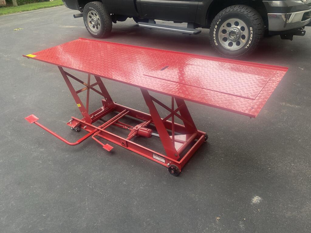

Marv 996 #1 Posted April 4, 2022 Legs are getting weak. Need a way to convert the hydraulic lift cylinder to a power system. Has anyone worked out how to do that? Marv 1 Share this post Link to post Share on other sites
Handy Don 17,212 #2 Posted April 4, 2022 That is an interesting challenge. There is a LOT of leverage being applied to the hydro pump piston, especially if you have the 1,000 lb version fully loaded. And the piston is likely generating several 000's of pounds of force due to the scissor mechanism. What comes to mind is an electric motor with a gear reduction driving a disc. A strut linking a shortened pump arm to a pivot on the edge of the disc supplies the reciprocating motion--think of the linkage on an oil well pump. I'd need to know what force is actually being applied to the arm to lift the table when at its maximum capacity to be able to size the components. I'm discounting an external hydro pump, since the system is self-contained now, including the critical check valves. Also discounting replacing the cylinder with it custom-manufactured mounting points. 1 Share this post Link to post Share on other sites

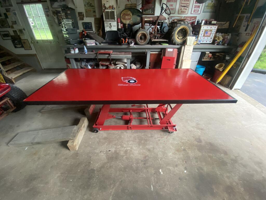

prondzy 3,890 #8 Posted April 5, 2022 I added a HF 12ton air over hydraulic jack to mine. A little modification was needed but nothing too serious a little cutting and welding. Hands down a great decision never have to pump again. If you want more pics i can get them for you. 2 4 Share this post Link to post Share on other sites
