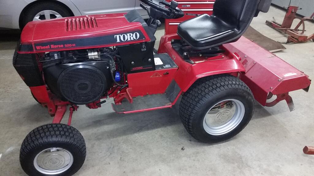

WHX?? 57,794 #3 Posted April 4, 2022 (edited) Yazell. Finding attachments for a 520 is usually not a problem its paying the price for what sellers want. The tiller can be off any 3, 4, or 500 series tractor but you will need the axle bracket and rear rockshaft kit plus the rear cable. If looking for a tiller make sure all the pieces are there like the mid mount belt tensioner is with it. Things have a way of getting lost when a guy takes off an implement. As Dan said a Brinly style hitch will fit right on but again you will need a rear lift cable and the tube it slides in. These were not standard on a 520 so many do not have them. They are available aftermarket but this is where things can start adding up price wise. Keep an eye on CL and if you FB their marketplace and you will find a tiller. One can probably make another brand work but it would be a pain. This is what's needed to run a tiller. plus the axle bracket which is available there too. https://wheelhorsepartsandmore.com/product/toro-wheel-horse-rock-shaft-kit-for-hydro-transmission-with-tube-bracket-long-clevis-read-description/ Edited April 4, 2022 by WHX?? 2 5 Share this post Link to post Share on other sites

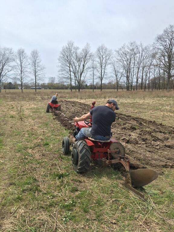

oliver2-44 11,694 #5 Posted April 4, 2022 If the land hasn't been tilled before, you will probable want a plow, then a tiller, or a plow and a disk. Depending on soil type, once its turned the first time you "may" be able to work it yearly with just a tiller. Others can comment more on this. Of course, once your set up with a plow you can find some plow days to join in the fun at. Or just host a plow day at your property and these guys will plowed it for you. 5 Share this post Link to post Share on other sites

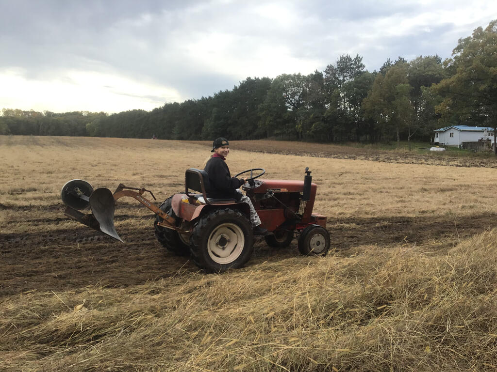

Pullstart 71,093 #10 Posted April 4, 2022 Be careful, you might find yourself traveling the country collecting, enjoying and working these tractors! Most of these pictures are from “Uncle Jim’s” place in WI. A measly 6 or 7 hour drive to listen to the tractors working (and his mouth jabber on) 2 1 Share this post Link to post Share on other sites

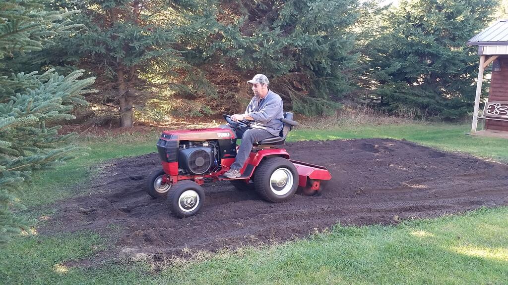

Sailman 1,307 #14 Posted April 9, 2022 I got a Craftsman plow with one of my C-120's and turns out its a Brinley design just tagged as craftsman. I used it to plow my garden plot, then used push blade (lots of them around cheap) to level the furrows and finished with a tiller. Regular self propelled rear tine works if you can't find one for the wheel horse. If you are not in a big rush keep your eye out on marketplace and craigs list as well as local yard sales and you can pick up a plow, blade and maybe a tiller. You will need to install the rockshaft kit, hitch and axle bracket but the expense is worth it for all the implements you can use. You can find a lot of the parts here https://wheelhorsepartsandmore.com/ Good luck with the procurement.....its half the fun! Share this post Link to post Share on other sites
