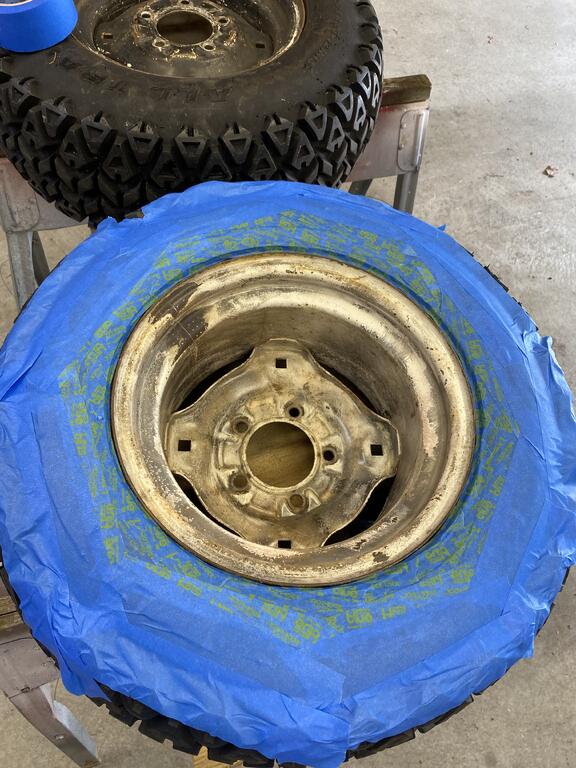

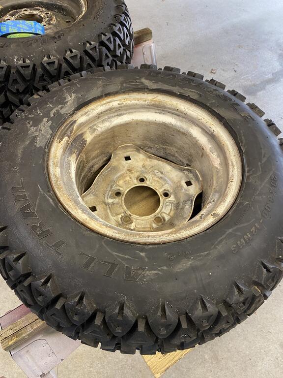

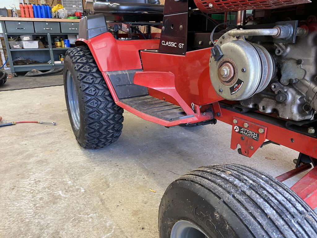

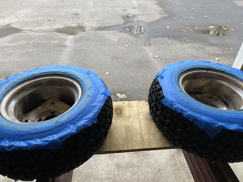

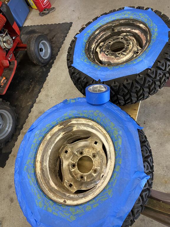

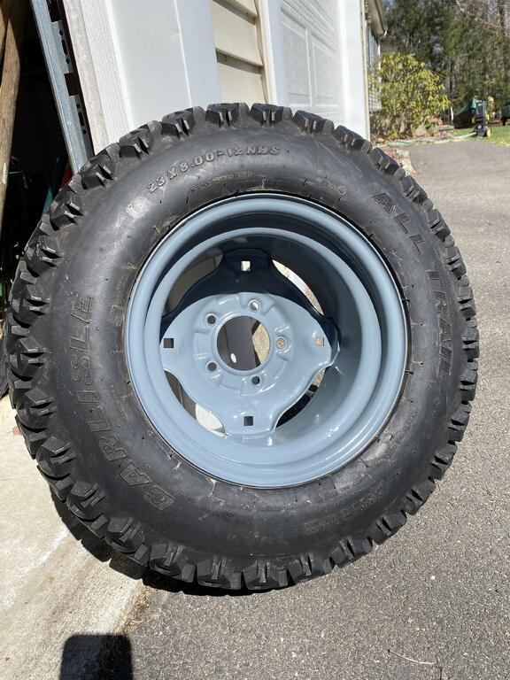

Sparky-(Admin) 26,621 #1 Posted April 1, 2022 After a test fit I have decided my newly scored Carlisle All-trails are going onto the 315… but not without a paint job. Only a coat of primer so far 17 4 Share this post Link to post Share on other sites
ri702bill 13,271 #2 Posted April 1, 2022 Mike - I'm fond of the deck of playing cards trick for rim painting - and they are reusable. 4 1 Share this post Link to post Share on other sites
Sparky-(Admin) 26,621 #3 Posted April 1, 2022 1 hour ago, ri702bill said: Mike - I'm fond of the deck of playing cards trick for rim painting - and they are reusable. Never tried that method but have heard good things about it’s success rate. Always masked mine off with good results. I am interested in what Eric’s @ebinmaine paint department thinks of my work 5 1 Share this post Link to post Share on other sites
"Manic-Mechanic" 1,486 #4 Posted April 1, 2022 (edited) 8 hours ago, Sparky said: After a test fit I have decided my newly scored Carlisle All-trails are going onto the 315… but not without a paint job. Only a coat of primer so far Never tried the playing card method, curious to see that? However, I use the masking tape as well and always had good results. Oh, and really nice tires, have a similar tread on a zero turn... Edited April 2, 2022 by "Manic-Mechanic" 3 Share this post Link to post Share on other sites
ri702bill 13,271 #5 Posted April 1, 2022 20 minutes ago, "Manic-Mechanic" said: Never tried the playing card method, curious to see that? Pretty simple actually - deflate the tire - don't break the bead. Place a card lengthwise in between the rim and tire - overlap, then the next and so on. A deck of 54 with the Jokers does 2 12-inch tires. 1 1 Share this post Link to post Share on other sites
SylvanLakeWH 32,776 #6 Posted April 1, 2022 I use math flash cards… covers up the math… 2 9 Share this post Link to post Share on other sites
ebinmaine 81,047 #7 Posted April 1, 2022 1 hour ago, Sparky said: Never tried that method but have heard good things about it’s success rate. Always masked mine off with good results. I am interested in what Eric’s @ebinmaine paint department thinks of my work Trina says that's a snazzy job there! She uses the playing cards method or a row of tape around the rim connected to newspaper. 4 1 1 Share this post Link to post Share on other sites
jeepdan 337 #8 Posted April 2, 2022 Very nice! What is the actual diameter of the Carlisle All Trail 23x8.00-12 tires? 1 Share this post Link to post Share on other sites

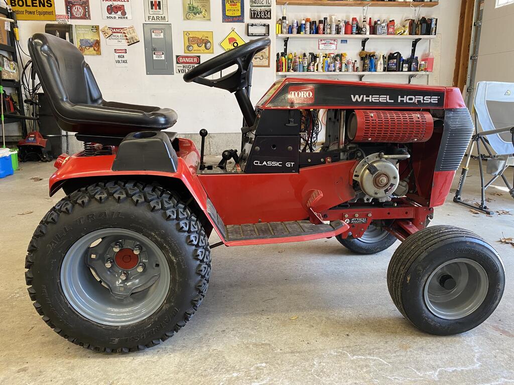

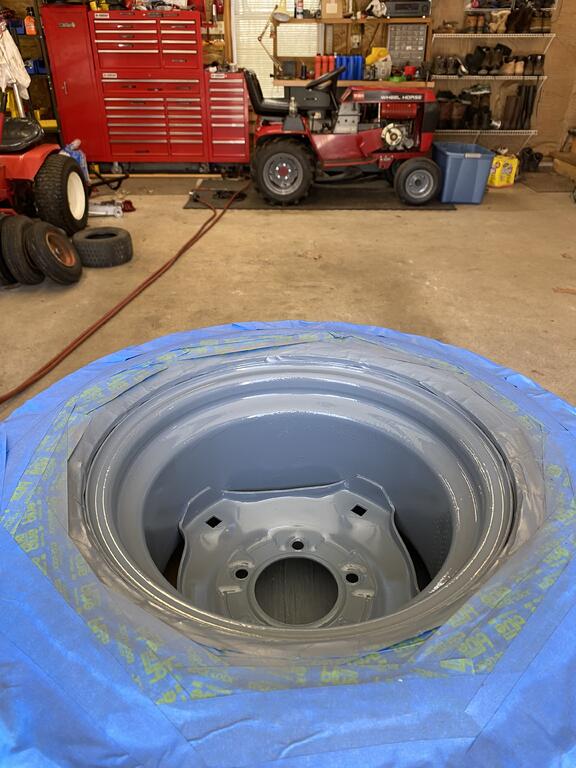

Sparky-(Admin) 26,621 #9 Posted April 2, 2022 Done! Two coats of this paint and I’m happy with the results. I’ll post up a pic of them mounted on the 315 soon. 3 4 Share this post Link to post Share on other sites
Sparky-(Admin) 26,621 #10 Posted April 2, 2022 I’m not a huge fan of Ag tires, they look cool but serve no purpose for what I do. These Carlisle All-Trails are just perfect! 5 2 Share this post Link to post Share on other sites

Brockport Bill 2,498 #15 Posted April 2, 2022 i have used the playing cards --- they work great - let out some air and stick them in ....faster than the detail work of tape to do curved fit in circle to get clean tight fit - but i love the larger flash cards - also i have used cards to do smaller mower deck wheel rims 4 Share this post Link to post Share on other sites

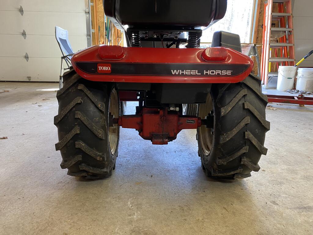

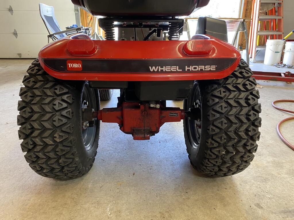

Horse Newbie 7,405 #16 Posted April 2, 2022 4 hours ago, Sparky said: I’m not a huge fan of Ag tires, they look cool but serve no purpose for what I do I am a huge fan of Ags… they serve a critical purpose for me. They make me look even more cool riding my Wheel Horse ! 3 Share this post Link to post Share on other sites

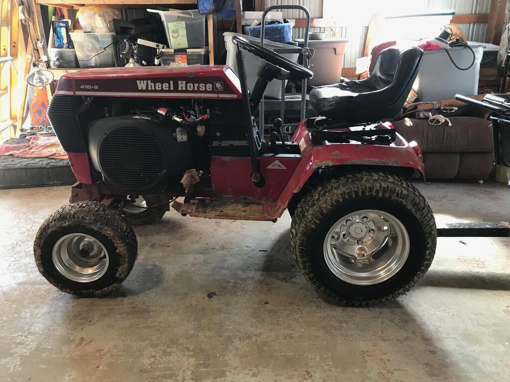

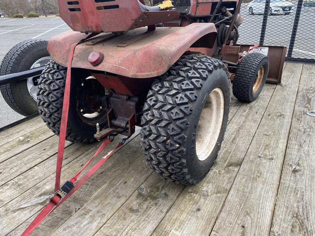

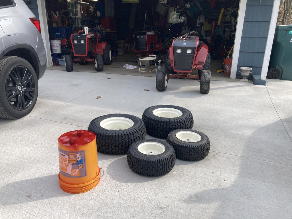

davem1111 2,432 #17 Posted April 3, 2022 5 hours ago, Horse Newbie said: I am a huge fan of Ags… they serve a critical purpose for me. They make me look even more cool riding my Wheel Horse ! I want to put some Ags on my 416-8 - I was sliding sideways the last few days trying to haul hay and feed out to the horses. It's been wet and very muddy. I have a pair of rear wheel weights but I'm sure I'd still spin even with those on. What I'd really like to do is buy a used pair or set of 4 Ags with rims for this tractor, if I can find some for a decent price. Brand new is a bit too much for my budget right now. BTW, when I bought it, it already had what looks like brand new chrome (or chrome painted) rear rims. It had one front tire that had numerous plugs and was leaking a lot, so I decided to buy a new pair of rims and tires. First thing I did was paint the rims with chrome paint. I'll take a few pictures tomorrow and post when I get a chance. I know chrome rims aren't original, but they look pretty darn good. If I ever decide to do a full restore, I'd want to go original color on the rims. (Which is white? or off-white? cream?) If I get Ags, these chrome rims will go on the 312-A but I'll need to swap out the spindles for the fronts - 312-A has 6 inchers. Eights would look better anyway. 2 Share this post Link to post Share on other sites
ebinmaine 81,047 #18 Posted April 3, 2022 9 hours ago, davem1111 said: Ags on my 416-8 - I was sliding sideways the last few days trying to haul hay and feed out to the horses. It's been wet and very muddy If you're running plain turf tires right now you have 2 options. Add chains or switch to AGs. We have both here on different tractors. Installing your weights will likely help as well because down pressure adds to traction. ..... Unless the mud is deep enough to sink the tractor with the added weight. That's unlikely but possible. 2 Share this post Link to post Share on other sites
davem1111 2,432 #19 Posted April 3, 2022 Rear rims were already silver/chrome when I bought this tractor. Bought new wheels & rims for the front and painted them to match before putting them on the tractor. Bought through Walmart - the rims required about a 1" spacer added on the inside on the spindle, which is a bit of a hack but seems to work fine. 4 Share this post Link to post Share on other sites
