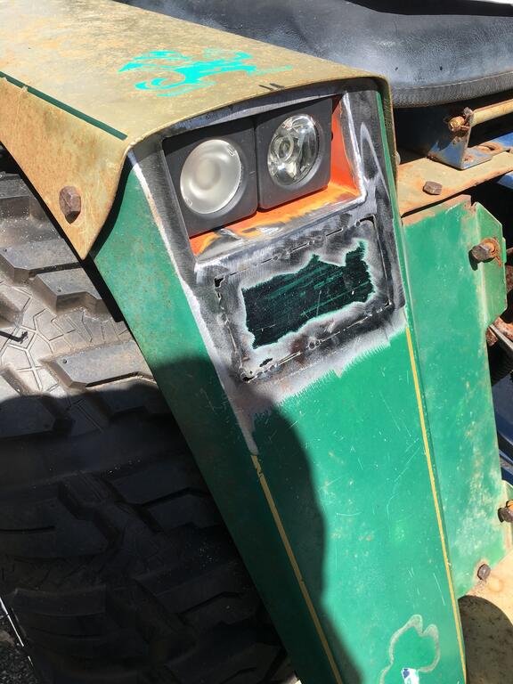

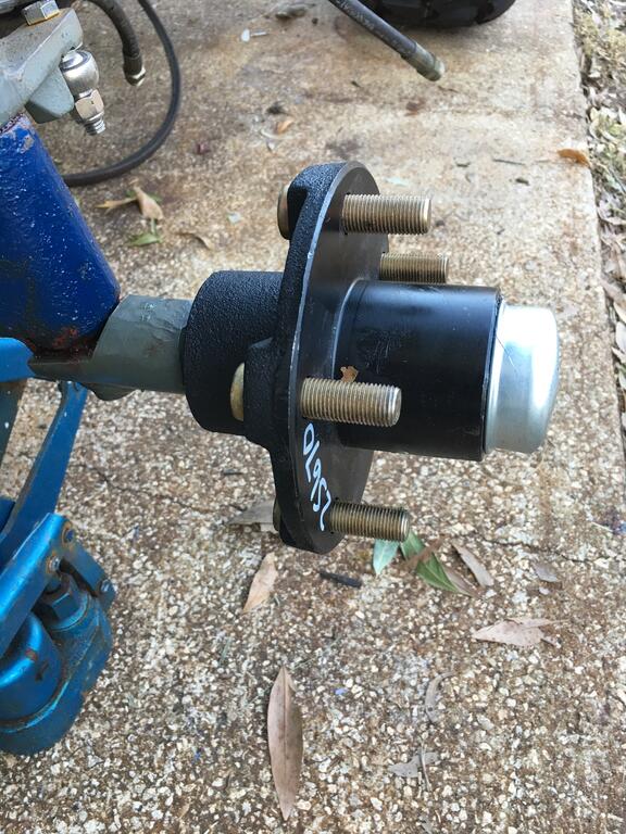

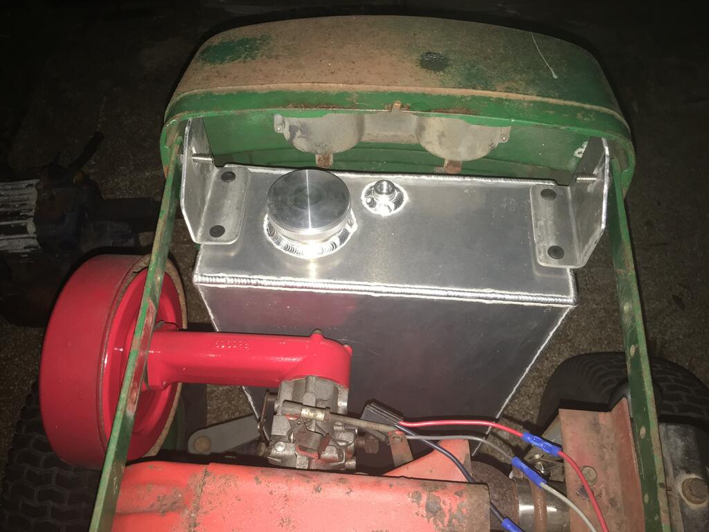

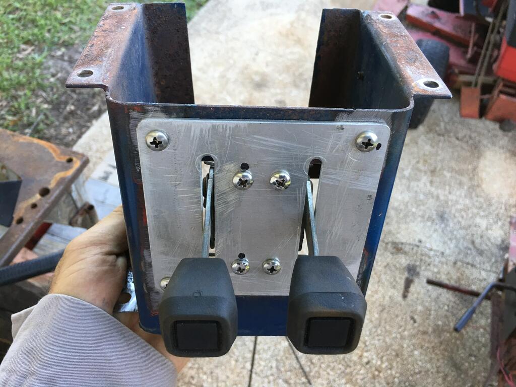

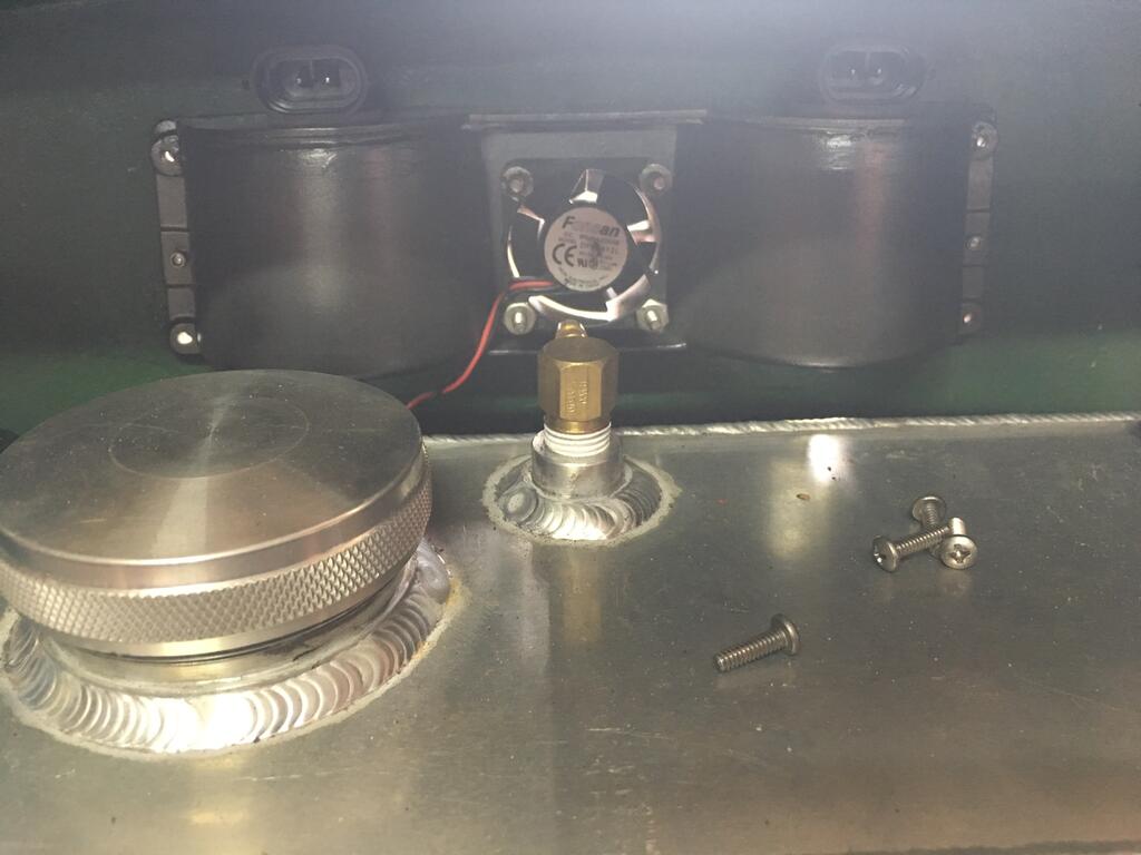

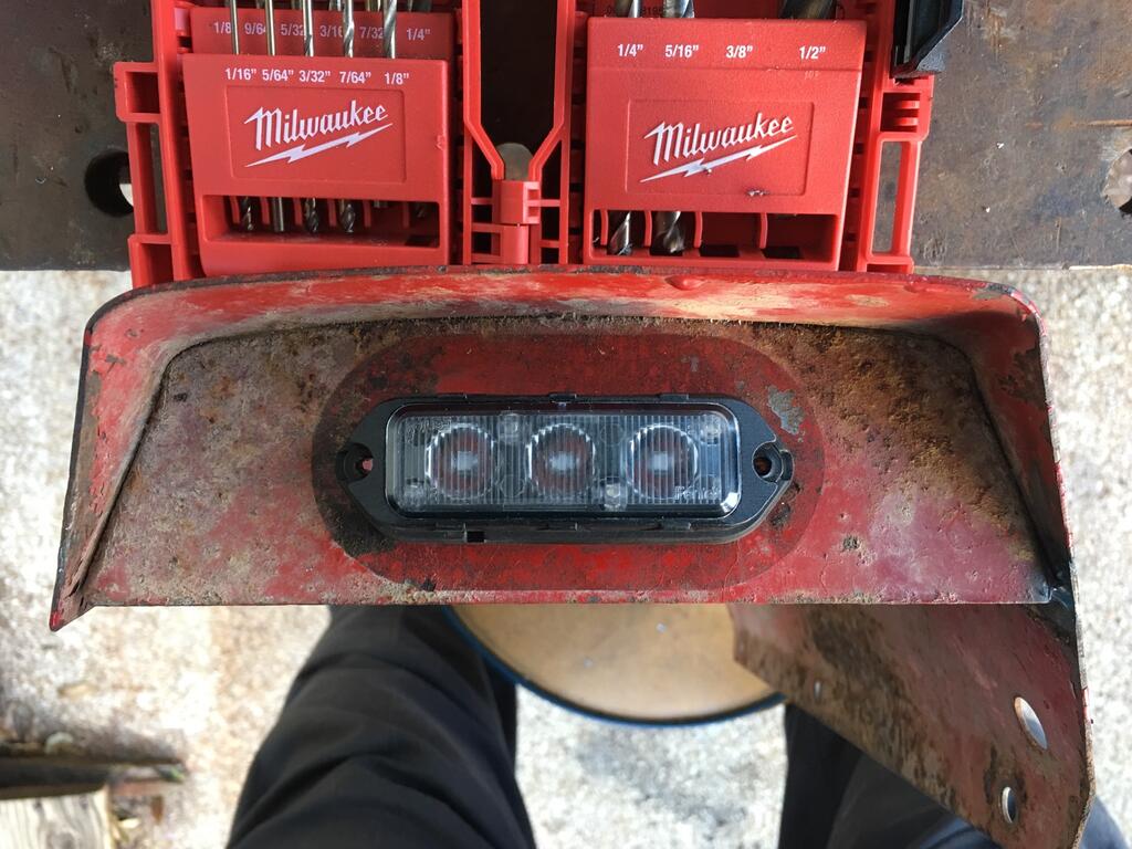

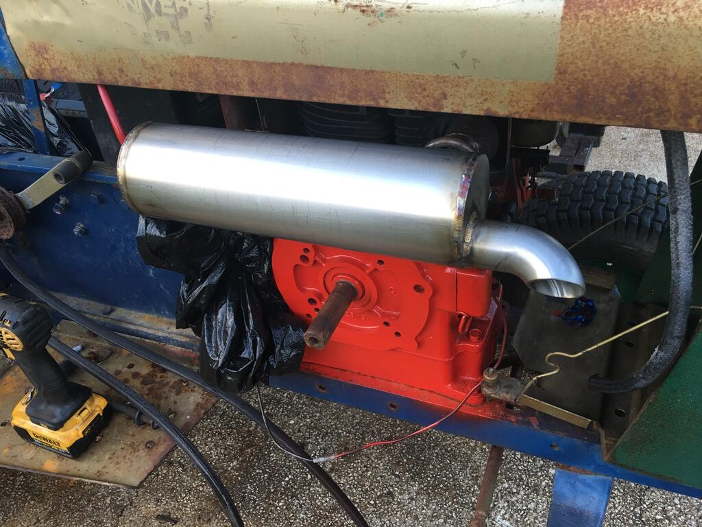

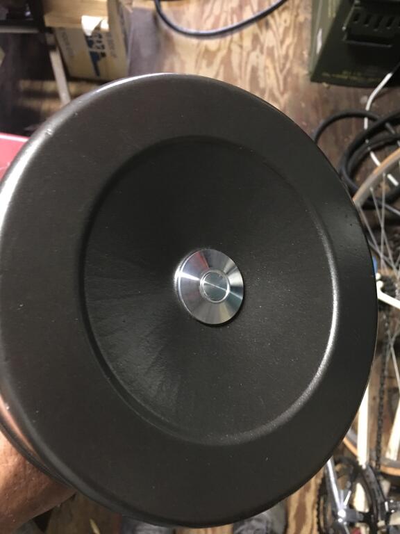

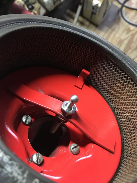

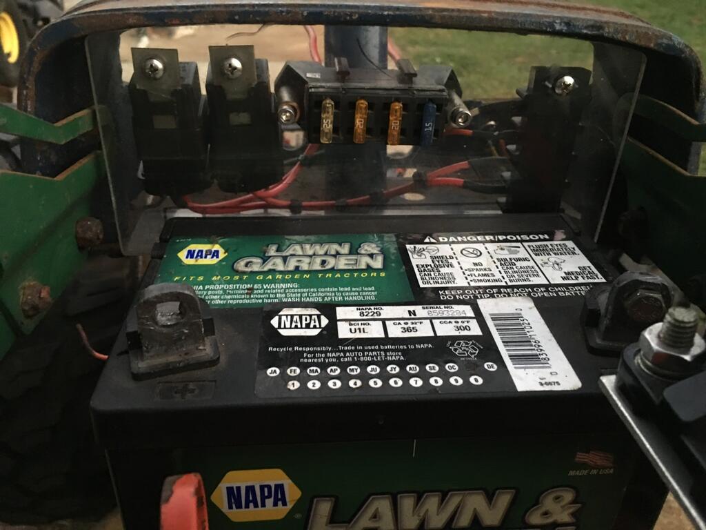

19richie66 17,820 #27 Posted April 3, 2022 fender mounted lights got rid of the pull style throttle/choke cables stainless muffler “firewall” for electrical custom fuel tank led tail lights ”air conditioned” halogen headlamps trailer hub conversion quick release air cleaner latch. I really don’t think there is much stock left anymore on mine. 😂 5 Share this post Link to post Share on other sites

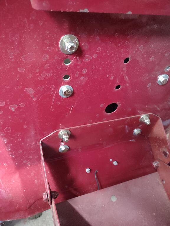

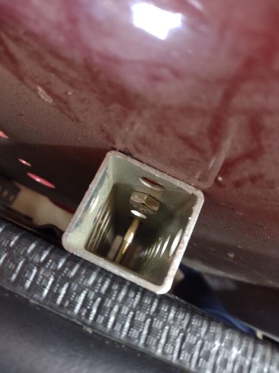

clueless 3,348 #28 Posted April 3, 2022 (edited) 17 hours ago, ebinmaine said: @clueless Here's a couple pics. I used 2 sets of 4 bolts. One set goes down from the middle of the square bars through the seat pan. The other set goes up through the seat pan, bars, and into the seat base. I could have likely used only the second set but I wanted the extra strength. Easy Pezy if you have a flip up seat pan. Edited April 3, 2022 by clueless 1 Share this post Link to post Share on other sites
ebinmaine 77,554 #29 Posted April 3, 2022 26 minutes ago, clueless said: Easy Pezy if you have a flip up seat pan. Absolutely. 😀 I've never disassembled a C series with a bolt down pan so I'm not sure what it would take to make that work.... 1 Share this post Link to post Share on other sites
clueless 3,348 #30 Posted April 3, 2022 4 hours ago, ebinmaine said: Absolutely. 😀 I've never disassembled a C series with a bolt down pan so I'm not sure what it would take to make that work.... just 4 more bolts 2 Share this post Link to post Share on other sites

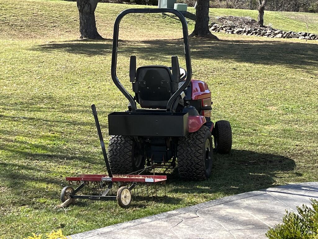

stevebo-(Moderator) 8,604 #31 Posted April 3, 2022 Oem roll bar for the xi series. Added a storage box. Pretty simple but you don’t see rollbars often. 2 Share this post Link to post Share on other sites
Handy Don 16,022 #32 Posted April 3, 2022 40 minutes ago, stevebo said: Oem roll bar for the xi series. Added a storage box. Pretty simple but you don’t see rollbars often. Steve, would you please post a couple pictures of how that ROPS bar attaches--I'm wondering if on could be added to a 520. 2 Share this post Link to post Share on other sites
stevebo-(Moderator) 8,604 #33 Posted April 3, 2022 1 hour ago, Handy Don said: Steve, would you please post a couple pictures of how that ROPS bar attaches--I'm wondering if on could be added to a 520. I don’t have photos however it bolts to the rear end just like the snow plow bracket does. The rops is just a little wider so the plow bracket can be installed at the same time 1 1 Share this post Link to post Share on other sites
