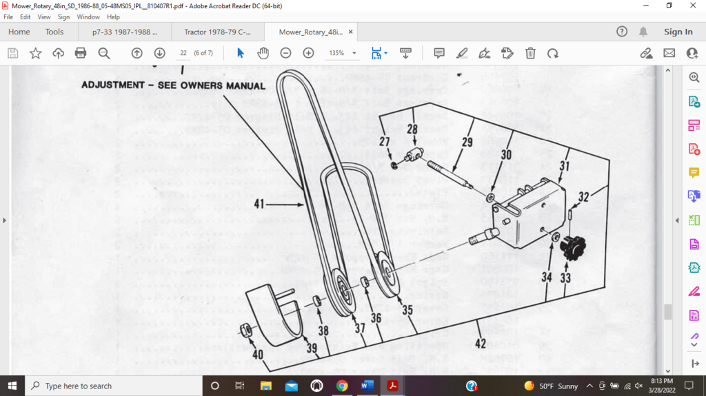

briankd 833 #1 Posted March 28, 2022 anyone have a break down or a picture of the front mule drive? tore mine apart couple years ago there are some spacers and which pulley goes where have a v pulley and flat pully and couple spacers . mine came off my c120 and i'm putting it on my c145 . the pulleys like new still have the part number wrote on them but the brg's was ruff i pulled the seals out and greased them now they like new 1 Share this post Link to post Share on other sites
Handy Don 17,316 #3 Posted March 29, 2022 34 minutes ago, 953 nut said: V pulley closer to tractor U pulley closer to wheel 1 Share this post Link to post Share on other sites
briankd 833 #4 Posted March 29, 2022 43 minutes ago, 953 nut said: 7 minutes ago, Handy Don said: V pulley closer to tractor U pulley closer to wheel thanks guy's 3 Share this post Link to post Share on other sites
roadapples 6,987 #5 Posted March 29, 2022 The 2 spacers are different lengths. Pulleys should be about 1/8" apart... 4 1 1 Share this post Link to post Share on other sites
tunahead72 2,645 #6 Posted March 29, 2022 8 hours ago, roadapples said: ... Pulleys should be about 1/8" apart... That sounds like an excellent way to remember which one goes where (instead of asking here every time I forget). So, does that mean the longer one goes in between the two pulleys? 1 1 Share this post Link to post Share on other sites
squonk 47,887 #7 Posted March 29, 2022 8 minutes ago, tunahead72 said: That sounds like an excellent way to remember which one goes where (instead of asking here every time I forget). So, does that mean the longer one goes in between the two pulleys? Yes. If you mix them up the pulleys will rub together and you'll know right away anyway. 2 1 1 Share this post Link to post Share on other sites
