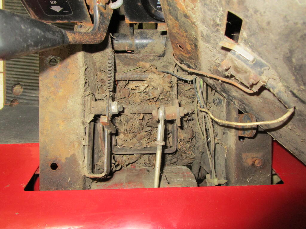

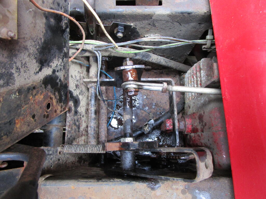

JCM 10,266 #3 Posted March 26, 2022 Prime example of a neglected Hydro linkage in dire need of cleaning and some lubrication in certain places. Pictured is after purchase of a 418, nice and smooth now. 2 1 Share this post Link to post Share on other sites

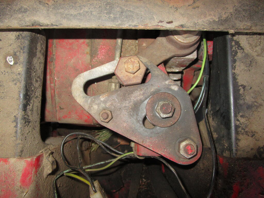

squonk 44,009 #4 Posted March 26, 2022 Look for a groove worn into the surface under the big hexed thingy where the slotted cam rides too. 3 Share this post Link to post Share on other sites

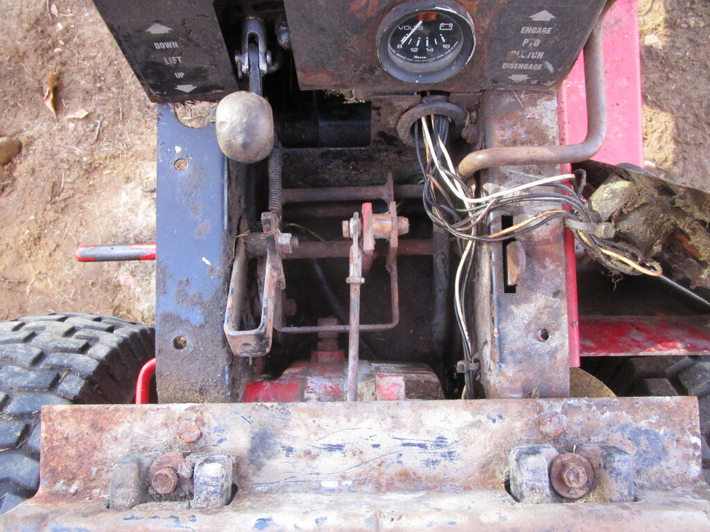

JoeM 8,464 #5 Posted March 26, 2022 35 minutes ago, squonk said: Look for a groove worn into the surface under the big hexed thingy where the slotted cam rides too. And take the cover off below the gage panel and check the slot area that the column shifter reverse/forward pin rides. 3 Share this post Link to post Share on other sites

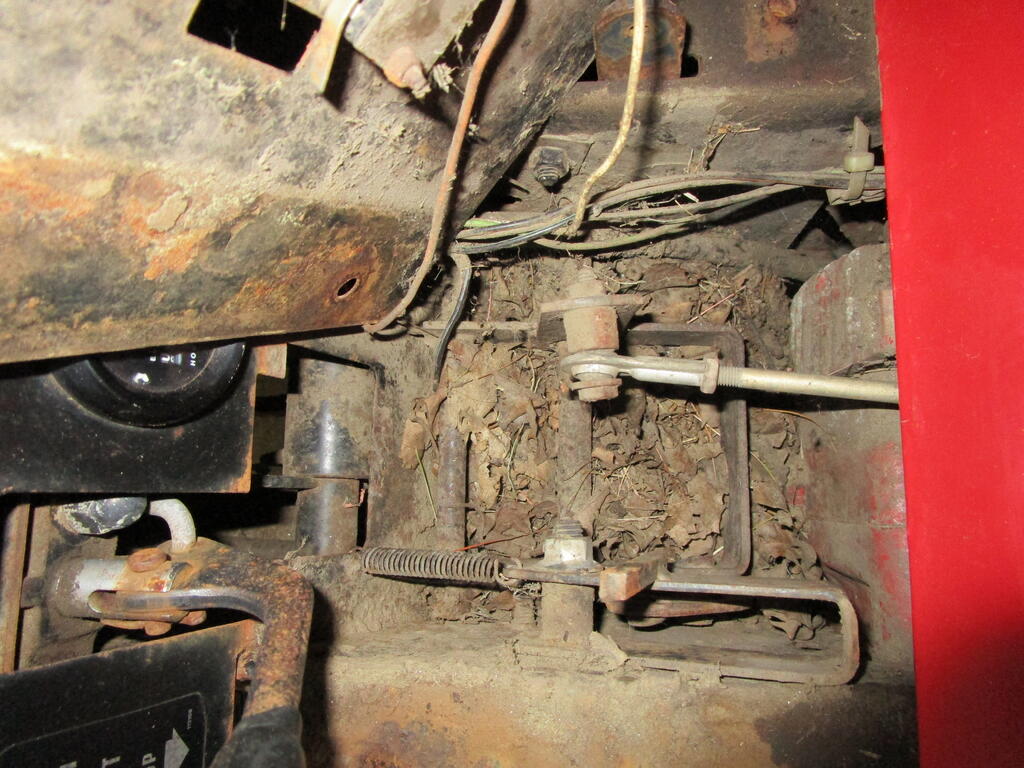

953 nut 60,620 #6 Posted March 26, 2022 Much like @JCM showed you in his photos I was unable to move the direction control very far when I brought home my 418-C. I removed the cover for the tunnel and found an accumulation of nut shells and mouse nests that prevented the lever from moving full range. 3 Share this post Link to post Share on other sites

Brockport Bill 2,004 #8 Posted March 26, 2022 5 hours ago, squonk said: Look for a groove worn into the surface under the big hexed thingy where the slotted cam rides too. yes, under the hex nut the cam plate has a very slight wear pattern -- but very minimal -- but i also looked at the Eaton manual here on RS and actually photos show a slight malformation angle - it is not a straight cut out but has a designed curvature turn to it --- so i assumed the slider opening has a slight "bend" to it but having never seen a new cam i have nothing to compare it to -- so what i am seeing seems within what was the original design for the proper movement --- the manual does talk about an adjustment for "neutral" that i have not tried yet. I thought i'd write here on RS to ask the brainiacs first???????????? Share this post Link to post Share on other sites
Brockport Bill 2,004 #9 Posted March 26, 2022 5 hours ago, JoeM said: And take the cover off below the gage panel and check the slot area that the column shifter reverse/forward pin rides. i have not yet removed the guage panel plate to check the steering tranny shift column lever so i will check that for any wear or needed lube -- thats a good point -- thanks Share this post Link to post Share on other sites
