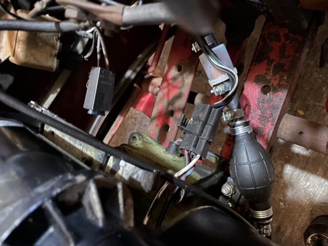

AHS 1,642 #1 Posted March 25, 2022 I stuck the M16 into the chassis of an 88 310. So the 310 didn’t have a voltage regulator and the M16 did. A Magnum motor will have the 5 plug that plugs in right out of the motor to the chassis….. are any of these voltage regulated or are they all the same? Can someone give me a pin out of the 5 terminals, please? Share this post Link to post Share on other sites

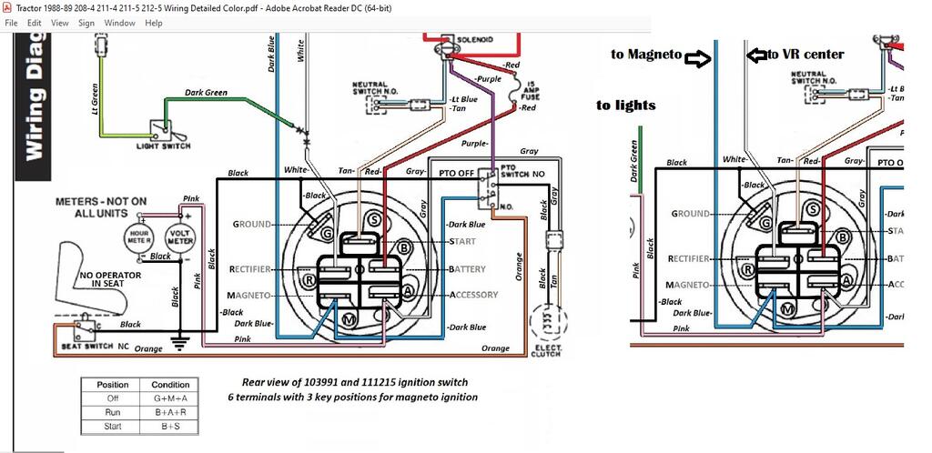

953 nut 64,647 #2 Posted March 26, 2022 If your engine is from a Wheel Horse and spec # is 711523 I think it should be plug and play as far as the wiring goes with the exception of the charging system. In the drawing below (310 on left and 316 on right) I have moved the Green lighting wire down to join the hour meter and volt meter. Also your white wire that had joined the green wire now should go directly to the "R" terminal on the ignition switch. Those two changes should be all that is needed 2 Share this post Link to post Share on other sites

953 nut 64,647 #4 Posted March 26, 2022 6 minutes ago, clueless said: Not sure what your asking, is the m16 from a wheel horse? Both my WH magnums have only two wires coming from the engine a violet color one from the regulator and a white from the coil. Should be two wires from the oil sentry switch to its relay. The connector is a five pin but only four are used. The colors change at the plug not too sure why they had to do that to us. The 310 may or may not have the oil sentry depending on the year. 2 Share this post Link to post Share on other sites
AHS 1,642 #5 Posted March 26, 2022 @953 nut It does have the oil sentry switch, so that’s two wires out the 4. It has the volt meter and it worked, (right up to 12V). The only thing when I turn the key to ‘start’ the oil light comes on, and it doesn’t start. Is that normal for the oil light to come on? Share this post Link to post Share on other sites

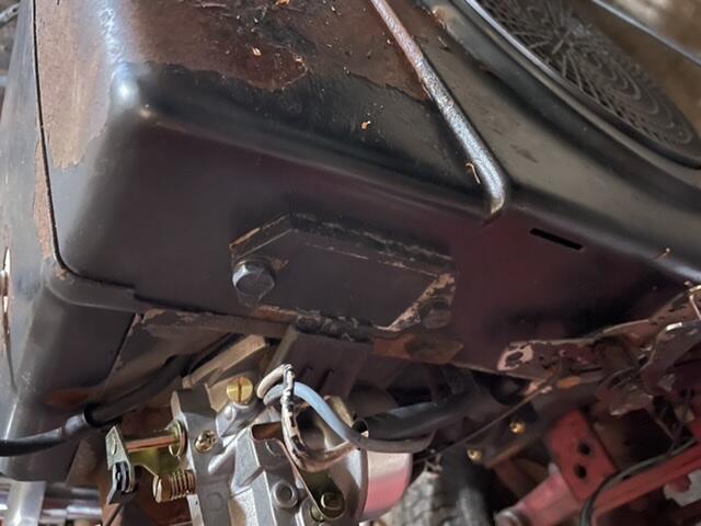

AHS 1,642 #7 Posted March 27, 2022 On 3/25/2022 at 8:16 PM, 953 nut said: Should be two wires from the oil sentry switch to its relay. The connector is a five pin but only four are used. The colors change at the plug not too sure why they had to do that to us. The 310 may or may not have the oil sentry depending on the year. Two wires are the oil sentry. One wire is the coil pack. The other wire goes into the engine somewheres. Ok, I’m thinking it may be a the clutch switch, or the PTO. Share this post Link to post Share on other sites
953 nut 64,647 #8 Posted March 27, 2022 The white wire going into the engine shroud on the M-10 would be your electrical feed for lights and charging. On the M-16 the same white wire will come from the voltage regulator, go behind the flywheel shroud and on to the five pin connector. The PTO wiring is part of the chassis wiring and doesn't enter the engine. Share this post Link to post Share on other sites
