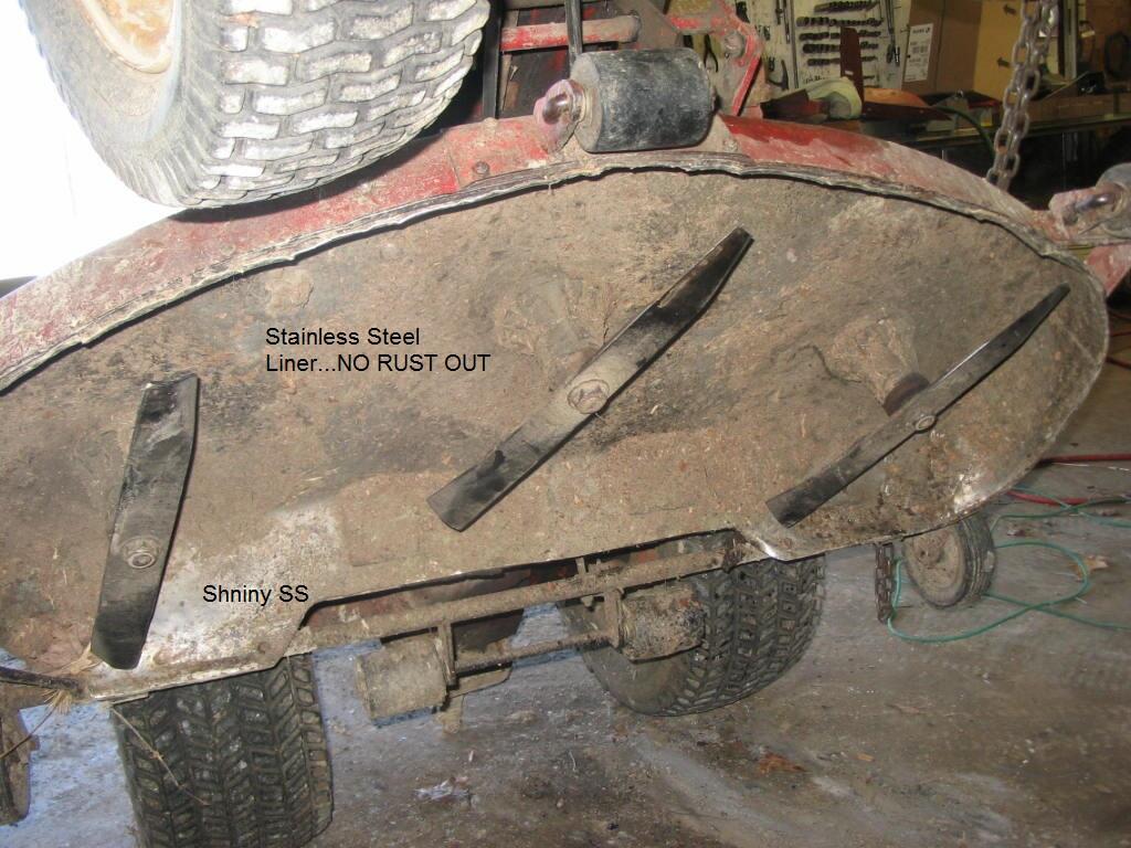

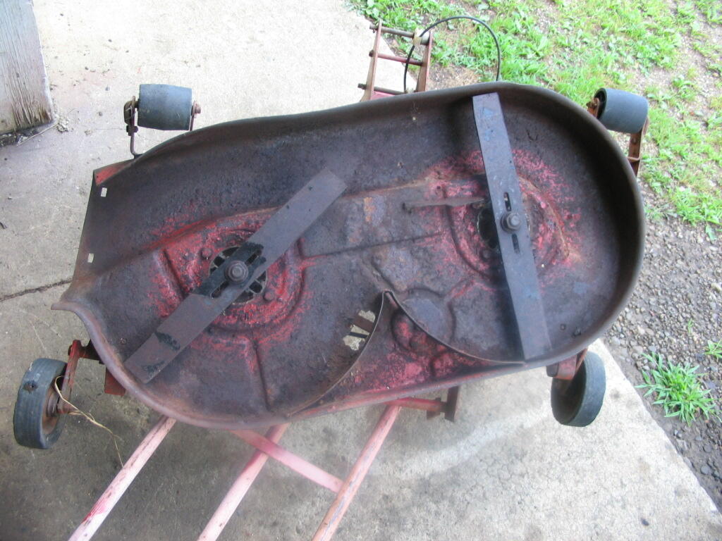

daveoman1966 3,884 #2 Posted March 24, 2022 (edited) For a permanent life-time fix, make a Stainless Steel liner for the underside of the deck. (1) remove ALL hardware and spindles (2) use a piece of cardboard to make a template of the bottom side...holes too. (3)Lay that template on a SS sheet..mark sheet...cut it out...bolt it in. You MAY even want to drill some extra mounting holes...not sure. I did this to my 48" deck back in the early 90s (PIC HERE) and..to this day...NO RUST at all. Here is a 37" deck I have... Edited March 24, 2022 by daveoman1966 5 Share this post Link to post Share on other sites

daveoman1966 3,884 #11 Posted March 25, 2022 4 hours ago, JoeM said: what gauge is the stainless sheet? It's been too many years so I don't recall.. It is about the same thickness of your credit card.... 1 Share this post Link to post Share on other sites

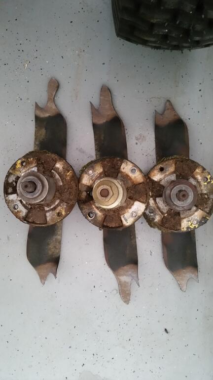

Racinbob 13,110 #13 Posted March 26, 2022 Sandy soil is about as tough on the blades as anything. These came off the junk deere I gave our son in law a few years ago while we were still living down there. 1 Share this post Link to post Share on other sites
peter lena 10,013 #14 Posted March 26, 2022 @Racinbob those blade / spindles are just about as bad as it gets . maybe change over to a flail mower , or a blow torch , only kidding , pete 1 Share this post Link to post Share on other sites
JoeM 10,155 #15 Posted March 26, 2022 now that is getting your money's worth! Share this post Link to post Share on other sites
