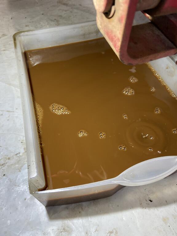

Fishroe 261 #1 Posted March 22, 2022 (edited) Recently purchased 414-8 Been sitting outside for who knows how long i thought the axle seal was leaking Oily film/dirt all over the inside of the wheel and hub Took the wheel and hub off cleaned everything up drove it around for about 10 minutes and inspected the seal and it is dry as a bone so I drained it and we’ll go from there luckily no left or right play no up and down play on the axle shaft maybe a 16th of an inch in and out Edited March 22, 2022 by Fishroe 2 3 Share this post Link to post Share on other sites
SylvanLakeWH 29,540 #2 Posted March 22, 2022 That’s not uncommon for a trans that got water in it… is the shift boot shot? If yes I’d replace it to keep water out… Also when you drained it did you raise the front end up? Helps get all the oil out… Id run it around for a few and then drain again… get the crap out… 4 Share this post Link to post Share on other sites

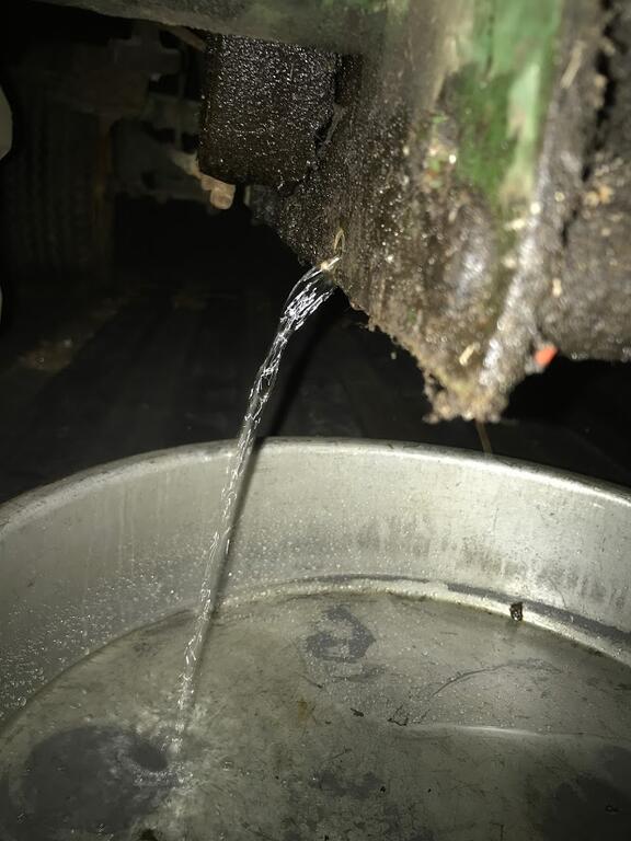

oliver2-44 11,028 #3 Posted March 22, 2022 (edited) Fill it with diesel and drive it around in all gears for awhile to flush it out. Then drain and refill with gear oil. At least you had milky oil. When you pull the plug on one and only get clear water you really cringe. Edited March 22, 2022 by oliver2-44 5 1 Share this post Link to post Share on other sites

Fishroe 261 #5 Posted March 22, 2022 Replaced the boot a couple days ago yes it’s jacked up in the front as far as the floor jack will go Diesel fuel won’t hurt it??? I have some left over when I had a jd 455 kinda wish I hadn’t sold it but it was taking up too much space i didn’t have a garage built then. I do now 4 Share this post Link to post Share on other sites

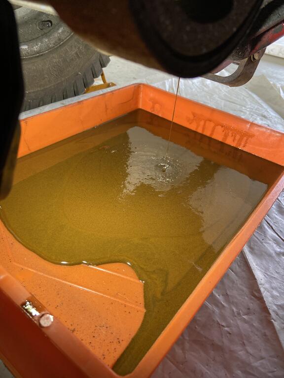

Fishroe 261 #14 Posted March 22, 2022 I’ll be out all night if I wait for that this is Boring riding around doing nothing damn I thought the hour meter was working but it is not 1 Share this post Link to post Share on other sites
Fishroe 261 #15 Posted March 22, 2022 (edited) I guess I should do it again? pretty much the same color just thinner is that rust coming out of there Edited March 22, 2022 by Fishroe Share this post Link to post Share on other sites

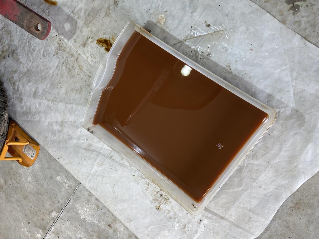

JoeM 9,072 #21 Posted March 23, 2022 10 hours ago, OutdoorEnvy said: I’ve often thought about using marine gear oil as it is supposed to prevent and help rust issues. Not necessary, but it's your money. Quality gear oils have emulsifiers and anti rust additives. Those oils will suspend the water and still lubricate within reason. 1 percent was the threshold for me on oil change outs during my career. Of course we sampled routinely. The quantity of water in your oil drain is well above that level. As Pete was saying prevention is the solution. Limit the areas the water can enter and checking on a frequent basis is the best. As with your story, and most of us here, we inherit the problem from a careless owner. And voila.....rusty watery oil=more work. The after pic of that case after some TLC. 3 5 Share this post Link to post Share on other sites
Fishroe 261 #22 Posted March 23, 2022 (edited) with your story, and most of us here, we inherit theproblem from a careless owner. And voila.....rusty wateryoil=more work. That’s a big 10 four Second and final flush I believe I spent $10 in gas riding around for an hour non-ethanol is $5.33 a gallon in my neck of the woods Edited March 23, 2022 by Fishroe Share this post Link to post Share on other sites
Handy Don 14,887 #23 Posted March 23, 2022 1 hour ago, Fishroe said: with your story, and most of us here, we inherit theproblem from a careless owner. And voila.....rusty wateryoil=more work. That’s a big 10 four Second and final flush I believe I spent $10 in gas riding around for an hour non-ethanol is $5.33 a gallon in my neck of the woods Back to @stevasaurus' comment -- that doesn't look flushed enough to me. Another reason I'm on the fence about flushing is that I don't have a safe way to dispose of the diesel. Plain oil any service station must accept, but if it's contaminated with gas or diesel, they can refuse it. 1 Share this post Link to post Share on other sites
stevasaurus 23,493 #24 Posted March 23, 2022 I think, at the very least, I would pull the shifter and shine a light down the hole. You might get a good idea what it looks like inside. Maybe stick a screwdriver down the hole and scrape the bottom and see what's there. 1 Share this post Link to post Share on other sites
Fishroe 261 #25 Posted March 23, 2022 2 hours ago, Handy Don said: Back to @stevasaurus' comment -- that doesn't look flushed enough to me. Another reason I'm on the fence about flushing is that I don't have a safe way to dispose of the diesel. Plain oil any service station must accept, but if it's contaminated with gas or diesel, they can refuse it. Yea I knew somebody would say that, and it probably could’ve used another flush. I’ve put oil back in now. I’ll get a few hours on it and change oil. Gotta be better than it was. Wasn’t having any trans problems before flushing but I’m sure they were on the way, the way that oil looked. 3 Share this post Link to post Share on other sites
