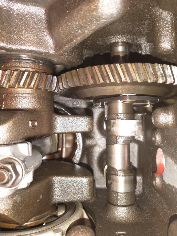

squonk 47,888 #13 Posted March 20, 2022 (edited) @redsquarebob I got this k341 at around 700 hrs. It was neglected. Oil like tar and it smoked. I put in Rotella 30W and ran it for 10 years. First couple of oil changes the oil came out like crude. 2 years ago at 1000 hrs. I finally had to tear it down as the balance gears were rattling. This is a picture of inside the engine when I pulled the pan. I didn't clean a thing. Edited March 20, 2022 by squonk 11 5 1 Share this post Link to post Share on other sites

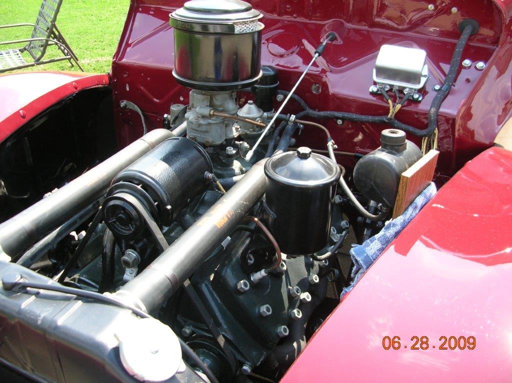

richmondred01 2,388 #25 Posted March 23, 2022 Discussing oil is like discussing politics, religion and sports teams. Personally use rotella 30 in all my k and Magum engines. I also use it in my flathead Ford engine. I change the oil every 20 hours in the old Kohlers and once a year or 3000 mile, in the 40 Ford. (However, I have never put 3000 miles on the 40 in one year it works out to be about 300 miles). 1 Share this post Link to post Share on other sites
