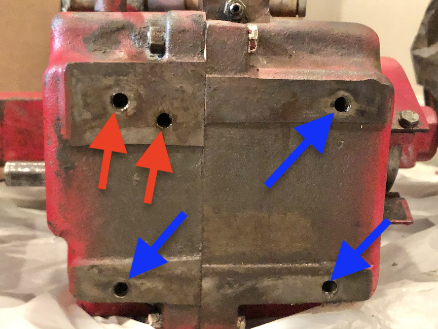

Handy Don 14,633 #13 Posted March 16, 2022 Back with another question @stevasaurus, @ebinmaine gave me a "heads up" that holes at the front of the transmission might let oil spill out (I was about to transport a 5025). I didn't get any leakage but forgot to probe the holes before letting it go. It had four mounting holes. The 5060 that I just brought home, though, has five holes in the front (oil drained before transport). Three are "blind" (blue arrows), and two are "through" into the interior of the trans (red arrows)--one is a mounting hole but I don't have any idea what the other one is. Maybe something related to the Hi-Lo shifter and needing access during assembly/disassembly Can you shed light on this, please? Also, should I be doing anything in particular to either or both of those "red" holes when mounting this thing to the tractor? Thanks! Share this post Link to post Share on other sites
pfrederi 18,968 #14 Posted March 16, 2022 Small red arrow hole should have a plug in it. (or at least a bit of RTV sealant. It is access to shift rail balls... 1 1 Share this post Link to post Share on other sites
stevasaurus 23,454 #15 Posted March 16, 2022 That is were you build your détente ball mechanism...1/4" hole. In the long run you just need to put a finger of grease or a dollop of silicone in that hole. No need to put in a plug. Some of those other holes are blind holes, and if you have some that are not, you want to beware of putting in too long of a bolt. Look into the schematic and see how long these bolts are supposed to be...do not go past that...you may be poking into places with turning gears. 2 1 Share this post Link to post Share on other sites
Handy Don 14,633 #16 Posted March 16, 2022 1 hour ago, stevasaurus said: That is were you build your détente ball mechanism...1/4" hole. In the long run you just need to put a finger of grease or a dollop of silicone in that hole. No need to put in a plug. Some of those other holes are blind holes, and if you have some that are not, you want to beware of putting in too long of a bolt. Look into the schematic and see how long these bolts are supposed to be...do not go past that...you may be poking into places with turning gears. Excellent. Thank you. I already planned for new bolts based on the bolt lengths in the IPL so good there. The dollop of oil-resistant silicone will be easy too. 1 Share this post Link to post Share on other sites
