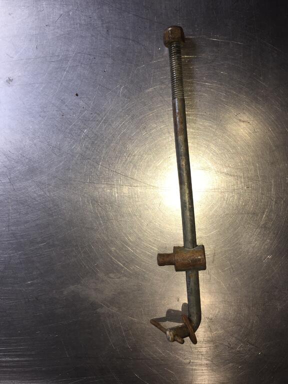

JimSraj 576 #5 Posted March 14, 2022 I’m pretty sure that I have one. If you’re still interested let me know and I’ll look for it. 1 Share this post Link to post Share on other sites
roadapples 6,987 #6 Posted March 14, 2022 I was thinking about the adjustment rod on the rear of the deck... Share this post Link to post Share on other sites
JimSraj 576 #7 Posted March 14, 2022 Is this what you’re looking for? 2 Share this post Link to post Share on other sites
thehorse 221 #8 Posted March 14, 2022 That’s the part Jim. I may look into the chain. Lee…did 5 links seem to be the ticket? Share this post Link to post Share on other sites
gwest_ca-(File Mod) 12,257 #9 Posted March 15, 2022 I believe it was originally 3/8" and changed to 1/2" but do not know when that happened. Think it is this one 1 Share this post Link to post Share on other sites
Lee1977 7,638 #10 Posted March 15, 2022 6 hours ago, thehorse said: That’s the part Jim. I may look into the chain. Lee…did 5 links seem to be the ticket? It's close but never found a chain that worked for a full lift as it's non adjustable. The newer Wheel Horse Decks has eye bolt with trunnion and chain that adjustable. I changed to that because mine would get bent and hang up when trying to lift the deck, the chain took care of that. 1 Share this post Link to post Share on other sites
JimSraj 576 #11 Posted March 15, 2022 Yup, the rod in the picture is 3/8”x9” from the bend. I also have a 5/16”x8” or so. I don’t remember the exact length. It may have been a replacement that someone just made from what was on hand. There’s one of the 3/8” type on the 48” decks of both my GT14 and 1967 Lawn & Garden T1267. I try to keep them lightly greased and haven’t had trouble with them. Share this post Link to post Share on other sites
