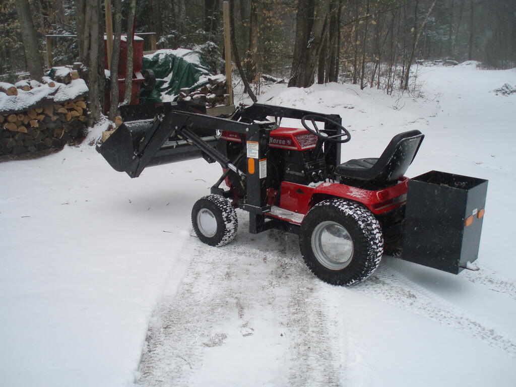

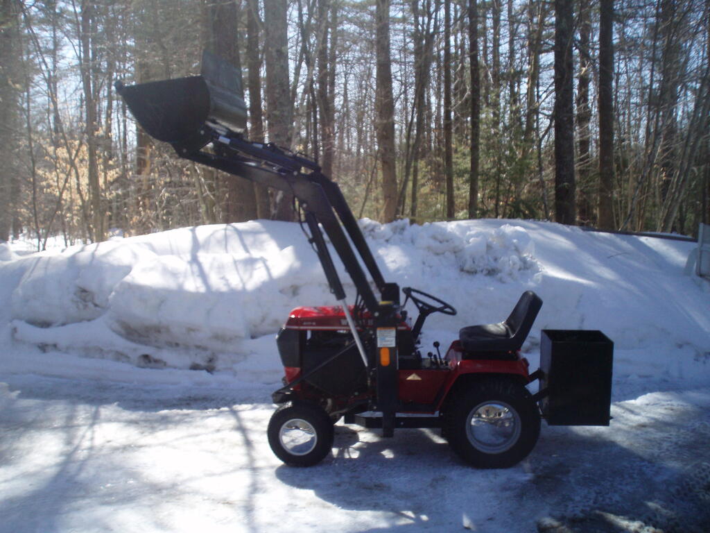

JCM 11,419 #2 Posted March 6, 2022 Kwik-Way is the only one I am familiar with. Had this mounted on 3 WH tractors but really felt the most comfortable with it on the 520 because of the easier steering. Very handy attachment. @roadapples Has a nice set up on a C-160 2 1 Share this post Link to post Share on other sites

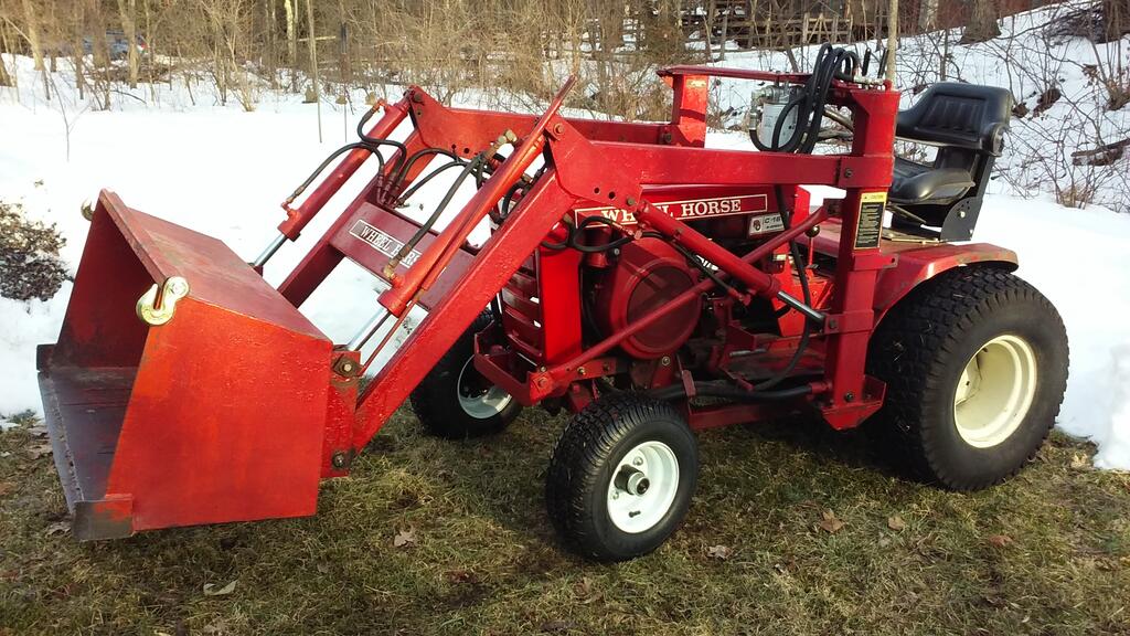

roadapples 6,987 #3 Posted March 7, 2022 (edited) Mine is a 550 Ark on a 74 C160, but I did add 520 steering and swept axle. If you find one reasonable, buy it. If you ever find one you like better, you'll have no trouble selling the first one.... Edited March 7, 2022 by roadapples 1 3 Share this post Link to post Share on other sites

mrc 1,119 #6 Posted March 8, 2022 I've had a kwikway loader like JCM's. it was a real backsaver for many projects around my home. overall a well built loader. the cutting edge on the bucket is welded on. so you have to watch for wear as it is not a bolt on cutting edge. i never wore my cutting edge out, i used it a lot and it was used when i bought it. all the pivot points are pins thru the arms etc.etc. no grease zerks. I never wallowed out the holes even with hard use. no hooks on the bucket to suspend something heavy you are 'chaining up' to lift. easy enough to fab though. no filter for the hydraulics, easy enough to add one. the rear counter weight box should have a slightly angled bottom so when you are trying to pile up material it does not hit the ground. i also had something like the ark loader on roadapples tractor. that loader too was good overall. be mindful that if you build your own that the welds must be top notch because you can get seriously hurt if something breaks. for instance you are loading material into your truck and something breaks. the whole rig and yourself go toppling over. not to mention damaging your truck. it is incredible how much weight is in that bucket up over head height should something let go. please remember as well that this is not a piece of construction equipment. it is a handy time and labor saving attachment for the average homeowner. sure beats wheelbarrow and shovel!!! you should also check your front tires and make sure they are at least 4 ply. 6 ply is better and run with lots of air pressure to make the steering easier. regards mike in mass. 2 1 Share this post Link to post Share on other sites
