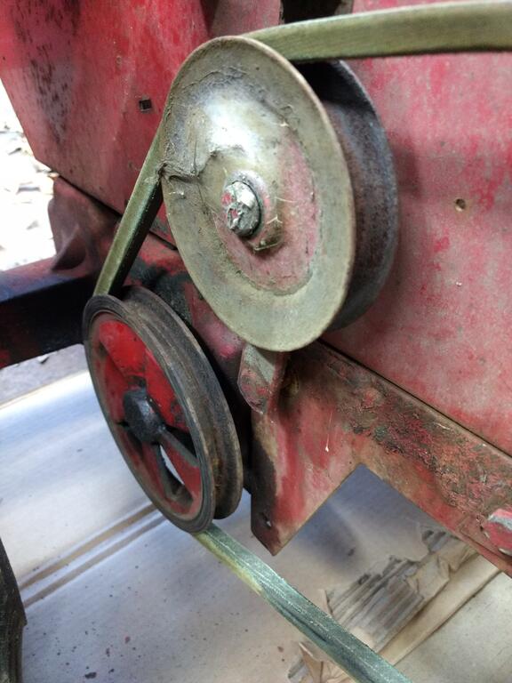

RedWheelz 149 #28 Posted March 6, 2022 Pulleys were a bit rusty. Got them cleaned up and it didn't make much difference. If I decide to sell it I'll probably sell as is so not sure if I wanna buy new belt or mess with it more. 1 Share this post Link to post Share on other sites
ebinmaine 79,660 #29 Posted March 6, 2022 2 minutes ago, RedWheelz said: Pulleys were a bit rusty. Got them cleaned up and it didn't make much difference. If I decide to sell it I'll probably sell as is so not sure if I wanna buy new belt or mess with it more. These pulleys are VERY rusty. The idler could be replaced. The transmission pulley can likely be shined up. I'd say that's been setting outside or on a dirt floor unused quite some time. 1 Share this post Link to post Share on other sites
RedWheelz 149 #30 Posted March 6, 2022 Yep, it was outside. Not a big fan of outdoor, uncovered storage! All my tractors and equipment are inside, if not, they r covered. I used a flap disk and that got them to bare metal. 2 Share this post Link to post Share on other sites

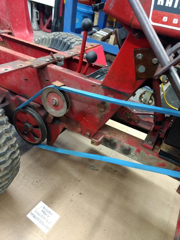

RedWheelz 149 #31 Posted March 12, 2022 I put a new belt on now the idler pullry guard rubs the belt. Is that little guard suppose to be adjustable or welded to the idler pulley arm? This one is welded. 1 1 Share this post Link to post Share on other sites
wallfish 20,219 #32 Posted March 12, 2022 (edited) Is that new belt the right length? It looks short to me from the pic. A proper length belt will allow that idler pulley to go back farther which will relieve that guard from contacting the belt A stronger spring on the other side to pull that pulley back more may solve the problem. If you can push it back by hand so it doesn't touch the belt then a stronger spring might do it. If you can't push it enough then a longer belt is the answer Edited March 12, 2022 by wallfish 1 Share this post Link to post Share on other sites

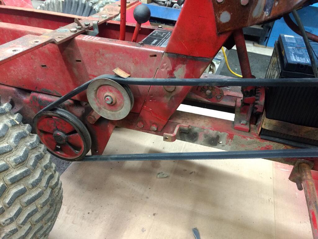

wallfish 20,219 #33 Posted March 12, 2022 (edited) Notice how vertical the idler arm for the pulley is in this pic below. Not as much in the recent pic Edited March 12, 2022 by wallfish 1 Share this post Link to post Share on other sites
Horse Newbie 7,405 #34 Posted March 12, 2022 I was thinking that belt “guard” is supposed to fully stop the belt when you push in the clutch … 1 Share this post Link to post Share on other sites
Ed Kennell 46,557 #35 Posted March 12, 2022 24 minutes ago, Horse Newbie said: I was thinking that belt “guard” is supposed to fully stop the belt when you push in the clutch … Yes, the belt guard supports the bottom loop of the slack belt and helps to stop it from contacting the engine pulley. If properly adjusted, that tab on the tensioner pulley will pinch and also help to stop the belt. It appears your belt is too short....It should not be rubbing the belt when the clutch is engaged. 1 Share this post Link to post Share on other sites
RedWheelz 149 #36 Posted March 12, 2022 The belt is 5/8 x 82" which I thought was the correct belt 1 Share this post Link to post Share on other sites
Ed Kennell 46,557 #37 Posted March 12, 2022 2 minutes ago, RedWheelz said: The belt is 5/8 x 82" which I thought was the correct belt That belt would probably be OK, but the tab must be adjusted so it only touches the belt when the clutch is depressed. 1 1 Share this post Link to post Share on other sites

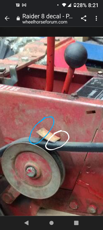

ebinmaine 79,660 #39 Posted March 13, 2022 Judging by the curve (white circle) on that side of the tab, it looks as if it's been that way for a bit. We've had Horses like this here and had to bend/adjust/correct the issue. I do agree with the above post(s) about the possibility of the belt being too short. 1 Share this post Link to post Share on other sites

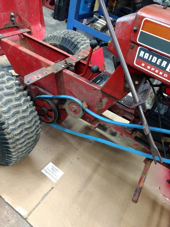

RedWheelz 149 #45 Posted March 14, 2022 Is the guard hitting to much when the clutch pedal is pressed? 1 Share this post Link to post Share on other sites
Ed Kennell 46,557 #46 Posted March 14, 2022 5 minutes ago, RedWheelz said: Is the guard hitting to much when the clutch pedal is pressed? No, that looks good. The belt should stop if the belt guard is in place. 2 Share this post Link to post Share on other sites
