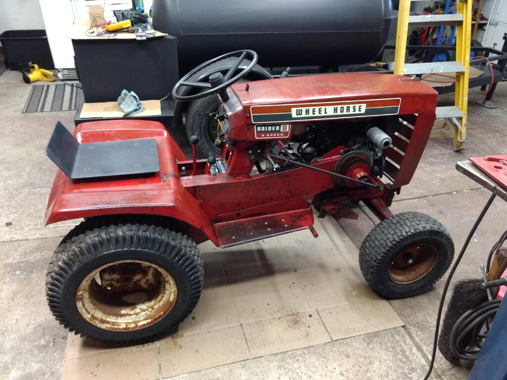

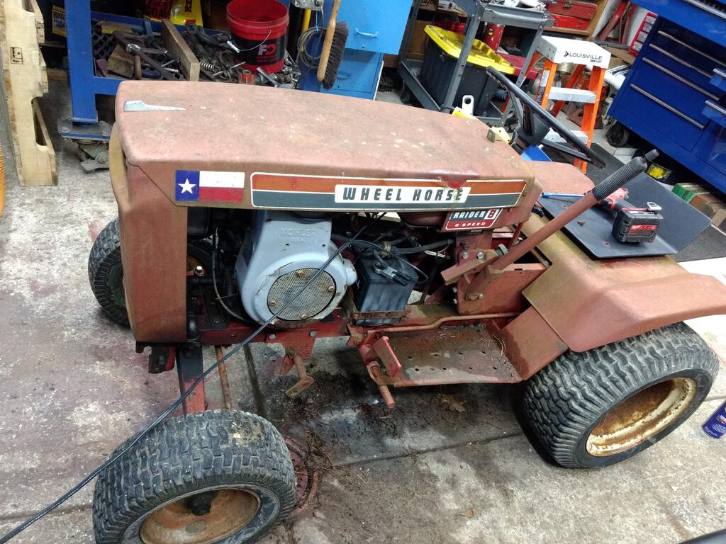

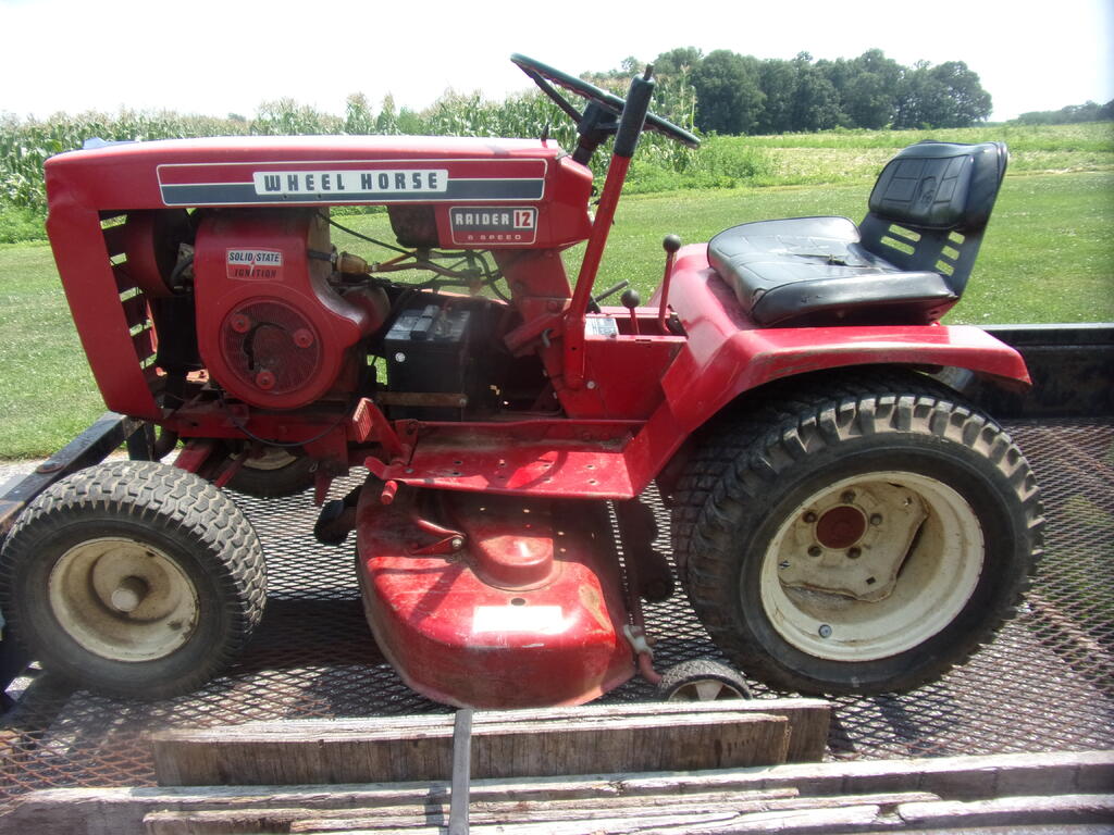

RedWheelz 149 #1 Posted March 2, 2022 Just got this Raider 8 and was wondering if the red, white and blue decal is original. Seems like I have seen it on other Wheel Horse photos but maybe not... 3 Share this post Link to post Share on other sites
ebinmaine 79,660 #2 Posted March 2, 2022 That's an interesting Beast I haven't seen very many of. I don't think that red white and blue decal is original to Wheel Horse but I don't claim to be an authority. That engine is probably also a replacement considering it's the wrong color. What's the plan for it? 2 Share this post Link to post Share on other sites
Ed Kennell 46,557 #3 Posted March 2, 2022 Not wheel horse. That is the Texas flag. 7 1 Share this post Link to post Share on other sites
SylvanLakeWH 31,715 #4 Posted March 2, 2022 But the Wheel Horse decals all look correct… 2 Share this post Link to post Share on other sites

RedWheelz 149 #6 Posted March 3, 2022 7 hours ago, ebinmaine said: That's an interesting Beast I haven't seen very many of. I don't think that red white and blue decal is original to Wheel Horse but I don't claim to be an authority. That engine is probably also a replacement considering it's the wrong color. What's the plan for it? Im cleaning up all the hacks and cobblefication on it. Get new electric fuel pump, muffler, battery. Scrub it with brillo pads and put some boiled linseed oil on it. Just want a little zoom-around rig. 2 Share this post Link to post Share on other sites
ebinmaine 79,660 #7 Posted March 3, 2022 3 hours ago, RedWheelz said: Im cleaning up all the hacks and cobblefication on it. Excellent plan and another great word usage. 3 hours ago, RedWheelz said: Just want a little zoom-around rig. Those Kohler 8 HP engines are great workers. It'll be a good little driver and if you want to get some grunt work out of it you'd be pleasantly surprised what it'll do. Please do feel free to post progress pics.... 2 Share this post Link to post Share on other sites

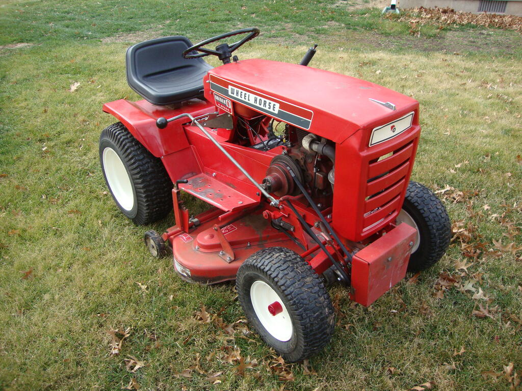

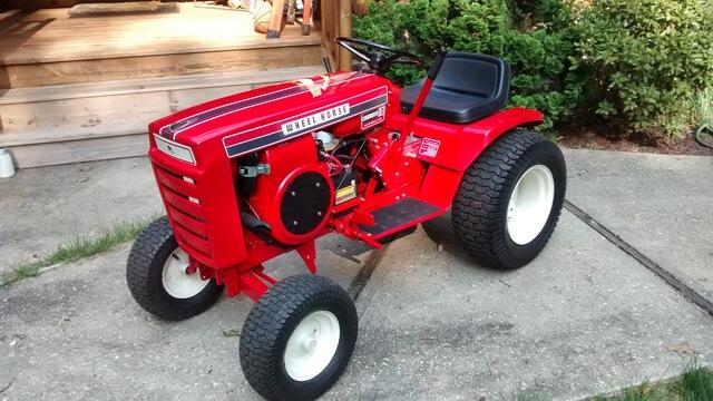

dclarke 4,270 #10 Posted March 3, 2022 Here's a Raider 8 with original decals that I rebuilt a few years ago, I added the different seat and springs. They're great little tractors. 5 Share this post Link to post Share on other sites

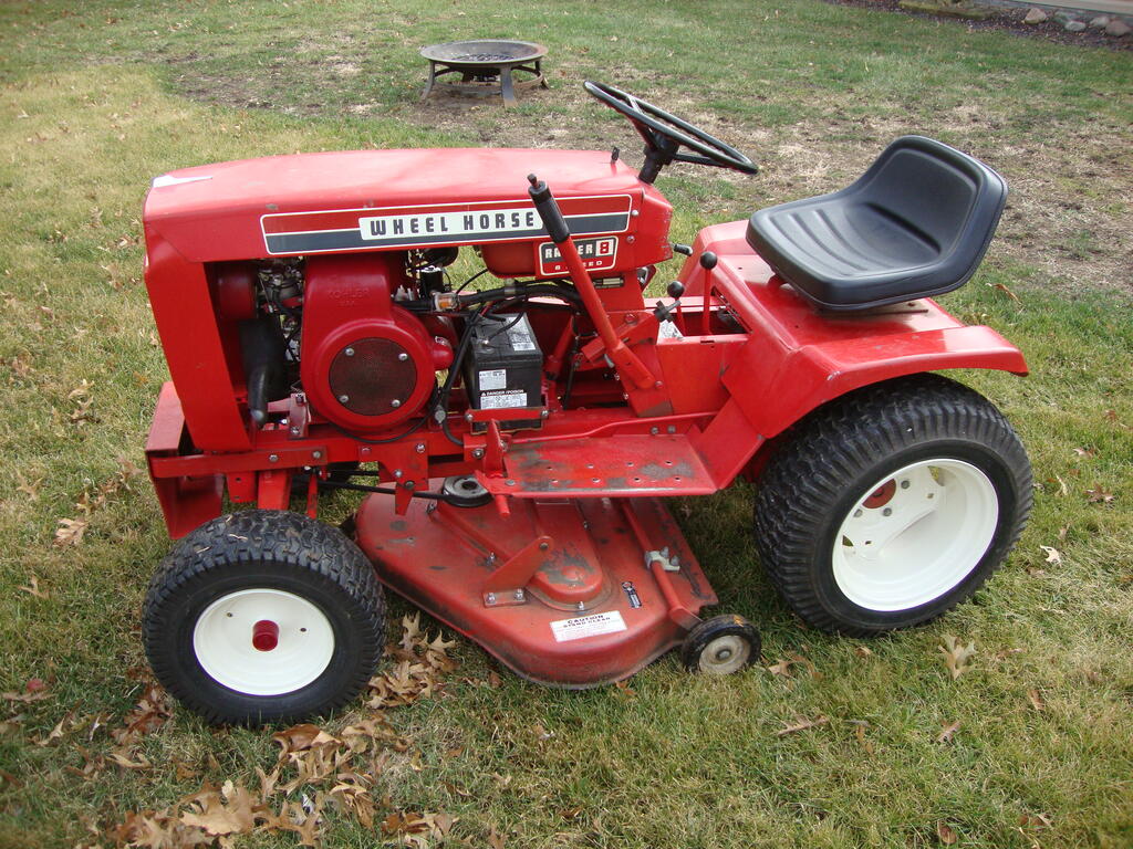

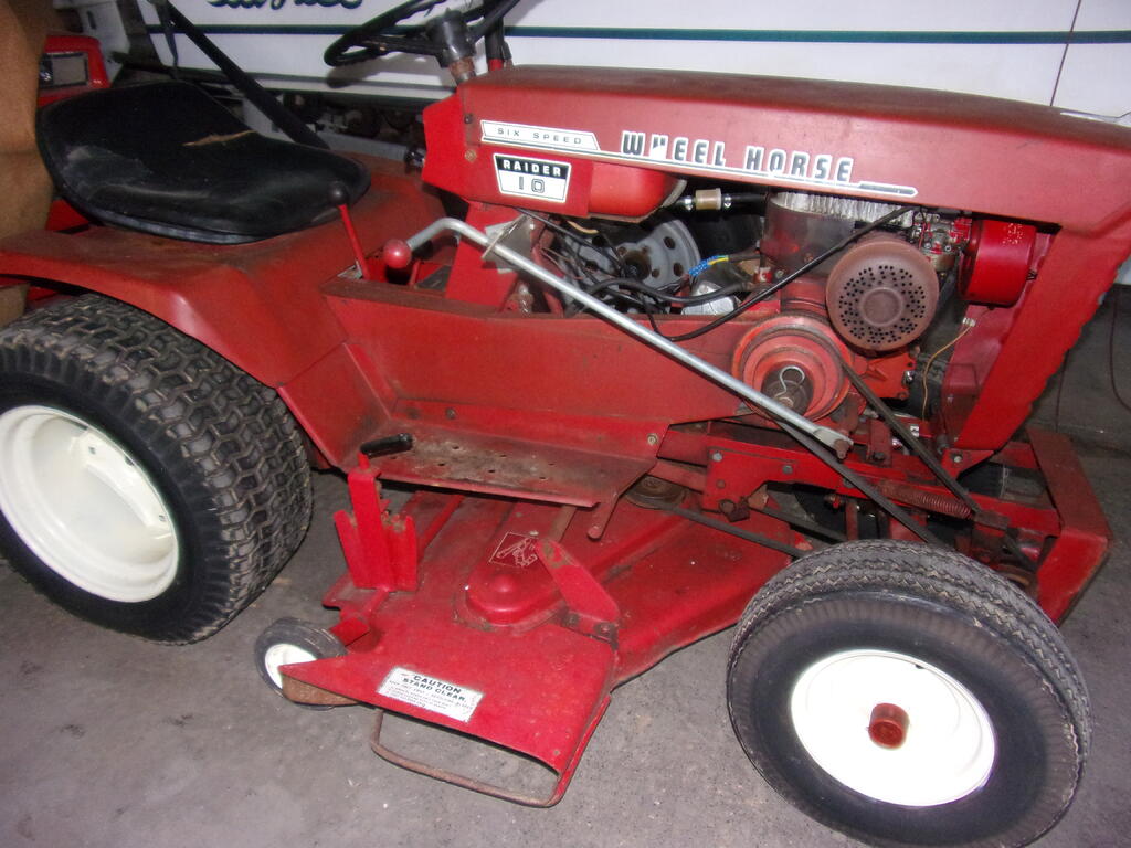

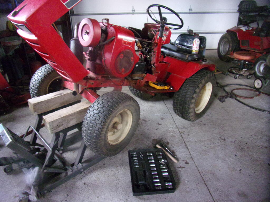

Ed Kennell 46,557 #12 Posted March 3, 2022 A few of the Raiders I have flipped. Many had the early style mule drive and all had the best PTO engagement lever wheel horse made. 4 Share this post Link to post Share on other sites
rmaynard 17,422 #13 Posted March 3, 2022 (edited) The Texas flag...not original. Red, white and blue/gray Wheel Horse decal, original. And you can order replacements from Vinylguy. Edited March 3, 2022 by rmaynard 3 Share this post Link to post Share on other sites

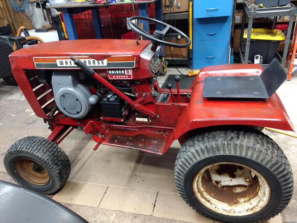

RedWheelz 149 #14 Posted March 4, 2022 So I cleaned carb and still couldn't get it started. So I ordered new electric fuel pump and still no go. Then....yep.... I found the fuel shut off. Anyhow...it runs good. Got it cleaned up and i was pleased with linseed oil outcome. First time using it. Just need a seat now. 1 2 Share this post Link to post Share on other sites
Ed Kennell 46,557 #15 Posted March 4, 2022 4 minutes ago, RedWheelz said: new electric fuel pump and still no go. Then....yep.... I found the fuel shut off. 3 2 Share this post Link to post Share on other sites
SylvanLakeWH 31,715 #16 Posted March 4, 2022 Been there done that… once, maybe twice… or so… Looking good!!! 2 Share this post Link to post Share on other sites
