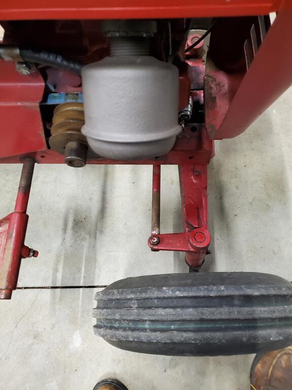

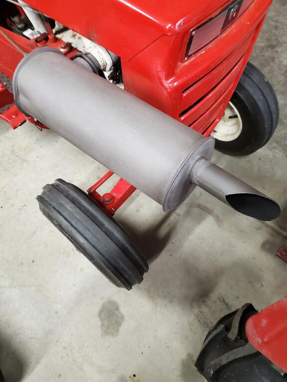

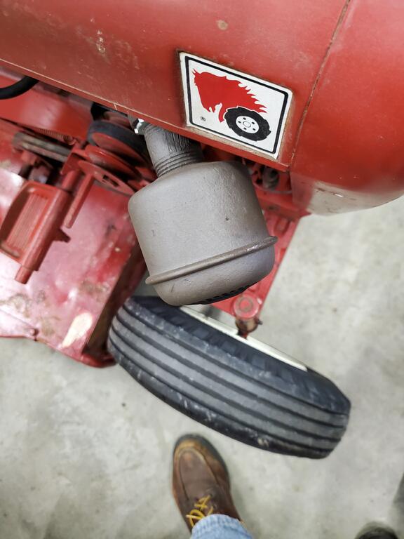

Moparfanforever 938 #10 Posted March 5, 2022 I painted these three mufflers with VHT cast iron paint. A little goes along way and I have had a single can for quite awhile. It does darken the more you use the tractor. 3 Share this post Link to post Share on other sites
