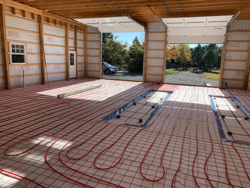

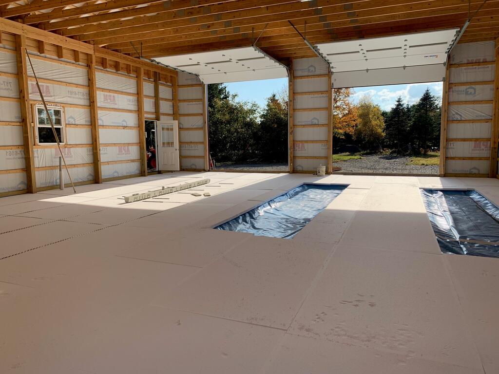

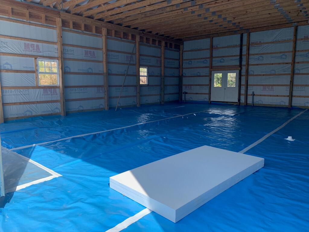

kwalshy 252 #175 Posted October 6, 2023 Took some days off from work to 'Get R Done'. some pics below 3 Share this post Link to post Share on other sites
