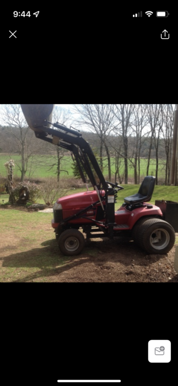

equipment guy 55 #7 Posted February 28, 2022 This is the picture I was sent from the previous owner when I inquired about it. I will take some pics of it today… 3 1 Share this post Link to post Share on other sites
Pullstart 71,215 #8 Posted February 28, 2022 Are those duals, or just the widest single rear tires ever? nice looking rig! 1 1 Share this post Link to post Share on other sites
equipment guy 55 #9 Posted February 28, 2022 Widest ever 23x25-12. 😂 it’s actually the Kwik Way dual wheel kit as suggested in the brochure for the loader. 1 Share this post Link to post Share on other sites
Pullstart 71,215 #10 Posted February 28, 2022 Make sure the outer tires have no or lower air pressure. They aren’t designed to stress the axles, just add stability. 3 Share this post Link to post Share on other sites

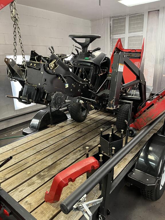

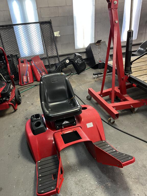

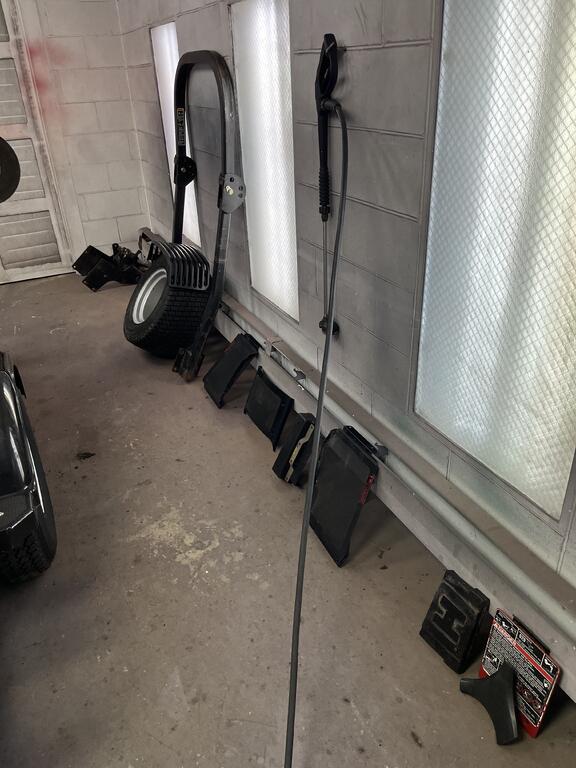

equipment guy 55 #16 Posted February 28, 2022 Here are a few pictures of the tractor cleaned up. 1 2 Share this post Link to post Share on other sites

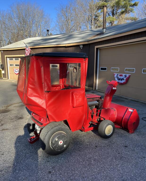

equipment guy 55 #24 Posted February 28, 2022 My first Wheel Horse was a 520H that was given to me with a broken connecting rod and a popped out valve seat. I rebuilt it put a cab on it, and gave it to my father. He used it year round until he passed in 2020. I went through it mechanically again last summer. Steering, electrical etc… Yes, imagine split brakes, differential lock, rear 540, 3 point, and a couple sets of hydraulic remotes on a 523DXI… 🤔 2 Share this post Link to post Share on other sites
equipment guy 55 #25 Posted February 28, 2022 This is my shop, and my dad’s 520H. 2 stage blower on it now. Spray booth is behind the big door. 5 Share this post Link to post Share on other sites
