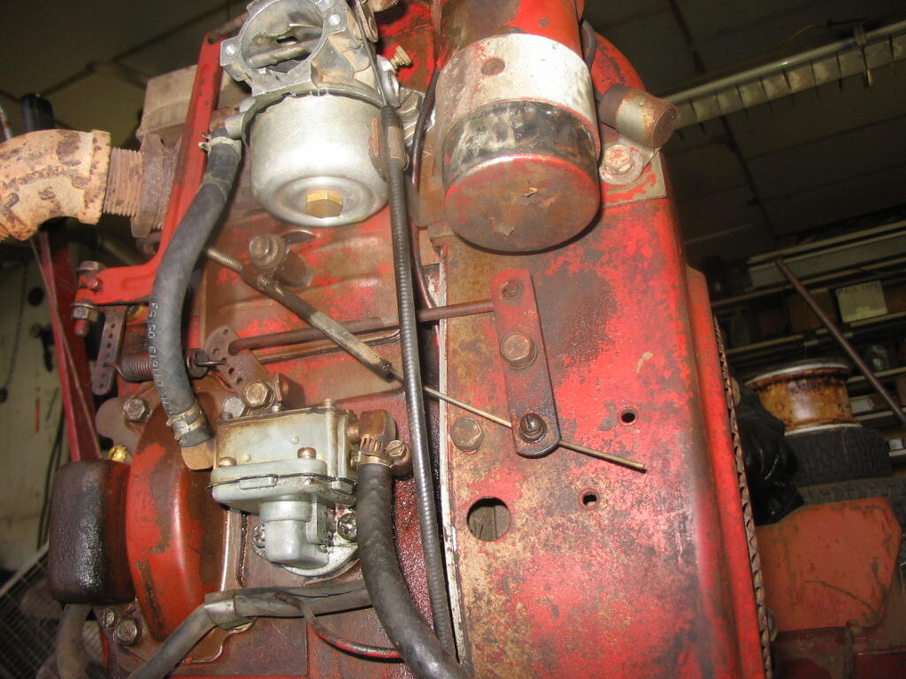

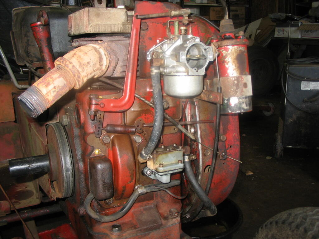

daveoman1966 3,881 #7 Posted February 28, 2022 . This is my C-160. The C-120 otter be the same... 4 2 Share this post Link to post Share on other sites

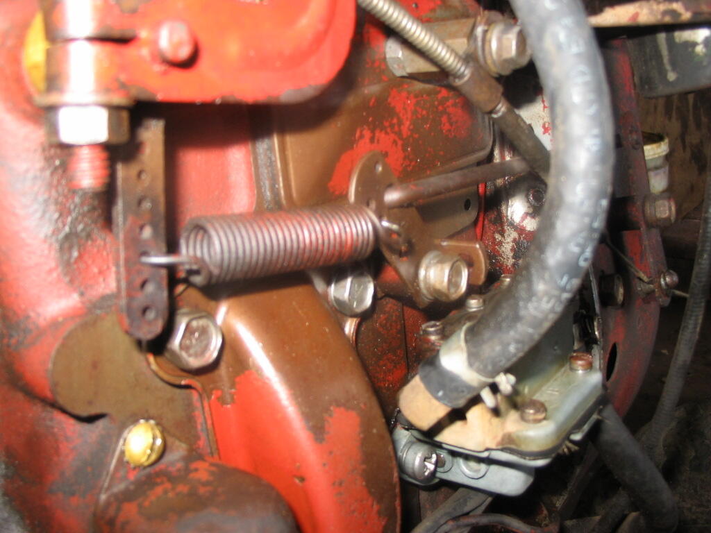

peter lena 9,641 #9 Posted March 1, 2022 @daveoman1966 noticing an oil film on the related area , probably from aerosol lubricant attempt? that very high screaming speed , is scary enough . something I have been doing for years , is to regularly lubricate both ends of that , governor shaft area , till the rust starts to run out , just do it , worth a try . another NON RELATED glairing issue , is the great pictures of the fuel pump to carb fuel hose connection , have something right there that helps quick starts , will not dare to mention it , hope you find your gov issue , pete 1 Share this post Link to post Share on other sites

Mike_c120 33 #11 Posted March 1, 2022 On 2/27/2022 at 9:20 PM, daveoman1966 said: . This is my C-160. The C-120 otter be the same... Daveoman1966, thank you for the awesome pictures ! I can tell mine has definitely been slightly abused because some of my parts on the throttle assembly have a little more play than normal, now I have something to go off of. I appreciate it! 1 Share this post Link to post Share on other sites

squonk 45,052 #13 Posted March 1, 2022 (edited) 8 minutes ago, Mike_c120 said: Awesome thank you, yeah I’m going to be tinkering on it again today to try and get her running right again! Snow keeps coming and need the plow!! Lol The shaft being chinched down by the bolt clamp in this pic must stop while being rotated counter clockwise. Unhook the arm linkage and move the big lever to the right. It should stop after a little movement. If it doesn't don't waste your time adjusting anything. You have one of these broken tabs. Also: See the little l shaped bracket with the hole in it right above the fuel pump? This is the high speed stop. Make sure it's there. Edited March 1, 2022 by squonk 1 1 Share this post Link to post Share on other sites

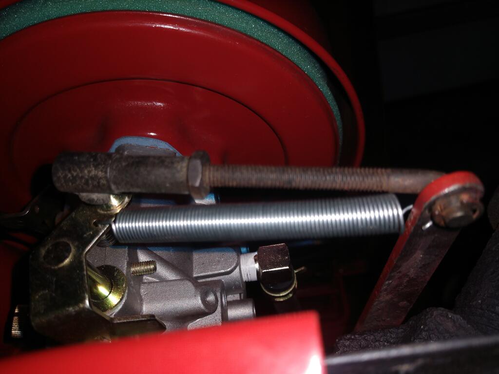

kpinnc 16,503 #15 Posted March 29, 2022 I suggest a light spring between the governor arm and throttle tab. It won't affect the governor action, but will keep slop out of the response. From there your adjustments will work much better. The tab and governor arm both have a hole for the spring from the factory. You can find them at most any hardware store. 1 1 Share this post Link to post Share on other sites
squonk 45,052 #16 Posted March 29, 2022 That little L shaped bracket above your fuel pump is your hi-speed stop. Looks like it needs adjustment. 2 Share this post Link to post Share on other sites
peter lena 9,641 #17 Posted March 30, 2022 @kpinnc like your light spring application on that throttle plate pull. been experimenting with those for a long time , found the very lightest touch to do the job, like this one , the top horizontal spring is perfect , have not been able to find the # specs on that , if I do will be sure to put it on this site , note perforated pull point , easily attached to a mount bolt , for choke / throttle cable spring pull . that pull to assist zero choke and zero throttle , along with SUPER LUBE , makes those cables work with total ease , worth a try , pete 1 Share this post Link to post Share on other sites
kpinnc 16,503 #18 Posted March 30, 2022 4 hours ago, peter lena said: like your light spring application on that throttle plate pull. been experimenting with those for a long time , found the very lightest touch to do the job, like this one , the top horizontal spring is perfect , have not been able to find the # specs on that , if I do will be sure to put it on this site , note perforated pull point , easily attached to a mount bolt , for choke / throttle cable spring pull . Pete, I like yours as well, though they perform different functions. The spring I use only takes the slop out of the throttle linkage, where yours acts as an assist to the throttle cable. Combining both might be worth checking out. I might try something like that. 1 Share this post Link to post Share on other sites
peter lena 9,641 #19 Posted March 30, 2022 @kpinnc yes found that that almost delicate touch on that throttle front plate , was just right , pulling from the same spot, those just enough cable pull springs , enhance the closing , pushing action of the cable . did a number of spring mount points and springs , just looking for a smooth cable close assist . thats what just started to work easier with every open and close , matter of fact going out now to try and find that lite spring ,type / number , so I can refer to it . realize a lot of my set ups is like gilding the Lilly . just what I like to do , pete 1 Share this post Link to post Share on other sites
