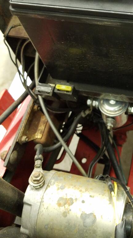

Mustang67ford 234 #1 Posted February 26, 2022 Trying to figure out a few things on the 414 I'm redoing. A few pics of the following would be helpfull of anybody has. It would be greatly appreciated. Been looking but can't find. 1. Photo of circuit board with the battery removed. 2. Where does the spring (#103125) hook that is attached to the rod going up to the pto clutch. 3. Photo of there the 2 fuse holder mount. Thanks Share this post Link to post Share on other sites

Mustang67ford 234 #5 Posted March 3, 2022 Still trying to figure out where the pto arm spring under the dash hooks and where the fusues mount because my relay is on the side where the fuses go unless my relay is in the wrong location. Right now, fuses are hooked to tge battery tray which I know is not correct. Share this post Link to post Share on other sites
ebinmaine 81,047 #6 Posted March 3, 2022 53 minutes ago, Mustang67ford said: relay @JCM What is that relay for? On the two tractors I have here the fuses were hanging right where that is. Maybe Jim can help out because he has complete rigs. Share this post Link to post Share on other sites

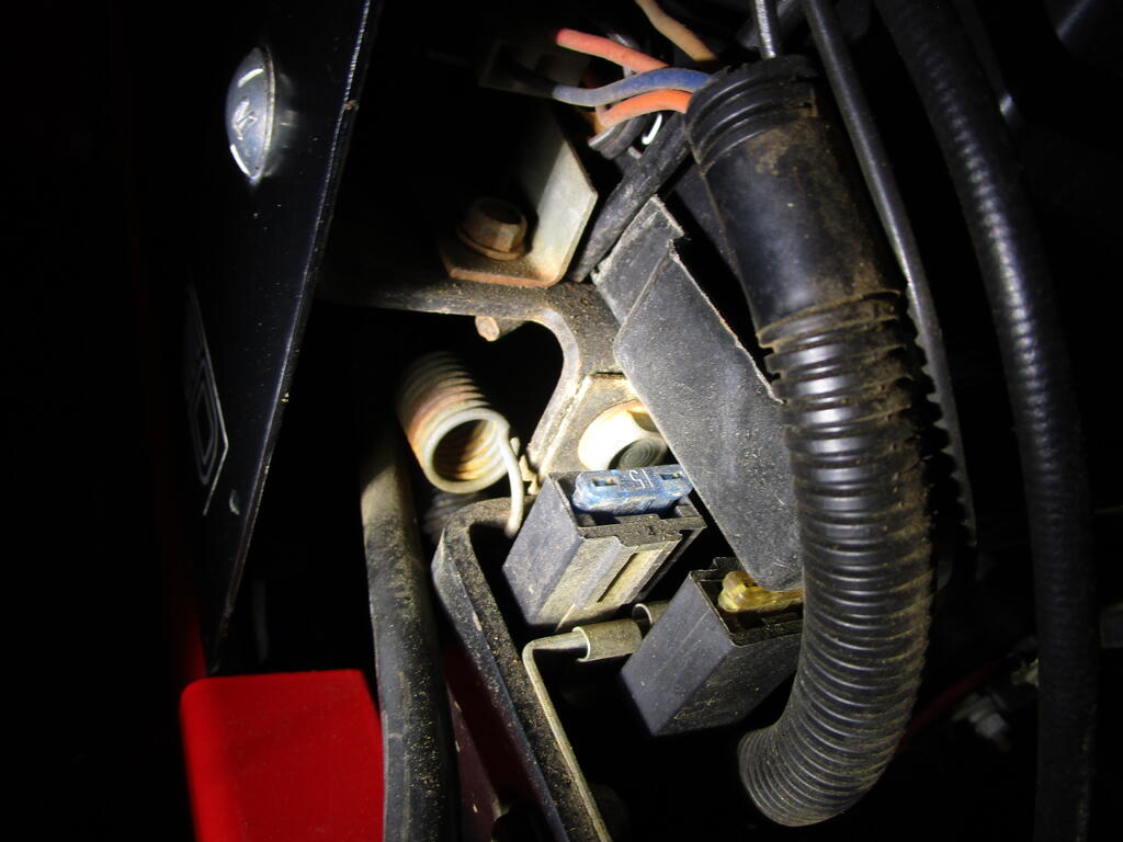

peter lena 10,103 #9 Posted March 3, 2022 @Mustang67ford that pto lever has a Kotter pin , mounted at the battery tray front end area, for a spring pull against the arm . pull off the front of the dash , and look in there , you will see the set up , another thing you could do while there ( only if you want to ) would be to add washers and lubricant to the sloppy start point next to battery , I ad 3/8 to 7/16 of washers , makes a solid smooth lever . that fuse tray mount is easily remounted to another bolt/ screw. also a great time to add to your electrical grounding ( only if you want to ) . add battery cable to the battery ground bolt next to battery , attach that to clutch pedal area , engine /frame bolt . from there ( only if you want to ) attach ,added ground wire to ignition rectifier, on engine tin , and from there to headlight grounding , ( only if you want to ) . only a suggestion while you are in the area , sorry to have dared to take you off course , pete Share this post Link to post Share on other sites

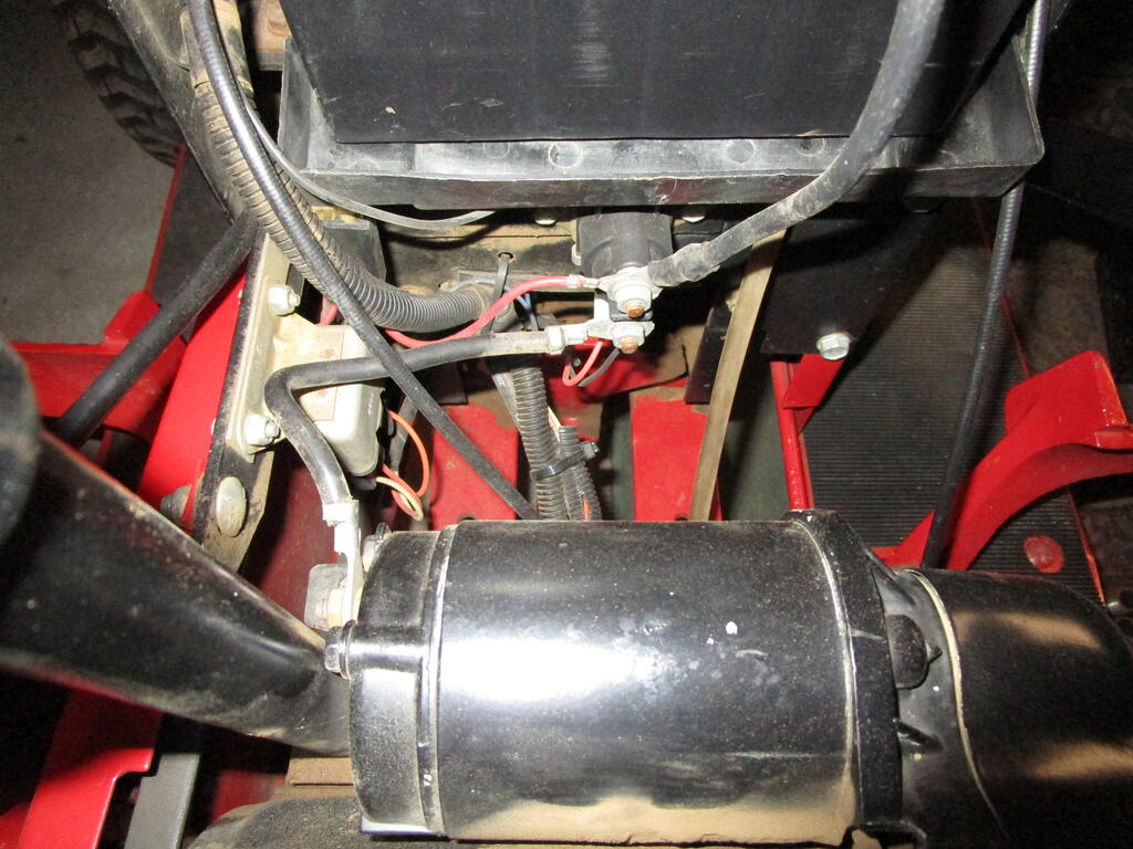

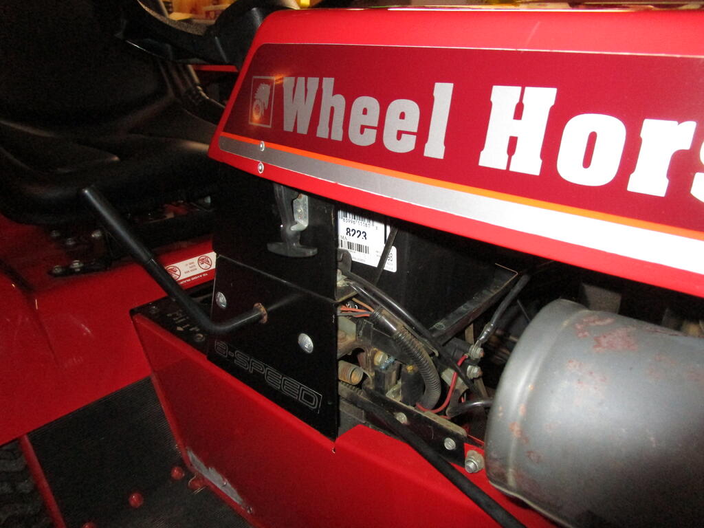

JCM 11,420 #10 Posted March 3, 2022 (edited) Hope this helps. 1989 312-8 @Mustang67ford Edited March 3, 2022 by JCM 2 Share this post Link to post Share on other sites
peter lena 10,103 #11 Posted March 3, 2022 @JCM goods pictures there of the problem area , that spring pull attaches to the pto lever , that entire area , is dense with issues and opportunities. when I started on mine , just went from problem to upgrade and kept going . have a picture posting issue , that continues to be a problem , thank you for the help , pete 1 Share this post Link to post Share on other sites
Mustang67ford 234 #12 Posted March 3, 2022 7 hours ago, JCM said: Hope this helps. 1989 312-8 @Mustang67ford Great! Thanks a lot, that clarifies that. 1 Share this post Link to post Share on other sites
