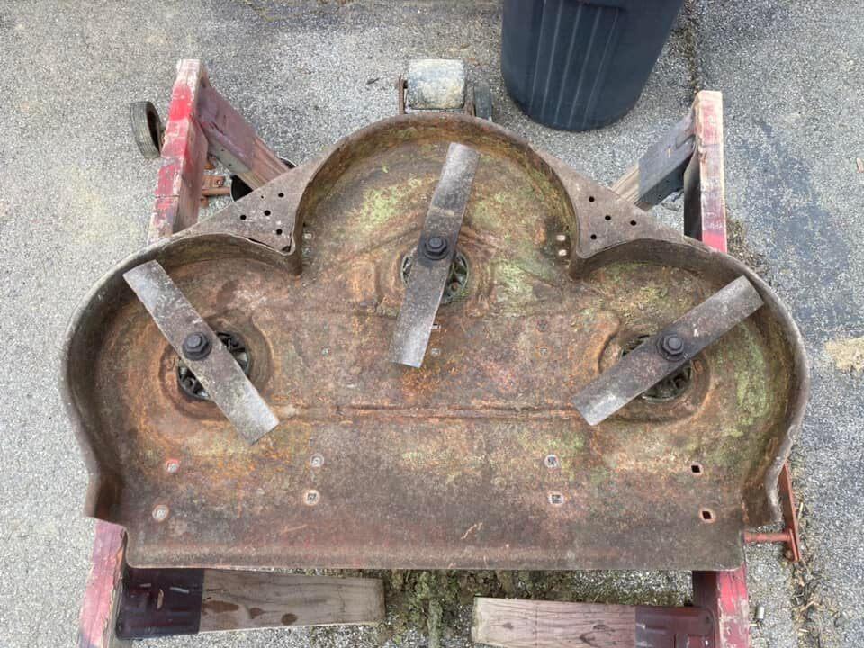

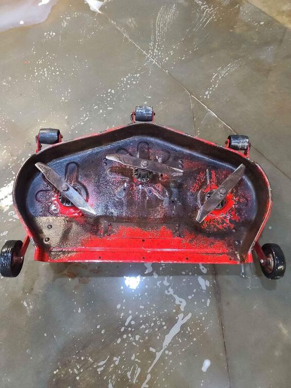

"Manic-Mechanic" 1,485 #1 Posted February 26, 2022 I'm looking at this 42" deck and it doesn't have any baffles, (if that's what they call them) Notice the 36" has them. 1 Share this post Link to post Share on other sites
stevasaurus 23,802 #2 Posted February 26, 2022 Is the one that has baffles a side discharge?? All of my rear discharge decks...no baffles. 3 Share this post Link to post Share on other sites
peter lena 10,013 #3 Posted February 26, 2022 @Manicmacanic, none of my 3, 42" r/d decks have that baffling , or my 36" r/d deck either , the one deck i got on a purchase was baffle packed with damp grass , quickly cutter wheeled it off , oil soak it down and feed that metal , if you want to save it , your second deck underside picture is showing starving metal for a lubrication soak . like this, doing this for years . I also leave the deck at a 45 degree angle after spraying in the hot sun , to dry out and bake in the lubricant , my decks cut without rows or debris , just what I do, my decks are soaking in oil now over winter , upside down . no rust or rot , ready for spring , pete 2 Share this post Link to post Share on other sites
"Manic-Mechanic" 1,485 #4 Posted February 26, 2022 I had just received the 36" and know little or nothing about them. Oil is a familiar maintenance. I get the removal of the baffles, could be done before paint I suppose. Then just oil the underside, soak and let dry-no paint! Is a trade 48" SD for 42" RD practical? 1 Share this post Link to post Share on other sites
"Manic-Mechanic" 1,485 #5 Posted February 26, 2022 1 hour ago, stevasaurus said: Is the one that has baffles a side discharge?? All of my rear discharge decks...no baffles. Nope It's old school 36", model 5-0621 9. RD 1 Share this post Link to post Share on other sites
8ntruck 9,216 #6 Posted February 26, 2022 My 42" RD deck has baffles like the one you show. There is evidence that there were straight baffles towards the back of the deck between the blades. I think there were several baffle/no baffle variations through the year's. 4 Share this post Link to post Share on other sites
peter lena 10,013 #7 Posted February 26, 2022 @8ntruck agree with you on the baffle issue , think the trapped wet grass in the upper baffle area , is not worth the gain you are saposed to get from the cyclonic baffle to blade area. always cut my grass at highest setting , and regularly , drop and inspect them . almost never have any trapped grass at all , maybe just a little grass scab here and there . pete 2 Share this post Link to post Share on other sites
peter lena 10,013 #8 Posted February 26, 2022 @Manicmacanic always a back and forth on deck type and size, how much grass are you cutting and what type of lawn set up do you have ? like the clean cutting and zero grass trail with the r/d deck , others like the s/d . removed all rocks years ago , so nothing but grass . keep my blades sharp , small fine file . deck drop inspection is quick , what ever works for you , pete 2 Share this post Link to post Share on other sites
8ntruck 9,216 #9 Posted February 26, 2022 20 minutes ago, peter lena said: @8ntruck agree with you on the baffle issue , think the trapped wet grass in the upper baffle area , is not worth the gain you are saposed to get from the cyclonic baffle to blade area. always cut my grass at highest setting , and regularly , drop and inspect them . almost never have any trapped grass at all , maybe just a little grass scab here and there . pete Yup. Those front corners pack in the grass. I've got some repair work to do on that deck. I am planning on rebuilding the baffles and leaving the triangular 'floor' out of the front corners. If I don't like the performance of the baffles, it is a simple job to cut them out. 2 Share this post Link to post Share on other sites

biged77 113 #15 Posted February 27, 2022 My 42RD looks just like yours, baffles had been removed before I purchased it (the parts list for mine does call for baffles). Cuts just fine for me. 2 1 Share this post Link to post Share on other sites
kpinnc 18,884 #16 Posted February 27, 2022 I think the later decks had a "recycling" title and sales pitch. I've seen both with and without. Not sure if either was an improvement over the other. 1 Share this post Link to post Share on other sites
lynnmor 9,010 #17 Posted February 27, 2022 My zero turn has a similar baffled area that has the slightest gap,at least it can be removed with two bolts. The space behind it fills completely in just one mowing, you have to see it to believe it. Had I not discovered that the expensive deck would have rusted away quickly. I added Trim-Lok edging to the guard and spray Fluid Film before installing the baffle and that fixed the problem. I mention this so others might know that baffles are a cancer waiting to spread. 2 Share this post Link to post Share on other sites
peter lena 10,013 #18 Posted February 27, 2022 @JoeM noting your deck underside picture , I refer to that closed baffle area as( rot boxes ), first dealing with them , was to drill a center hole ABOUT 1 ,1/2" in attempt to help dry out damp grass. did nothing to help . used a cutting wheel and cleanly removed all related mount areas . I do not use any sealers or paint on the underside of my decks . found once the lubrication soak gets into the metal , it turns black with lubricant stain . as detailed in my rustproofing pictures , rarely have anything at all on the deck surface, drop the deck , 45deg to sun set up , spray it down , thoroughly , make sure the sun gets the deck hot to the touch , its drying and soaking in that lubricant . no deck rot at all , small fine file , blade touch up , lucas xtra heavy duty chassis grease , in all my bearings as well as pto drive bearings , came to this , by detailing problem areas , very reliable , rot free, and quiet bearings , greasy pete 2 Share this post Link to post Share on other sites

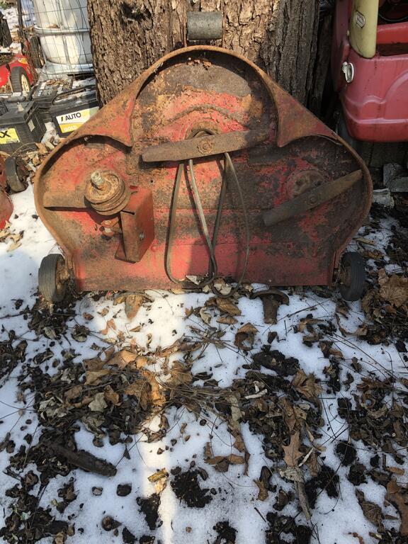

EB-80/8inPA 2,115 #21 Posted February 27, 2022 This deck came with my ‘73 no name and I’m pretty sure it’s vintage. I haven’t ever mounted it (as seen, it needs some TLC). 36” RD with baffles: 1 Share this post Link to post Share on other sites
