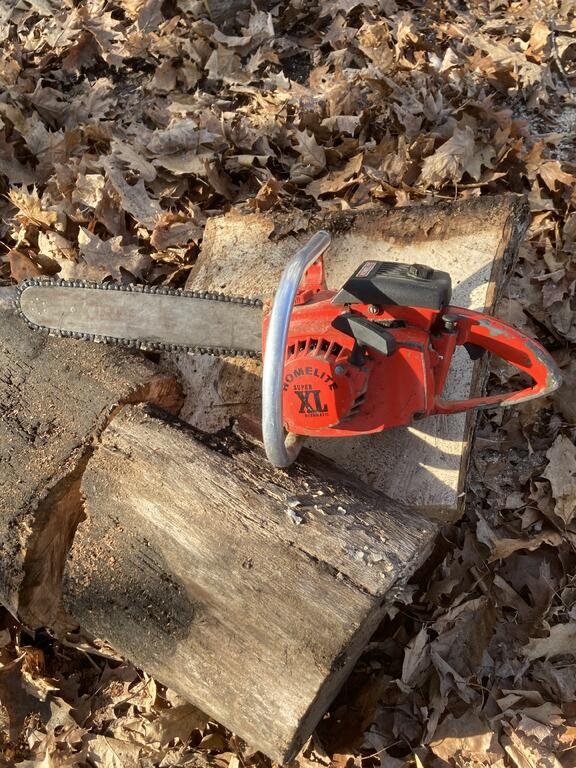

Ifixoldjunk 778 #1 Posted February 26, 2022 So recently I’ve been getting into old saws. I have just this one at the moment but I have a few old mccullochs I’ve been eyeing up. So I know back in the day two stroke mixes were leaded gas and straight motor oil so we had mixes like 10:1 and 16:1 Anyways this particular homelite calls for 32:1. I’ve been told that modern two stroke mixes lubricates better than the old stuff, I’ve also been told that too much of the new oil can lead to carbon scoring in the cylinder. Some people have told me to run regular 40:1 50:1 multimix. What’s the consensus here? Do old two strokes need the original mix ratios, or is modern 50:1 suffice? Share this post Link to post Share on other sites

wallfish 20,637 #4 Posted February 26, 2022 (edited) At 50:1 you'll probably seize it. I run my even older Homelite (Blue paint 60s,16:1 motor oil) stuff at 32:1 because modern oil will lubricate better than motor oil did but I'd still run that 70's saw at 32:1 too. A little extra lubrication ain't gonna hurt it. The Super XL is an excellent saw with plenty of power. I never got into the collecting of old chainsaws (Just the 2 stroke powered tools) because there's no bottom to it, Ever! So many different saws out there. Some of the old Russian stuff pops up from time to time which is very tempting. Edited February 26, 2022 by wallfish 3 Share this post Link to post Share on other sites
