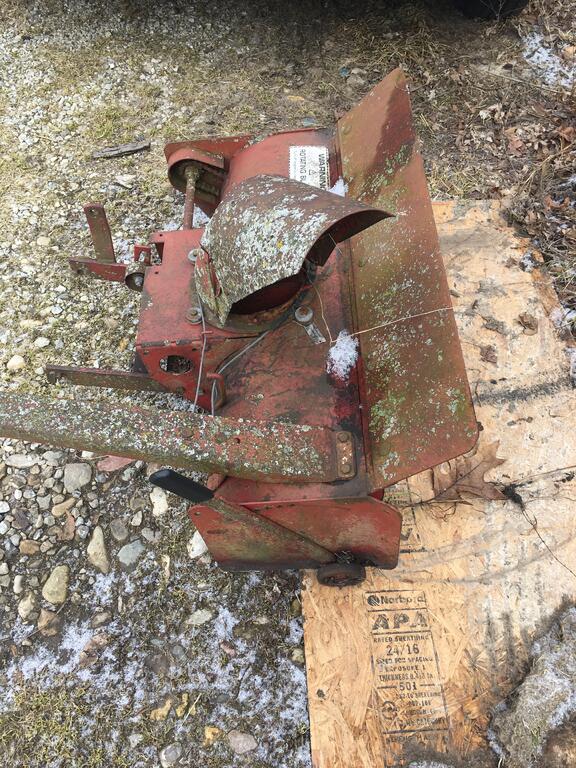

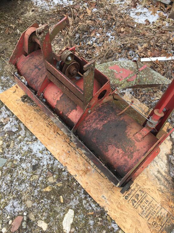

Indianajohn 54 #1 Posted February 25, 2022 I rescued a very rough B165 a couple of years ago from an old garage that was being torn down. I also got the snow thrower attachment that was sitting behind the garage. I’ve been searching the interwebs for a pic of a B165 with the thrower attachment on it, but so far no luck. Didn’t think they were that uncommon, but I guess I was wrong. It appears there must have been some type of mule drive/mounting bracket that went missing long ago. Anywho, from pics I’ve seen online it looks like the snow thrower is basically the same thing as the 42” used on most other WH tractors, just without the “wings, and with a different mounting bracket/idler assembly, and a shorter driveshaft. Considering how rough the B165 is and that I’m apparently missing the parts I would need to install it, I’m thinking the best move is to change it over to the 42” configuration and put on my 520H. Changing the driveshaft is easy enough, and I can build the rest if I can find dimensions or drawings. Can anybody think of any “gotchas” I’m not thinking of? 1 Share this post Link to post Share on other sites

Indianajohn 54 #3 Posted February 25, 2022 I believe this is the 37” version, which became the 42” with the addition of the bolt on “wings”. The mounting bracket/idler assembly bolts on, just like the regular 42” version. 1 Share this post Link to post Share on other sites

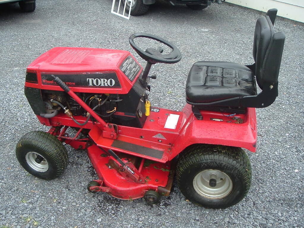

squonk 47,887 #10 Posted February 25, 2022 I put a Simplicity snow blower with a horizontal drive shaft like this: Onto this vertical shaft 210-H And it worked great for more than 10 years Share this post Link to post Share on other sites

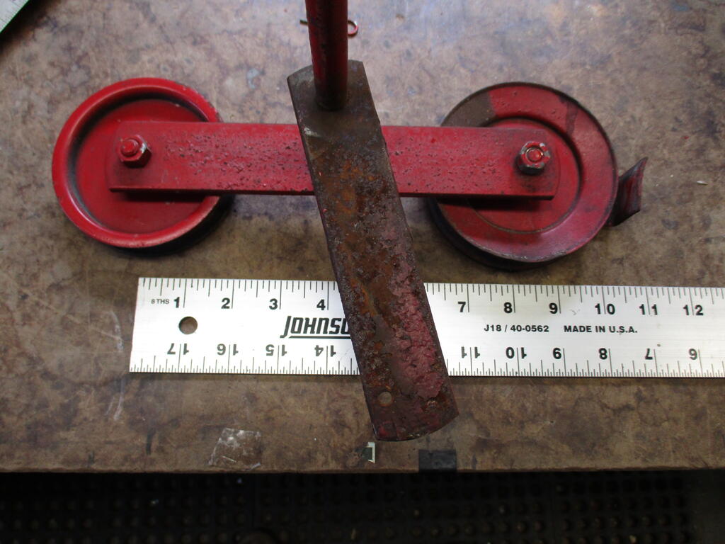

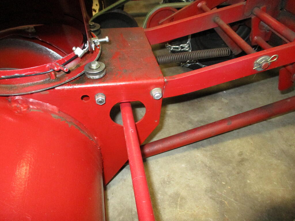

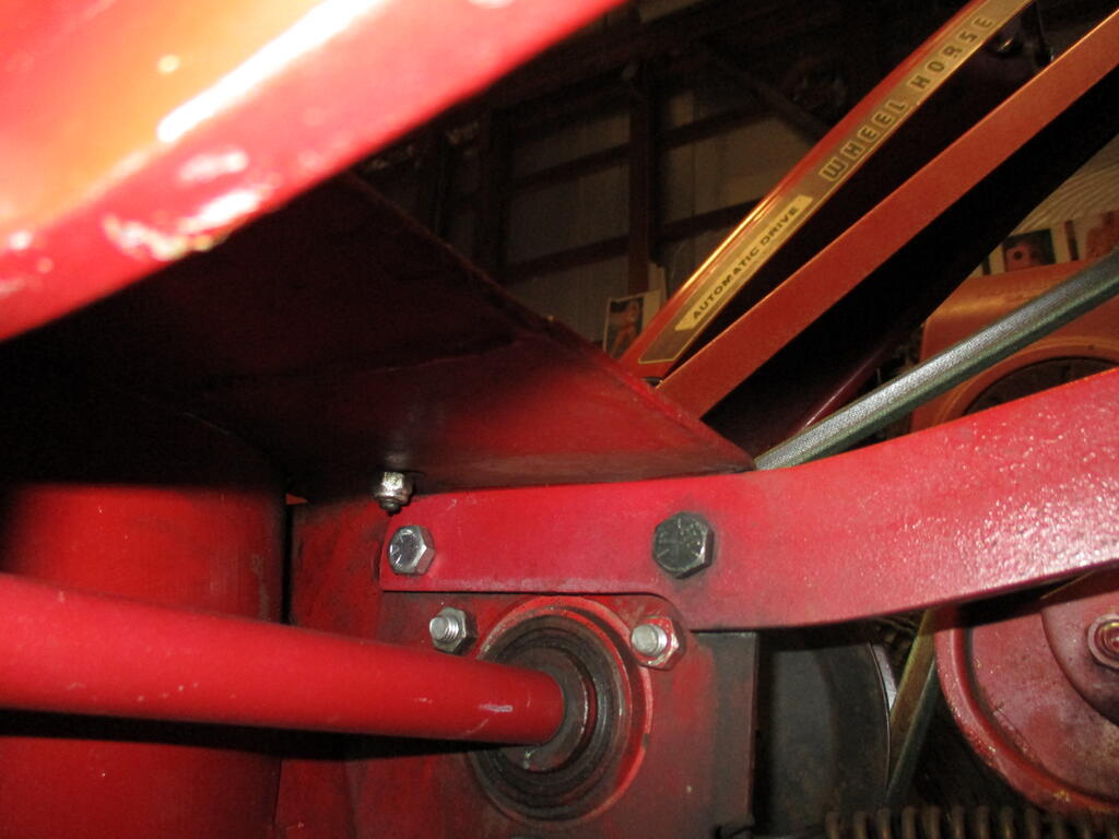

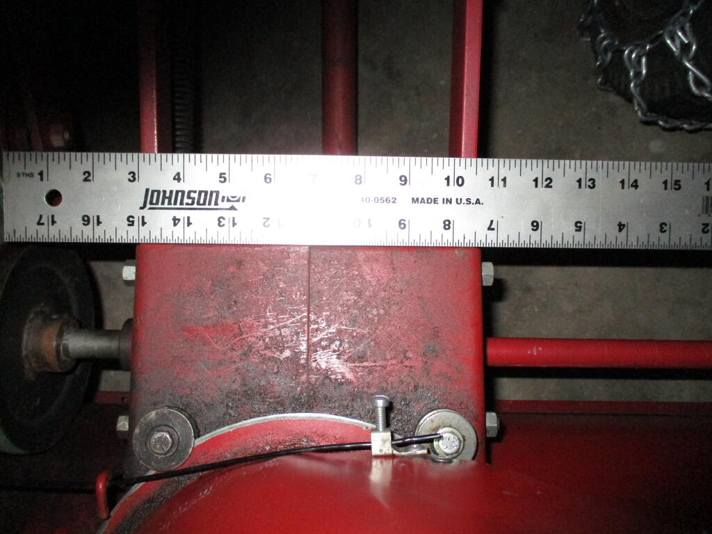

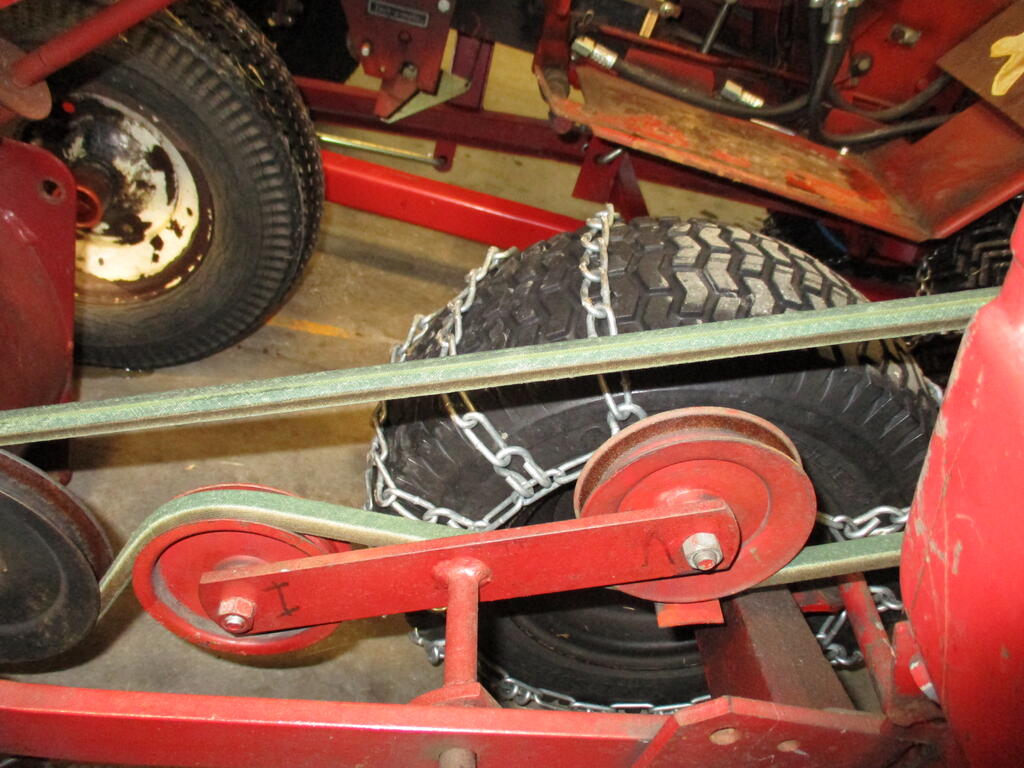

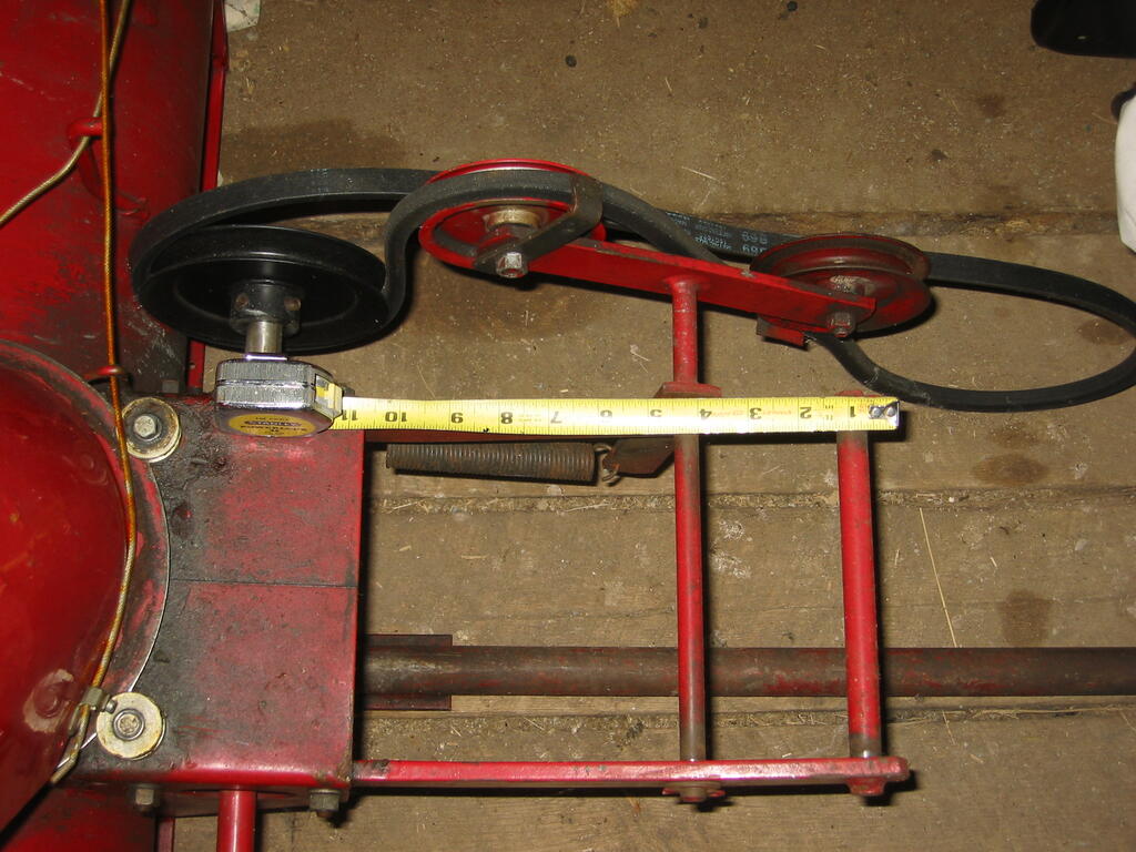

pfrederi 21,044 #11 Posted February 25, 2022 Only pic I have at the moment with tape measure. Will get some more with measurements/pics tomorrow. 1 1 Share this post Link to post Share on other sites
pfrederi 21,044 #12 Posted February 25, 2022 The 2 mounting bolts in second pic are 3.5" OC The idler bracket pic 3 are 8" OC and the shaft it pivots on is 11" you can see other end with washer an hare clip in pic 2 1 Share this post Link to post Share on other sites
Indianajohn 54 #13 Posted February 26, 2022 Thanks! That’s exactly the type of info I need. I can now start making some drawings. The hardest part of all this will be figuring out the angle those mounting ams are bent to. Can you tell me what diameter rod that idler pivot is made from? Looks to be about 3/8”, but that’s just a guess. The mount rod looks to be 1/2” and the idler pivot is obviously smaller. It also looks like the spring arm is welded at 90 degrees to the idler arm. Is that correct? Thanks for your help! 1 Share this post Link to post Share on other sites

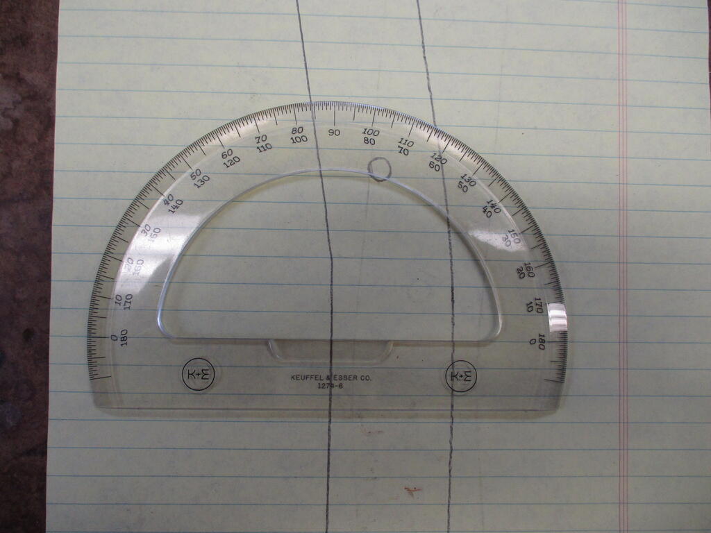

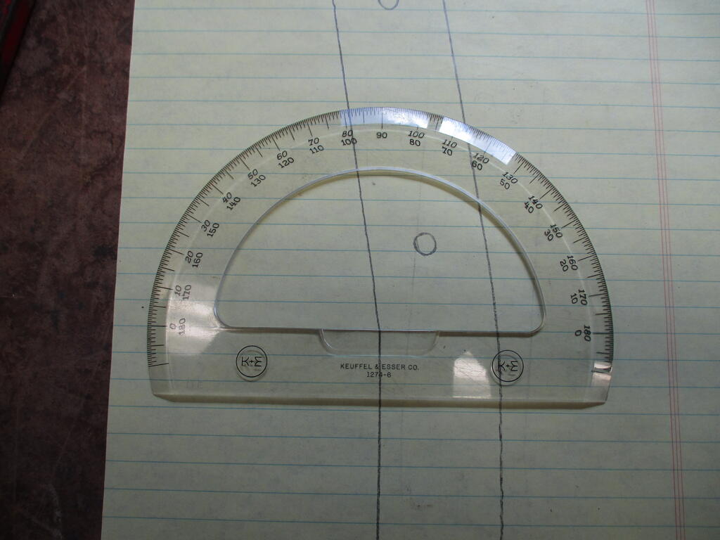

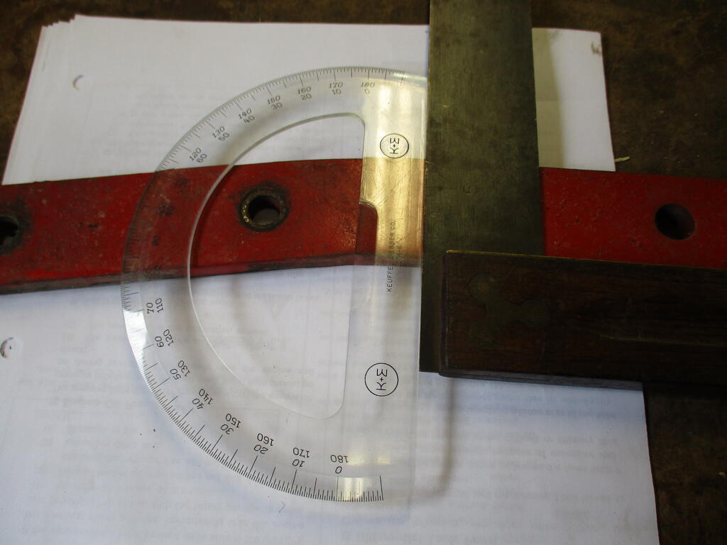

pfrederi 21,044 #14 Posted February 26, 2022 (edited) Idler cross shaft is 1/2 diameter stock The tachmatic cross rod is 5/8" Idler arm is 1/4" the spring arm is 6" long but not 90 degrees. I have to think some on the best way to measure that The mounting fame is 3/8 stock 1-1/2" wide. I traced the bend (I have an old style non tachmatic mount) but the bend is the same. Looks like 85 degrees to me (see pic).. Note the right frame rail is cut away some to clear the jack shaft bearing. Edited February 26, 2022 by pfrederi Share this post Link to post Share on other sites
Ed Kennell 46,979 #15 Posted February 26, 2022 (edited) Paul, look at your protractor closely. I think you need to slide it up 3 lines so the zero is on the bend point. The angle is actually 80-81 degrees. Edited February 26, 2022 by Ed Kennell 2 Share this post Link to post Share on other sites
pfrederi 21,044 #16 Posted February 26, 2022 (edited) 20 minutes ago, Ed Kennell said: Paul, look at your protractor closely. I think you need to slide it up 3 lines so the zero is on the bend point. The angle is actually 80-81 degrees. Never was any good a geometry good point. Close to 81 Edited February 26, 2022 by pfrederi 1 Share this post Link to post Share on other sites
pfrederi 21,044 #17 Posted February 26, 2022 Sine I just failed geometry how would be a way to measure the angle of the spring holder?? cants back towards the rear of the tractor Share this post Link to post Share on other sites
Indianajohn 54 #18 Posted February 26, 2022 Thanks! I knew that would be a relatively shallow angle. I was guessing 5-10 degrees, so if I bend to roughly 10, that should be close enough. A degree or so either way shouldn’t really matter, as 2 or 3 psi difference in the front tires would have about the same effect. The idler arm looks to be 1 1/2” stock as well, or is it 1 1/4”? 1 Share this post Link to post Share on other sites
pfrederi 21,044 #19 Posted February 26, 2022 The idler arm is 1-1/2 (1/4 thick) Spring tensioner is 1-1/4 (1/4 thick) 6 inches long Share this post Link to post Share on other sites

Ed Kennell 46,979 #22 Posted February 26, 2022 18 minutes ago, pfrederi said: I just failed geometry how would be a way to measure the angle of the spring holder? Naw, with that correction you get an A+. I just put my protractor on your picture and measured 105/75 degrees. 1 Share this post Link to post Share on other sites
pfrederi 21,044 #23 Posted February 26, 2022 14 minutes ago, Ed Kennell said: Naw, with that correction you get an A+. I just put my protractor on your picture and measured 105/75 degrees. Tried for more accuracy put a square on the bracket to make sure my protractor was square and got the mark at the start the bend looks lie 81 degrees but since this isn't rocket science close enough??? 1 Share this post Link to post Share on other sites

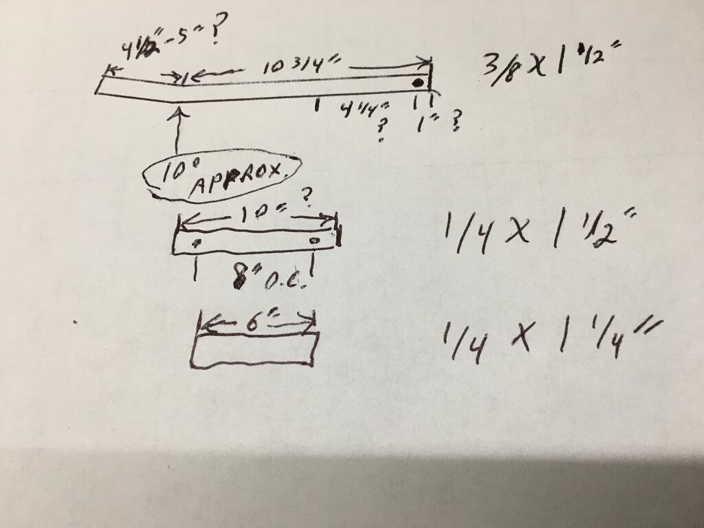

Indianajohn 54 #25 Posted February 28, 2022 Okay, I took some time today to start drawing out some parts and looking some stuff up. I have the IPL for a 42” thrower and was able to cross the two idlers. Turns out I already have the flat idler in stock. Just have to get the V idler. I have yet to find a cross for the drive pulley on the jack shaft. I know it’s bigger than the one that’s on mine now. Please take a look at my drawing and let me know if I have anything wrong. Some things I took a guess at, (anything with “?”). Any corrections or anything I’m missing, please don’t hesitate to let me know. I’m trying to be as accurate as I can…. 1 Share this post Link to post Share on other sites
