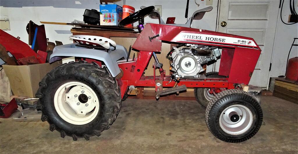

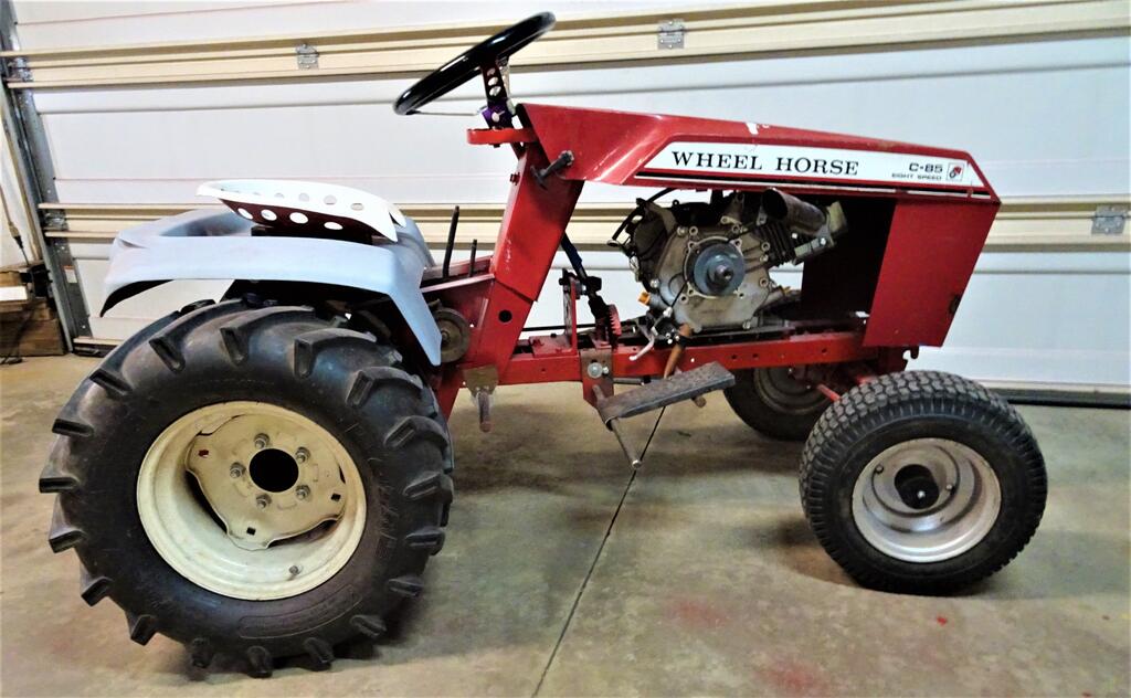

giddyap 1,574 #34 Posted March 9, 2022 I'm a ship without a rudder, my whim could decide my final decision. Just because I didn't like the height of the steering wheel, I have to drop the tower or something else to please my eye. So, why not explore my options? What's the harm? Said me, that is now dazed and confused. 1 5 Share this post Link to post Share on other sites

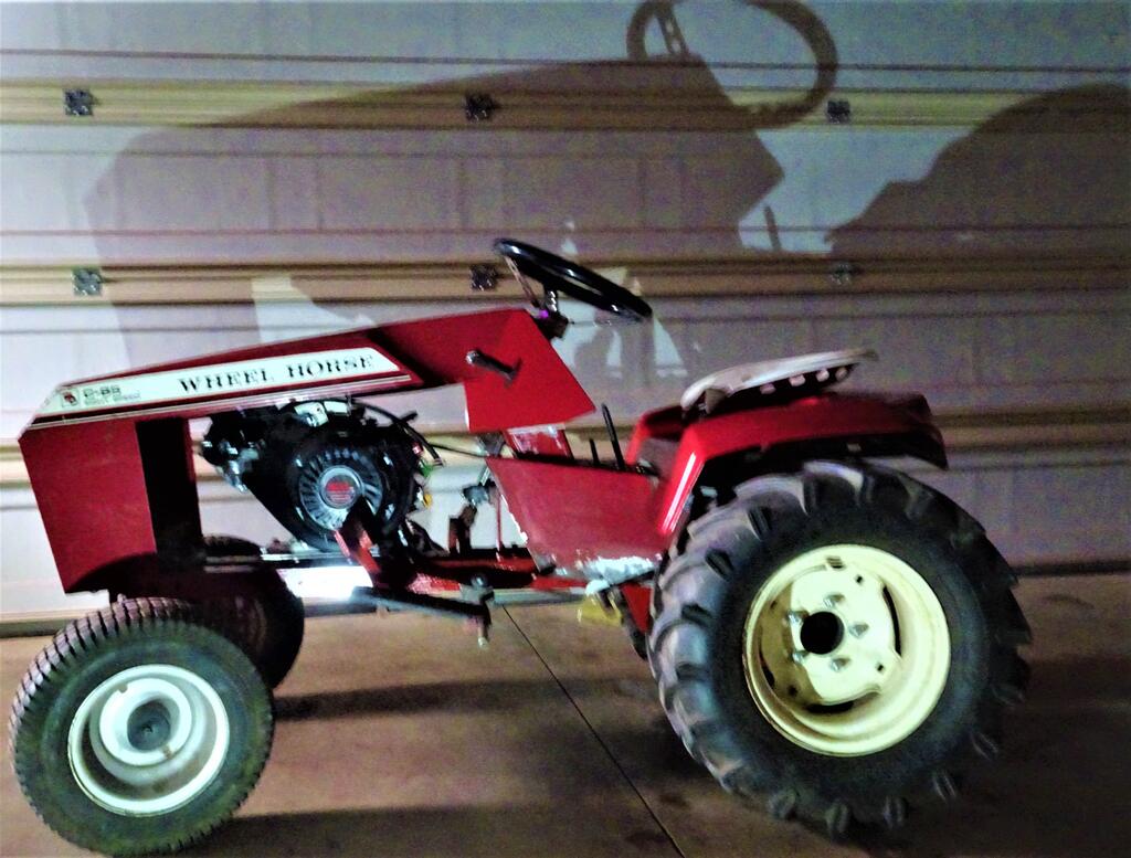

giddyap 1,574 #36 Posted March 9, 2022 (edited) 9 minutes ago, SylvanLakeWH said: Love the Black Hoods!!! Yeah me too. I cut 6" off the front end and it looks good next to my C-165. Oh yeah custom tail lights and air foil! Edited March 9, 2022 by giddyap additional info 2 1 Share this post Link to post Share on other sites
Pullstart 71,103 #37 Posted March 9, 2022 That does look pretty awesome Jon! 1 Share this post Link to post Share on other sites
Moparfanforever 933 #38 Posted March 10, 2022 They both look really cool, I say you need to build both of them !! 1 1 Share this post Link to post Share on other sites
giddyap 1,574 #39 Posted March 11, 2022 Still undecided so I must continue building each one, one at a time. Today I got a good start building the seat pan and clamping down the instrument panel box on the black hood. The steering wheel position looks good but on the round hood, ugh. So that might be the big issue from me liking the round hood build and finding a solution. Photo did not load, see next post 1 Share this post Link to post Share on other sites
kpinnc 18,886 #42 Posted March 11, 2022 I like both versions! Build one of each! 3 Share this post Link to post Share on other sites
