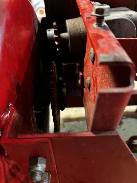

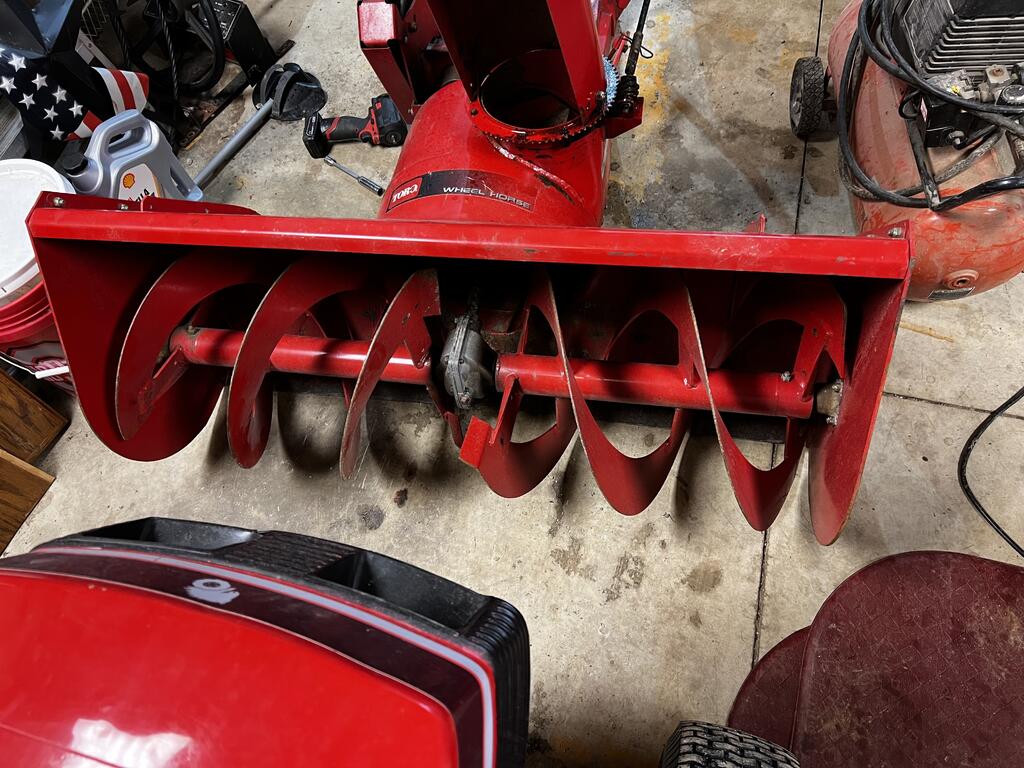

WH1618speed 543 #1 Posted February 19, 2022 Hi everyone, I got a Wheel Horse two stage snowblower recently and the chain fell off. it was quite loose with the tensioner being maxed out. I took the chain off and it was incredibly stiff. I am going to soak it in some new oil and see if that does the trick but I didn't see any kind of other way it could be tightened. I am new to these 2 stages as only having the single stages before. The snow blower itself is in incredibly good condition but the chain is really stiff. I realize the gear box sprocket is out of alignment because I had to loosen it to remove the chain but it was perfectly aligned prior to. 1 Share this post Link to post Share on other sites

lynnmor 9,081 #4 Posted February 19, 2022 There is a block that rides against the chain, the early ones are wood and the last one had plastic. Look at the parts diagram and you will see it. The block is adjusted by loosening two bolts and moving it till nearly all slack is removed. Since the chain was neglected and rust formed inside the links, I would replace it because that tension block takes too much of a beating. Those chains need to be oiled after every use and the tension checked. 2 1 Share this post Link to post Share on other sites
peter lena 10,126 #5 Posted February 19, 2022 @WH1618speed agree with @roadapples on the chain replacement , from the view of those thin gear forward edges , chances are that chain drive was used running dry . would recommend you getting some specific CHAIN AND OPEN GEAR AEROSOL;LUBRICANT . AND KEEP THAT CHAIN SET UP WET WITH LUBRICANT , also detail out any related linkage movement areas. also check out the lube level on the center auger drive . lube that open gear spiral chute set up . did a 2 stage a couple of years ago , was starved for maintenance , and lubricant. just the opposite when I sold it . pete 2 Share this post Link to post Share on other sites
wallfish 20,744 #6 Posted February 19, 2022 Definitely replace the chain since you're in there anyway. #40 roller chain. As for the tension there are a couple of options. A new block tensioner or installing an idler sprocket instead. I chose a small 10 tooth sprocket as a tensioner used on the outside loop of the chain on the bottom side as it fits easily in that small short space between the 2 sprockets and holds the chain tight into the teeth of the gearbox's small driven sprocket . Most commonly available are the larger 17 tooth idlers which can work too but you will know what I mean when you try to install one. https://www.ebay.com/itm/224568643751?hash=item34495590a7:g:s6sAAOSw5g5hFDdA Some on here may not like the looks of the bearing on the small 10 tooth or question it's hardness of the teeth but I don't believe they even have a 2 stage blower or ever tried installing a 17 tooth sprocket in one, let alone trying a 10 tooth. It's not impossible to install a bigger sprocket as I originally had one installed on mine and it worked OK but chose to remove it in favor of the smaller one. They do have a bigger bearing and are a bit more heavy duty but for the purposes of this application I have found the smaller one is more than adequate, easier to fit in there and allows for much more tension adjustment to keep the chain better engaged with the drive sprocket. Haven't needed to adjust any tension since installing it and 0 chain slip under heavy loads. 5 Share this post Link to post Share on other sites

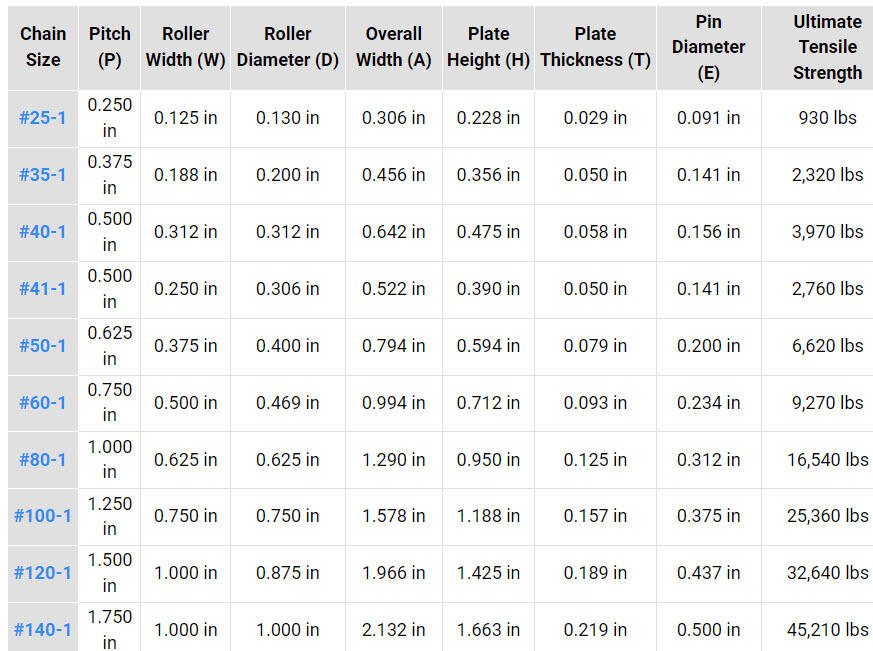

HorseFixer 2,015 #21 Posted December 20, 2023 (edited) 3 hours ago, wallfish said: I bought a length of chain from a guy at one of the local engine shows. He had a bunch of motorcycle stuff so assuming it's motorcycle chain. Maybe check some motorcycle shops. It seems like the cheap chain was stretching/wearing kind of quickly. I put some pretty heavy loads on mine and especially so when the snow is wet. Loading it up heavy tends to keep it from clogging the chute. I have done plenty of searching this afternoon and Here is a graph I found on chain specs, ~Duke Edited December 20, 2023 by HorseFixer 2 Share this post Link to post Share on other sites
ebinmaine 81,283 #22 Posted December 20, 2023 14 minutes ago, HorseFixer said: chain specs I've got some of that #60 here. You should see that stuff next to the #40. Gargantuan!! 1 1 Share this post Link to post Share on other sites
HorseFixer 2,015 #23 Posted December 20, 2023 27 minutes ago, ebinmaine said: I've got some of that #60 here. t give that stuff away~ You should see that stuff next to the #40. Gargantuan!! I bet they don't give that stuff away! `~Duke 2 Share this post Link to post Share on other sites
