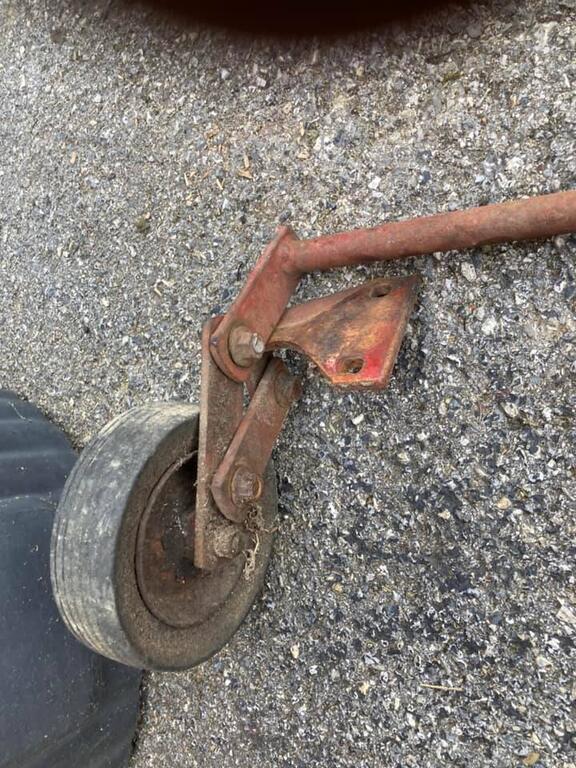

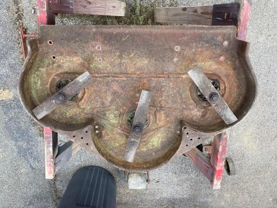

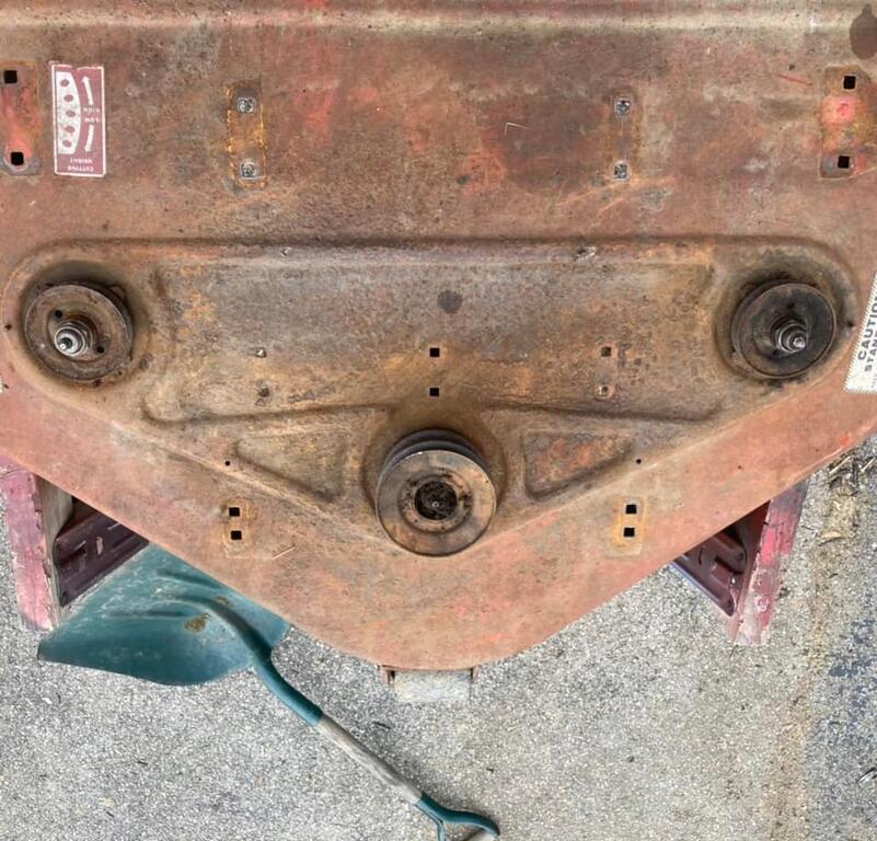

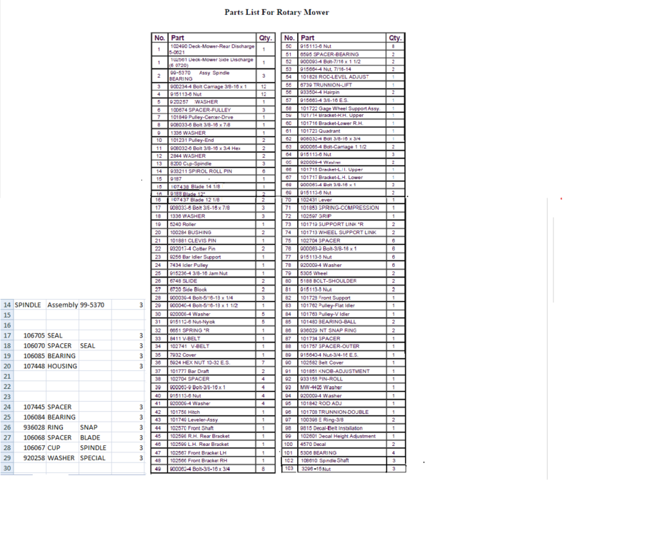

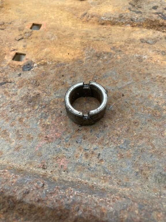

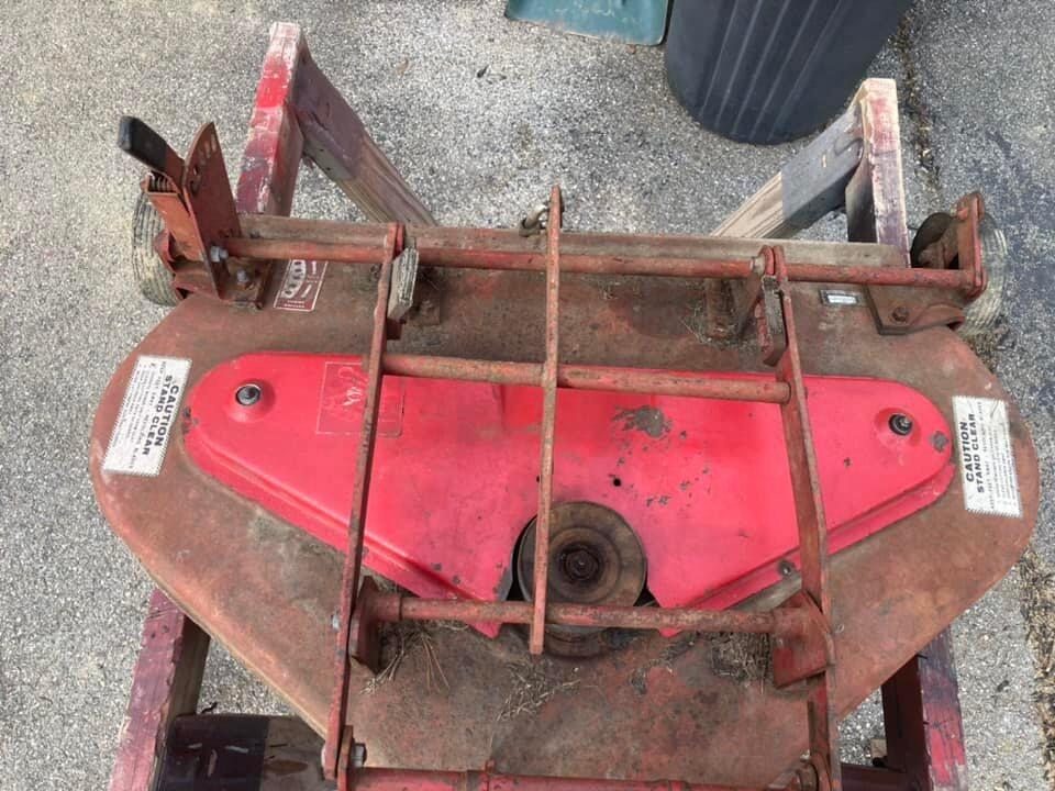

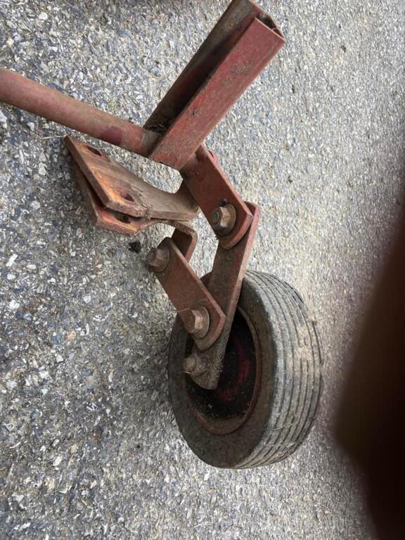

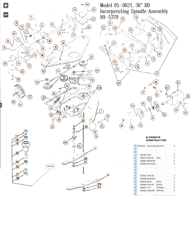

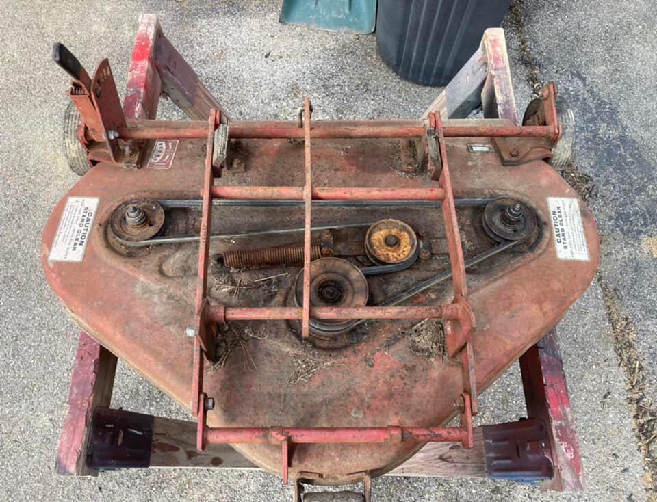

"Manic-Mechanic" 1,486 #1 Posted February 19, 2022 (edited) I picked up solid rear discharge deck for cheap, was odd due to the newer spindles. So, after extensive help from gwest_ca-(File Mod) a list was comprised and I selected 5-36YR01 for spindle diagram. (This assembly 99-5370, uses spindle shaft 108610 3/4" x 6" with a key 937222 at 2.5") . The remainder of the diagram was 05-0620 as close a match I could find to 5-0621 and the parts file associated. Over all everything came apart clean, could tell someone had it apart not that long ago I fashioned a cover from Model 5-0720 drilling two 1/2" holes for the fittings The condition is fair, no holes and enough material to bead blast or sand heavily I did manage to remove the blades and spindle pulleys, but got overzealous on the first drive and forgot about the key, 937222 (formerly 937159) and cracked the spacer/seal 106070! The right side wheel assembly for reference The left. Amazing how these decks evolved, many thanks to all the help figuring this deck out and the belts, spindle belt 8411 1/2 x 76.94, deck drive belt 102741 1/2 x 96.6 for use on 300 series. I have a Parts List and Diagram compiled Edited March 17, 2022 by "Manic-Mechanic" Revisons 2 Share this post Link to post Share on other sites
