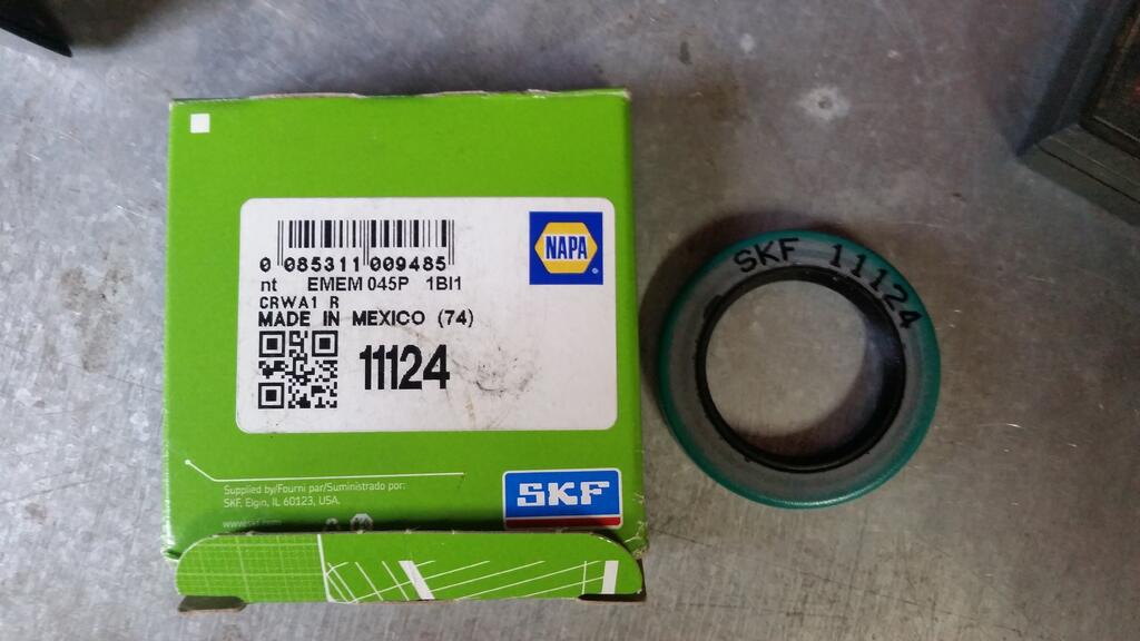

WHX?? 58,291 #6 Posted February 17, 2022 Here ya go Bill. Axle seals anyway. 2 1 Share this post Link to post Share on other sites

squonk 48,207 #12 Posted February 22, 2022 (edited) Just for reference a LOT of SKF seals are not stocked at The Napa stores or even the distribution centers. Mostly they have to factory order them. At least the ones I've run across the last couple of years. The 11124 is not stocked at my store. There is 1 in my Syracuse DC and 2 in Albany. 1 1/8 axle seal 11050. Same thing. 1 in Syr. 2 in Buffalo. 6105 input seal, 1 in the store's network of 10 other stores. I think the unidrive brake seal is a a common shift shaft seal for auto transmissions. I remember when a lot of the seals got sent back because they sat on the shelf. It's all about moving inventory now. Stock 10 different sets of brake pads for one car but send back stuff that will get someone out of a jam someday. Edited February 22, 2022 by squonk 1 Share this post Link to post Share on other sites
