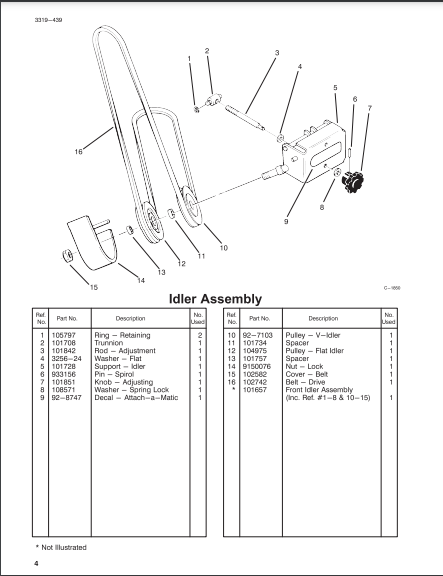

"Manic-Mechanic" 1,486 #1 Posted February 15, 2022 I noticed this has been requested so it can be found in a recycler PDF 3319-439_1997_48in_SD_78365_Recycler_IPL.pdf Share this post Link to post Share on other sites
