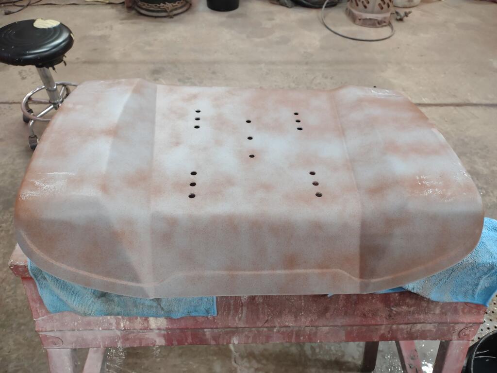

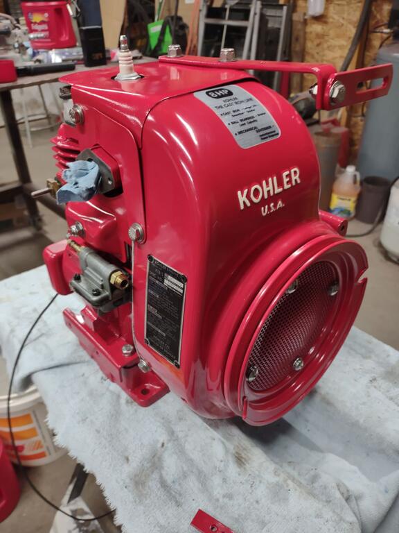

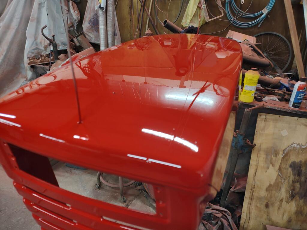

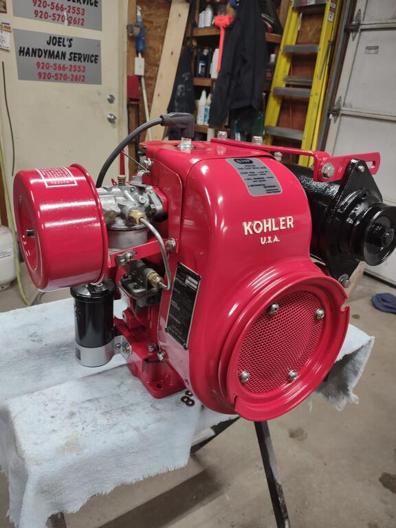

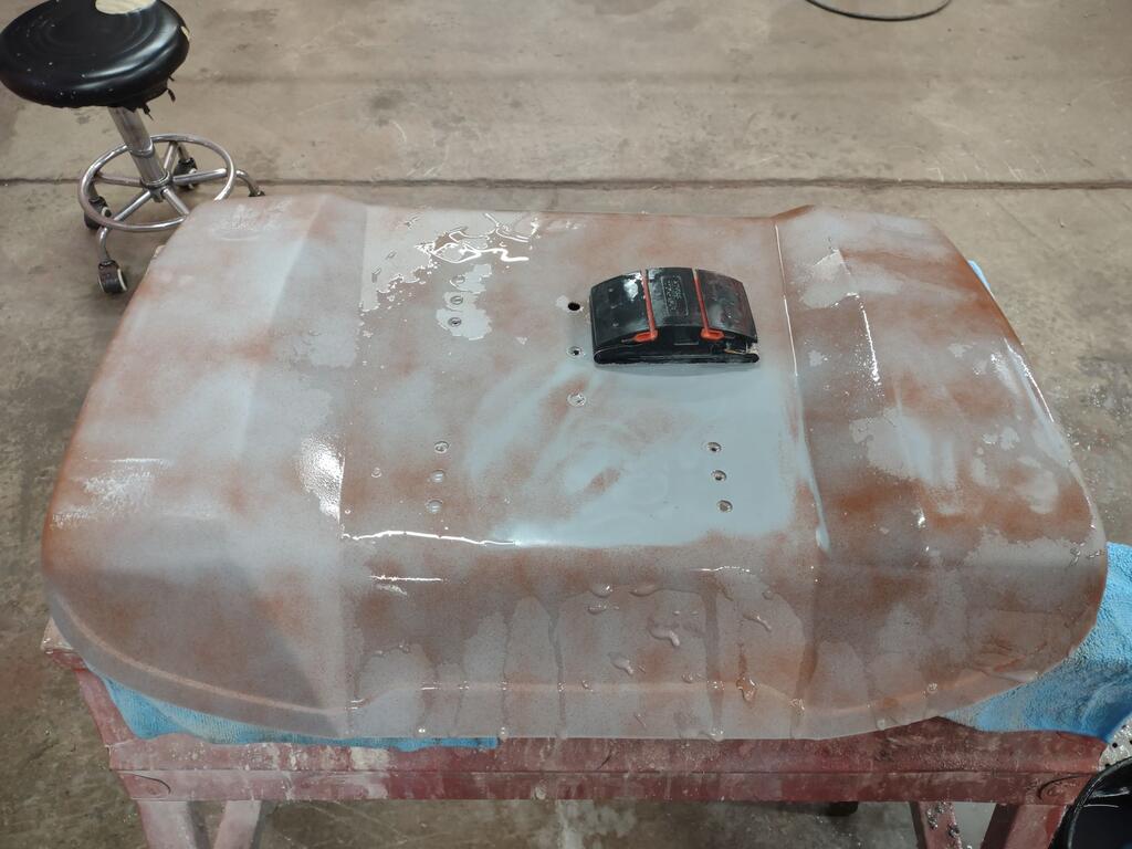

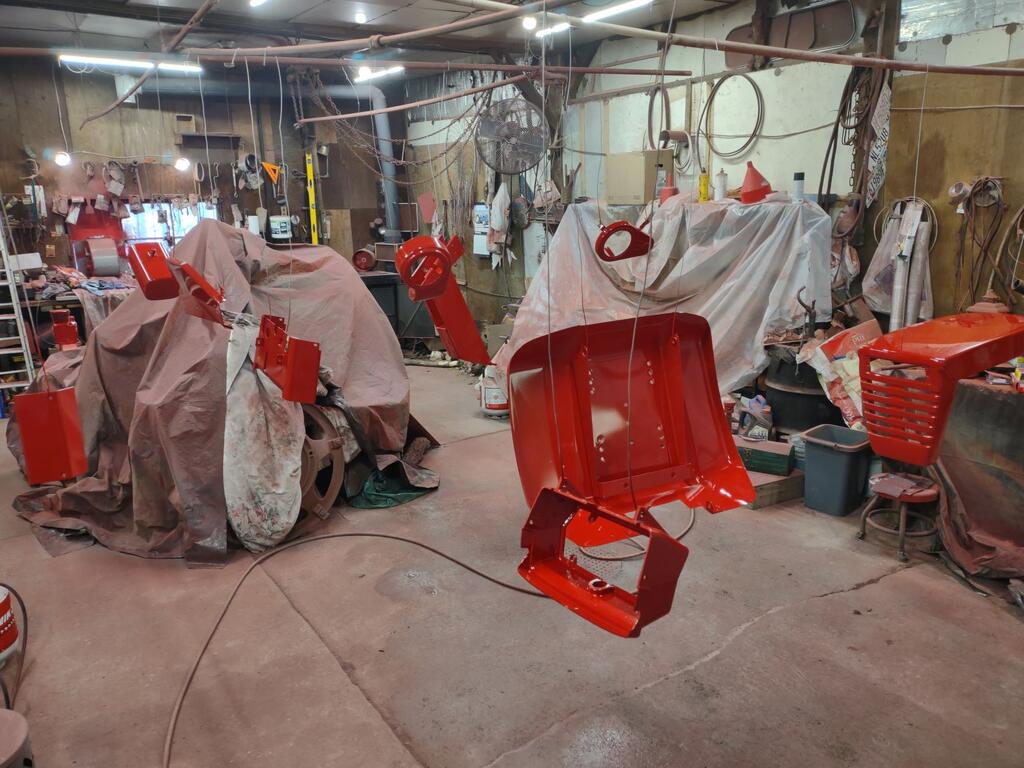

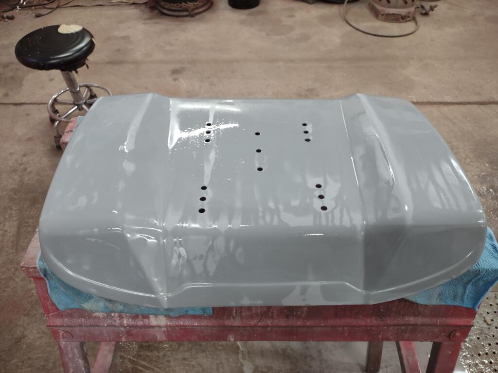

Achto 32,891 #153 Posted March 21, 2022 (edited) A weekend up date.... First I'll finish the tutorial that I started on my process of straitening sheet metal. @ebinmaine All of the parts received 1 coat of self etching primer and 3 coats of sand able filler primer, in my case this was a 2k urethane gray primer. After the primer was dry I misted a coat of red oxide primer over it as a guide coat. Now for the wet sanding. Using 400grit on a sanding block and a semi flexible sanding pad, I sanded the primer. After a few swipes you can see how the guide coat will show you what needs to be sanded out. When all of the red oxide has been sanded off, then you know that your part is completely sanded. After it dries I wipe it down with a preps all solvent, wipe it with a tack cloth and it's ready for paint. All this prep work leads to what is finally the fun part for me. Time to squirt some paint. One other good/GREAT note. My parts finally came in for my engine . I dropped the engine off at my machinist on Monday and was able to pick it up on Thursday, so I was able to paint the block today as well. Assembly time is right around the corner now. Edited March 21, 2022 by Achto 2 11 Share this post Link to post Share on other sites
857lover 291 #154 Posted March 21, 2022 On 3/20/2022 at 8:45 PM, Achto said: One other good/GREAT note. My parts finally came in for my engine . I dropped the engine off at my machinist on Monday and was able to pick it up on Thursday, so I was able to paint the block today as well. Assembly time is right around the corner now. that engine is looking so fresh!! 1 1 Share this post Link to post Share on other sites
oliver2-44 11,791 #155 Posted March 21, 2022 10 hours ago, Achto said: All of the parts received 3 coats of sand able filler primer, in my case this was a 2k urethane gray primer. When you say 3 coats do I understand that to mean 3 full wet coats plus you initial tack coat and 2nd partial coat. 1 Share this post Link to post Share on other sites
Achto 32,891 #156 Posted March 21, 2022 (edited) 19 minutes ago, oliver2-44 said: When you say 3 coats do I understand that to mean 3 full wet coats 3 full wet coats, then a light mist of red oxide primer out a spray can after it dries for the guide coat. It did get one coat of self etching primer before the 3 coats of urethane was applied. Edited March 21, 2022 by Achto 2 1 Share this post Link to post Share on other sites

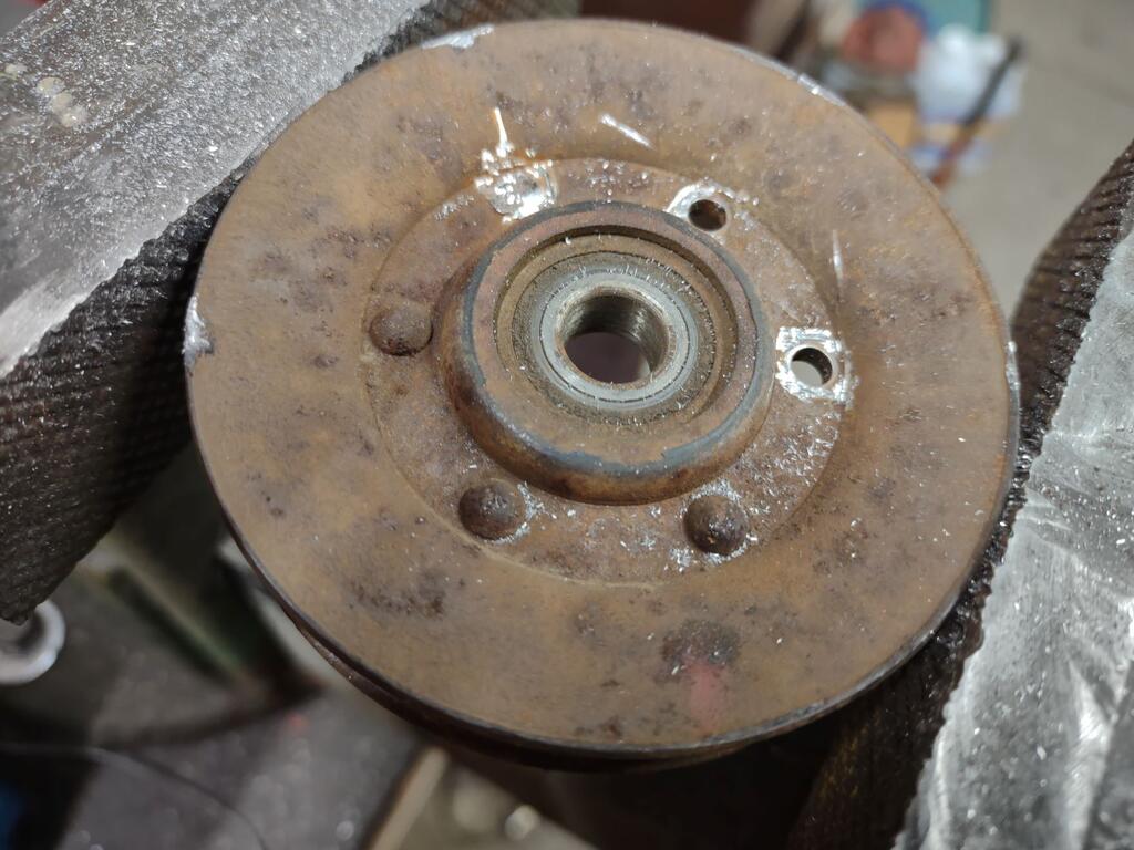

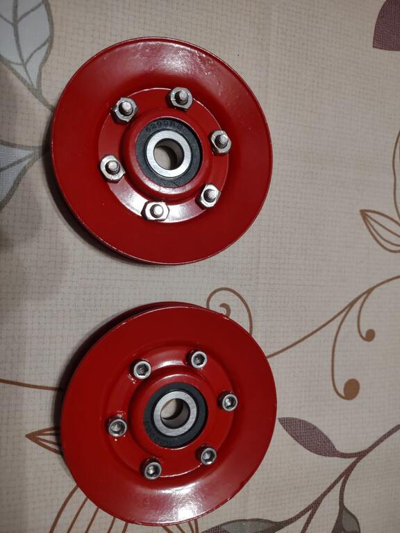

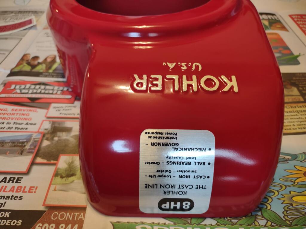

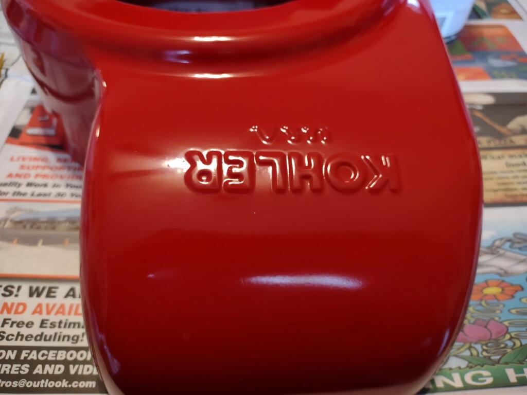

Achto 32,891 #157 Posted March 25, 2022 Been doing a little tinkering this week. The pullies that I took apart earlier now have some new paint, bearings, and have been put back together. Allen head 8-32 bolts fit nicely in the groove of the pulley. Had to grind 2 sides of the nuts down so they would fit in the groove. A little red Loctite ensures that they will not come loose. The new paint on the fan shroud is was dry enough to add the finishing touches. A little hand lettering and the decal makes it almost complete. Still need to rivet name plate on. 1 13 Share this post Link to post Share on other sites

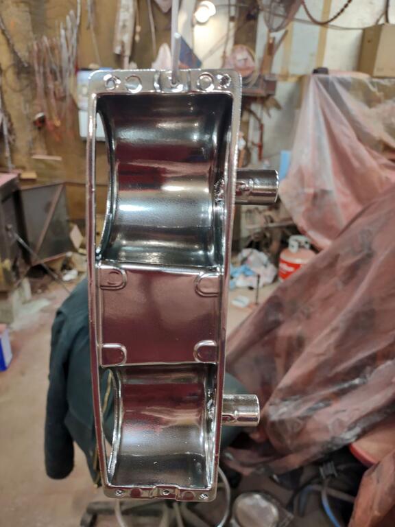

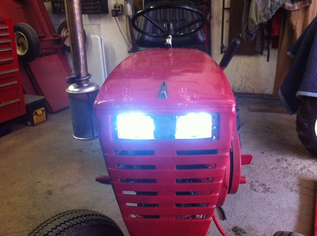

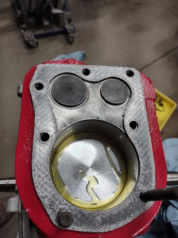

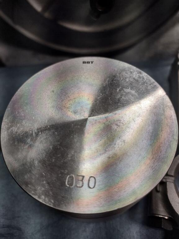

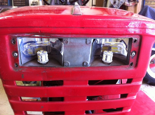

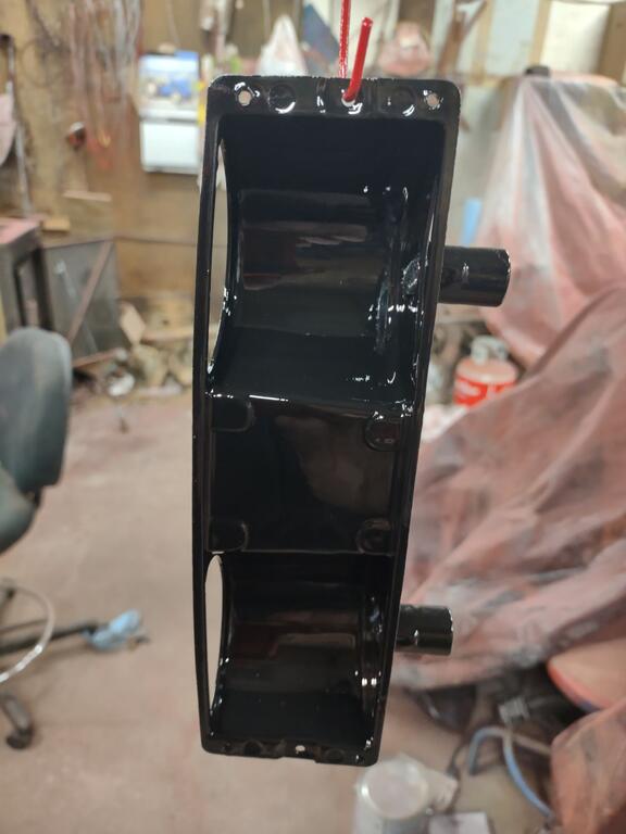

Achto 32,891 #158 Posted March 27, 2022 (edited) Black head light bucket???? Well that ain't right. No worries, I haven't lost my mind. YET! I painted it black with a urethane clear coat about a week ago. Why?? This was done so that it could end up looking like this. After the black had cured for a week, then I sprayed it with Moto Chrome paint. If you look at my hook that was red in the first pic, you see how the black changes the out come of the chrome paint. Hoping that with a chrome-ish back ground that the lights may be brighter. ( I think that the factory lights are only slightly better than holding a candle in front of you while you drive ) With any luck the chrome paint and the high out put LEDs will be an improvement. @WHX?? stopped by to drop some parts off for me to work on and ended up hanging out to help me put my engine together. Good thing too, as he caught me making a couple of mistakes. When we were unwrapping parts Jim noticed that some how @ebinmaine's chief mechanic must be endorsing the piston that I'm using. She even has her initials engraved on them. A fresh cylinder & piston with a nice drizzle of Lucas pic. Always easy on the eyes. Knocked off for the day with the engine mostly sealed off to the elements. There were a few trinkets that I forgot to paint so I have to wait for them to dry before I finish buttoning things up. Edited March 27, 2022 by Achto 2 10 1 Share this post Link to post Share on other sites
oliver2-44 11,791 #159 Posted March 27, 2022 Very nice, I'm certainly interested to hear how that moto chrome works out! Since your almost done, can I drop a couple of engines needing rehab off at your place! 4 1 Share this post Link to post Share on other sites
ebinmaine 81,048 #161 Posted March 27, 2022 8 hours ago, Achto said: With any luck the chrome paint and the high out put LEDs will be an improvement Absolutely will help. On Trina's main worker 867 Pigpen she sprayed the headlamp bucket Bright Copper (partially to get a brighter background and partially to match the front weight bracket). Definitely a noticable difference. 2 Share this post Link to post Share on other sites
rjg854 13,408 #162 Posted March 27, 2022 You must already know that the LED bulbs a vast improvement over the original incandescent bulbs 3 Share this post Link to post Share on other sites

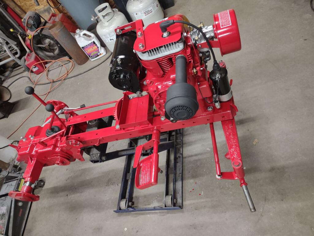

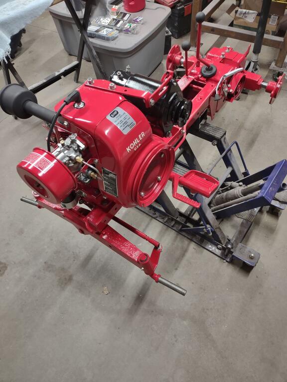

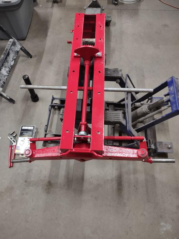

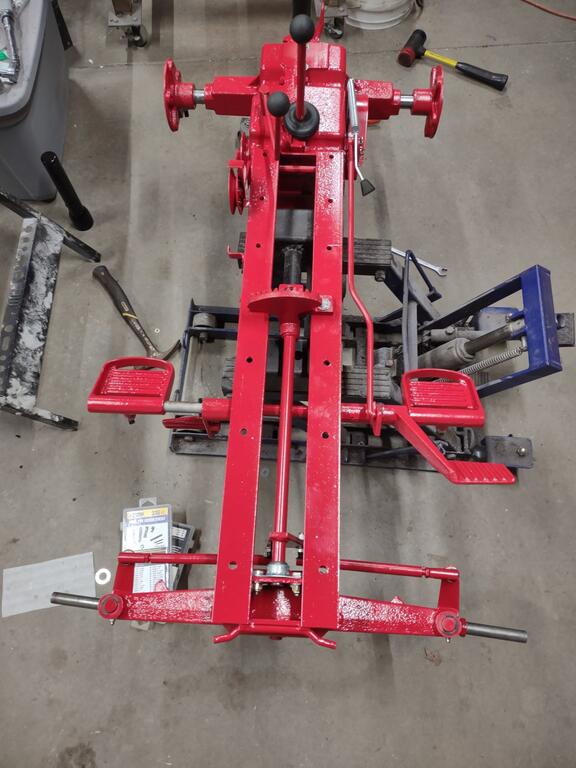

Achto 32,891 #165 Posted March 28, 2022 (edited) Made some good progress today. Finished the engine up this morning. With that done I moved on to throwing a few pieces together on the chassis. Got this far on it & had to quit for the day. Edited March 28, 2022 by Achto 12 1 Share this post Link to post Share on other sites
kpinnc 19,036 #166 Posted March 28, 2022 Very nice! 2 1 Share this post Link to post Share on other sites
WHX?? 58,324 #167 Posted March 28, 2022 (edited) 13 hours ago, Achto said: Got this far on it Yer makin a monkey out of all of us! So what you started this on 2/12 and its this far already?!?!? Told you guys he gets tunnel vision on a resto! Is that the original muffler Dan? Looks to be one of those 1" small pepper pot unobtaniums? Edited March 28, 2022 by WHX?? 3 1 Share this post Link to post Share on other sites
Achto 32,891 #168 Posted March 28, 2022 24 minutes ago, WHX?? said: So what you started this on 2/12 and its this far already?!?!? Told you guys he gets tunnel vision on a resto! Is that the original muffler Dan? Looks to be one of those 1" small pepper pot unobtaniums? Started on 2/12. I'm running behind, was hoping for a 4 to 6 week turn around. Yes, that's the original muffler, one of the harder ones to get. It rattles a little bit when you shake it. If that happens while its running, I'll take it back off & see if I can tack weld the baffle some how. 2 2 Share this post Link to post Share on other sites
TJ5208 1,841 #169 Posted March 28, 2022 Why not a stack. 1 Share this post Link to post Share on other sites
WHX?? 58,324 #170 Posted March 28, 2022 3 minutes ago, Achto said: see if I can tack weld the baffle some how. If not I have a large diameter tubing cutter. Cut it apart re-gizzard it and weld it back together? Wouldn't be for lack of trying to save it. All of my '67s have the large pepper pot which of course are aplenty but I just like them small ones with a 1" inlet. 2 2 Share this post Link to post Share on other sites
WHX?? 58,324 #171 Posted March 28, 2022 1 minute ago, TJ Salyers said: Why not a stack. Originality TJ and me thinks Dan has enough tractors that are "stacked" in his favor! 2 Share this post Link to post Share on other sites
Achto 32,891 #172 Posted March 28, 2022 2 minutes ago, TJ Salyers said: Why not a stack. Staying closer to original with this one. Specially seems I already have the original muffler. I had to find a muffler like this one for my 701. It was one of the more pricey items on that build. 4 Share this post Link to post Share on other sites
