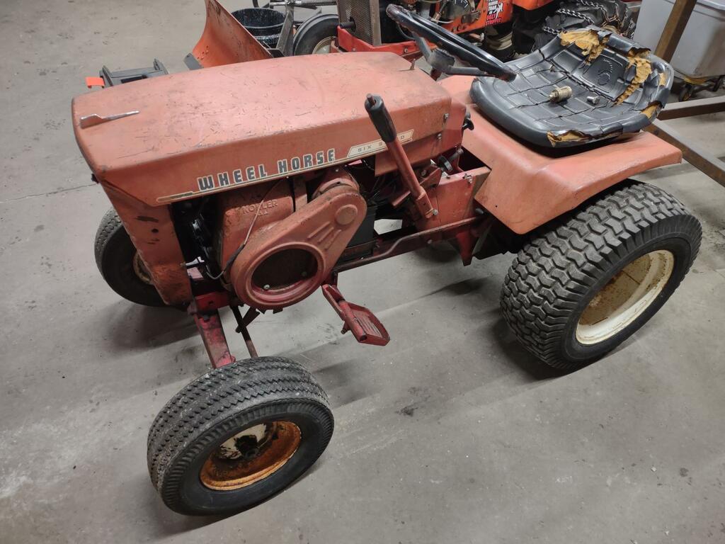

Snoopy11 5,731 #39 Posted February 14, 2022 23 hours ago, Achto said: Ain't that seat purty? Anthropomorphic beagle present. That seat... sure isn't purty... but does look familiar. IT LOOKS IDENTICAL TO MY 800 SPECIAL SEAT. Rips and all... That went bye-bye pretty quick-like. Don 1 Share this post Link to post Share on other sites
Snoopy11 5,731 #40 Posted February 14, 2022 I don't want to take up too much room in your thread, @Achto... but are you planning on doing a frame-off resto on this one? Don 1 Share this post Link to post Share on other sites
Achto 32,480 #41 Posted February 14, 2022 22 hours ago, kpinnc said: If I put a laughy face reaction to that, does that prove just how old I am? It just makes you a connoisseur of classic music, that's all. 2 1 Share this post Link to post Share on other sites

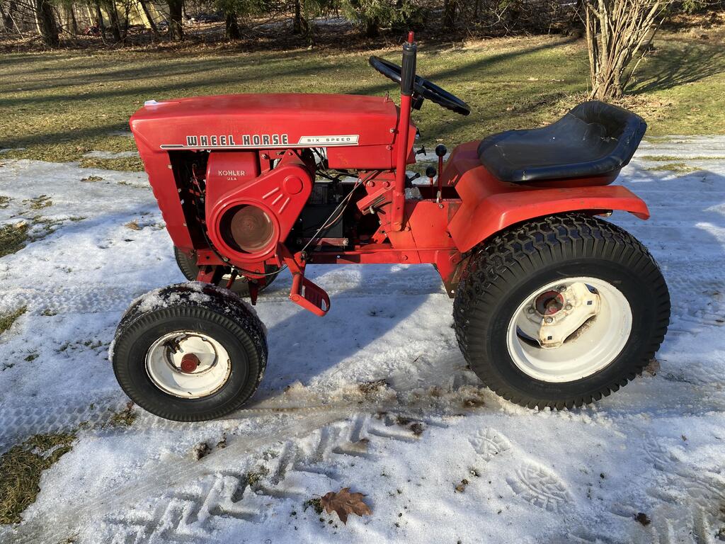

Achto 32,480 #42 Posted February 14, 2022 10 hours ago, rjg854 said: Dan, will this tractor get a $900 paint job Not this one. Stock factory legit & no other BS. Well as close as I can get any way. 3 Share this post Link to post Share on other sites
Achto 32,480 #43 Posted February 14, 2022 1 hour ago, Snoopy11 said: I don't want to take up too much room in your thread, @Achto... but are you planning on doing a frame-off resto on this one? Frame off plus a lot more. 4 2 Share this post Link to post Share on other sites

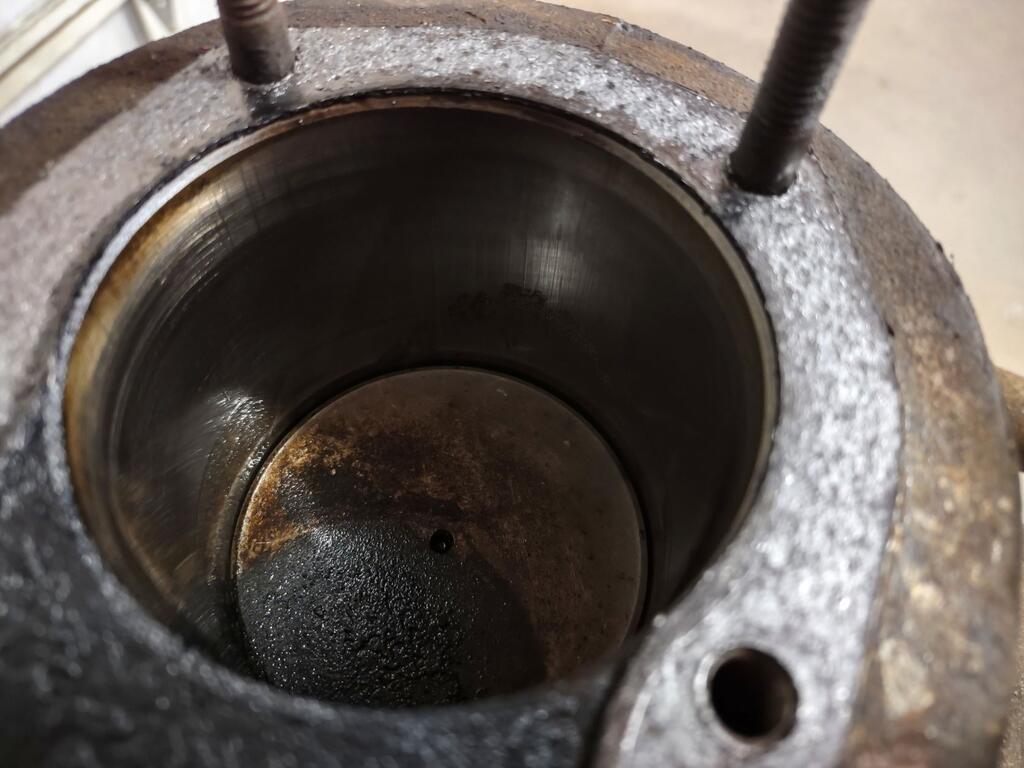

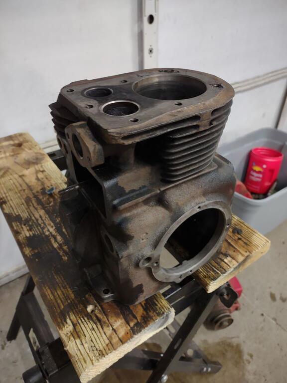

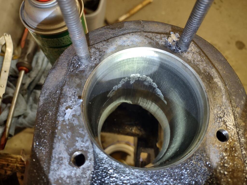

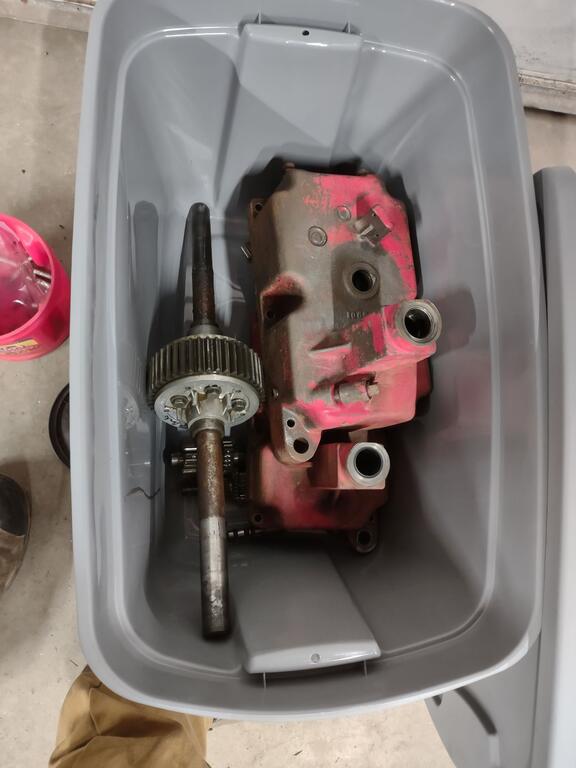

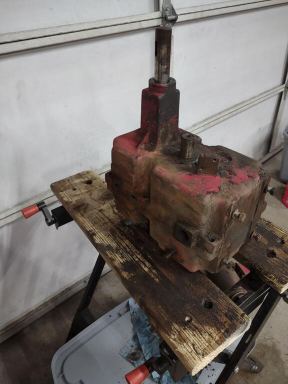

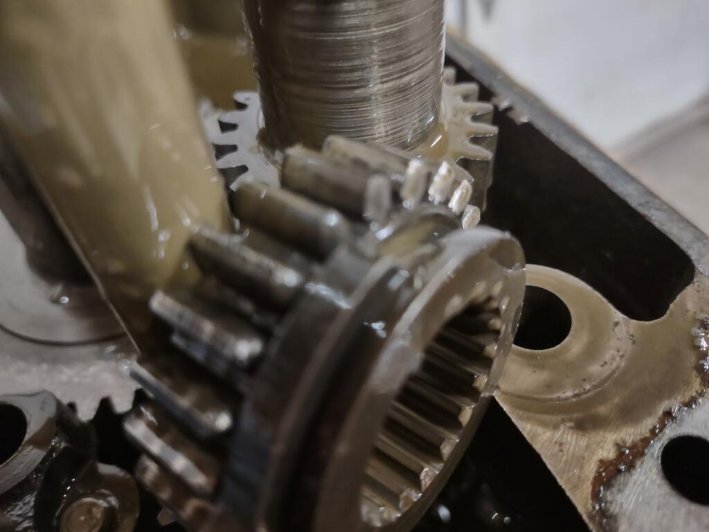

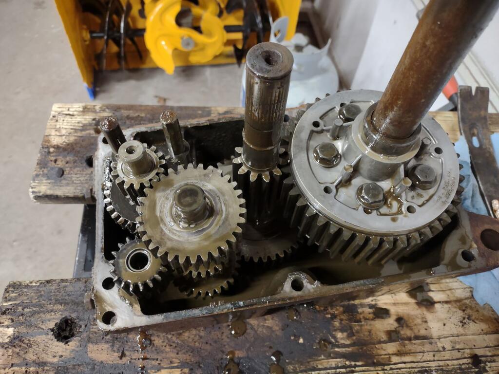

Achto 32,480 #45 Posted February 14, 2022 (edited) Todays fun adventures. I ended up finding some kinda good news and some not so good news. I'll start with the good news. I cracked open the tranny to see how much damage the water had done. Pleasantly surprised when I opened it up. As I suspected, I don't think the water has been in the transmission very long. The water did lead me to open it up though and I did find a couple of gears that I will want to replace. Every thing has been degreased and is patiently waiting for some seals, a couple of bearing and a couple of gears. The not so good. I pulled the head to de-carbon it and see what kind of shape the cylinder was in. Well with this amount of piston wash it would need a re-ring job at the very least. Then I pulled the piston to find this nice little surprise inside of the cylinder. After taking measurements, here are the results that I came up with. The bore measures up well, less than .001" variance in the bore but the rough spot will have to be machined out. Will have to go at least .010" over to fix that issue. Measured the crank pin only to get more disappointments. The crank pin is .003" out of round. Sooo, that will have to be turned down to fit a .010 under sized rod. I have the block stripped down and it is patiently waiting for parts and a trip to the machine shop. A few disappointment's today but I won't let them get me down. The build must go on. Edited February 14, 2022 by Achto 9 8 Share this post Link to post Share on other sites

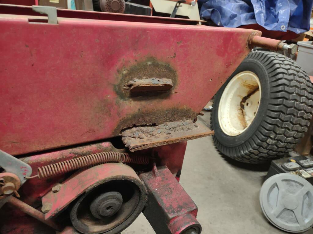

WHX?? 57,904 #46 Posted February 14, 2022 Any idea what might have possessed somebody to do this? I sure can't figure it out. 4 Share this post Link to post Share on other sites
Achto 32,480 #47 Posted February 14, 2022 1 minute ago, WHX?? said: Any idea what might have possessed somebody to do this? There was some sort of a hitch welded on there. I cut it off right after I got the tractor, had for got about the remnants until I took it apart. 3 1 Share this post Link to post Share on other sites
ebinmaine 80,461 #48 Posted February 14, 2022 Is it like that on the other side of the sheet metal on the other side of the tractor? 2 Share this post Link to post Share on other sites
TJ5208 1,841 #49 Posted February 14, 2022 1 minute ago, Achto said: There was some sort of a hitch welded on there. I cut it off right after I got the tractor, had for got about the remnants until I took it apart. Wow that's somewhere to put a hitch it may be quite effective but on That metal may not. 2 Share this post Link to post Share on other sites
Achto 32,480 #50 Posted February 14, 2022 2 minutes ago, ebinmaine said: Is it like that on the other side of the sheet metal on the other side of the tractor? Yep, same stuff on the other side. 3 Share this post Link to post Share on other sites
