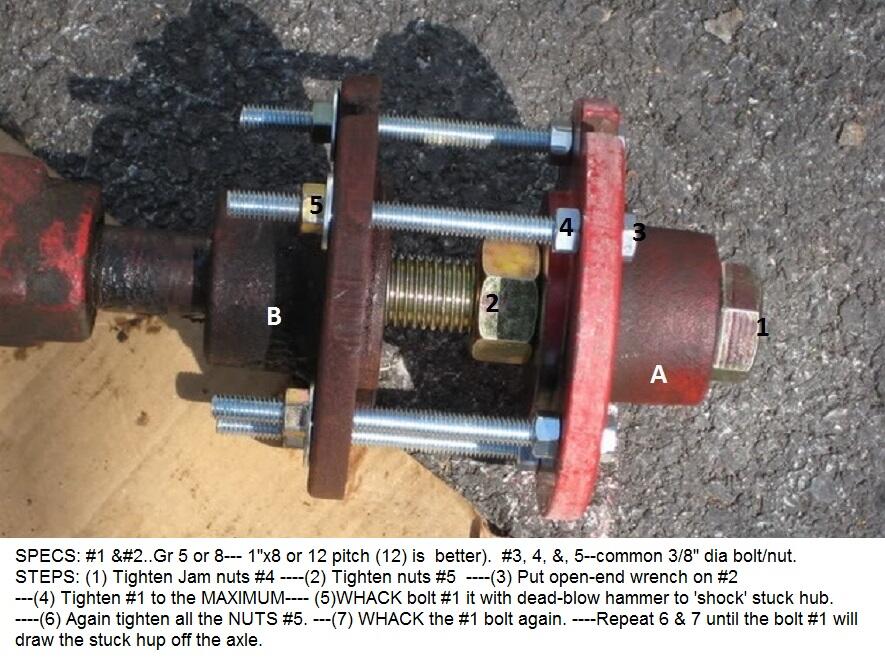

JCM 11,253 #26 Posted February 11, 2022 Is this set-up used along with heat ?. Also do you mind giving up the grade, and sizes of the hardware used. Looks nice and I would like to have one on standby. Thank You @daveoman1966 1 Share this post Link to post Share on other sites

ebinmaine 79,552 #28 Posted February 11, 2022 2 hours ago, JCM said: Is this set-up used along with heat ?. Also do you mind giving up the grade, and sizes of the hardware used. Looks nice and I would like to have one on standby. Thank You @daveoman1966 Jim if you get yourself into a hitch, remember I've got that 20-ton press now. You're welcome to use that absolutely anytime. 1 Share this post Link to post Share on other sites
daveoman1966 3,884 #29 Posted February 11, 2022 (edited) On 2/11/2022 at 6:15 AM, JCM said: Is this set-up used along with heat ?. Also do you mind giving up the grade, and sizes of the hardware used. Looks nice and I would like to have one on standby. Thank You @daveoman1966 I did not have to use heat. The Big bolt & Nut (1 & 2) are grade 5 (or 8) 1" dia 8-thread... but 12-thread may work better. The other 5 nuts & bolts are just 3/8" geneeral purpose...nothing special. Don't forget to WHACK the head of bolt "1" each time. I've re-written the text in this pic...more descriptive of 'how to'. Edited February 12, 2022 by daveoman1966 1 1 1 Share this post Link to post Share on other sites
ebinmaine 79,552 #30 Posted February 12, 2022 22 hours ago, daveoman1966 said: I did not have to use heat. The Big bolt & Nut (1 & 2) are grade 5 (or 8) 1" dia 8-thread... but 12-thread may work better. The other 5 nuts & bolts are just 3/8" geneeral purpose...nothing special. Don't forget to WHACK the head of bolt "1" each time. Dave and I understanding correctly that the nuts #2 and #4 are there only to hold the assembly together during set-up? I see the directions state to loosen #4. Why is that? Do they bind? How about nut #2? Thanks... Share this post Link to post Share on other sites
daveoman1966 3,884 #31 Posted February 12, 2022 2 hours ago, ebinmaine said: Dave and I understanding correctly that the nuts #2 and #4 are there only to hold the assembly together during set-up? I see the directions state to loosen #4. Why is that? Do they bind? How about nut #2? Thanks... I've re-written the pic description...here is a more clear description of 'how to'.. 1 Share this post Link to post Share on other sites
