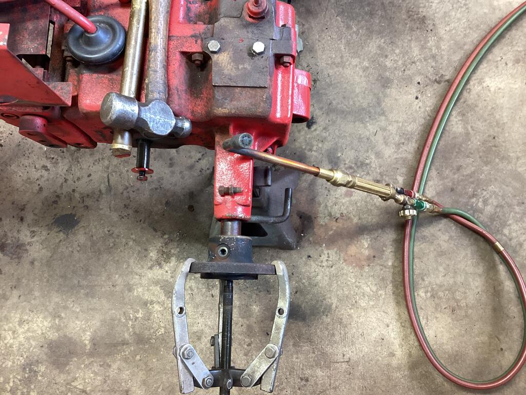

41chevy 74 #1 Posted February 10, 2022 (edited) I’m looking for suggestions, I’ve fooled with this for 2 days with no luck. I’ve put what I think is more than enough heat on this hub 3 times with the puller loaded as much as I dare, Tried beating on it with brass drift hot and cold, soaked in WD 40. It hasn’t moved a fraction off or on one bit. Thanks Steve Edited February 10, 2022 by 41chevy Add pic Share this post Link to post Share on other sites
ebinmaine 78,353 #2 Posted February 10, 2022 This is the thread I reference as a go-to for pulling hubs. Scroll down some and you'll see a bunch of great ideas. Biggest thing to remember is do NOT use a three-jaw puller. 2 Share this post Link to post Share on other sites
pfrederi 20,295 #3 Posted February 10, 2022 I see one set screw. many of these newer hubs had a second set screw 90 degrees off. Is there a sheared off one still in there? 1 Share this post Link to post Share on other sites
peter lena 9,851 #4 Posted February 10, 2022 @41 CHEVY , 3 jaw pulley is not solid enough , a strong back flange and a small hydraulic piston on shaft end will do it , pete 1 Share this post Link to post Share on other sites

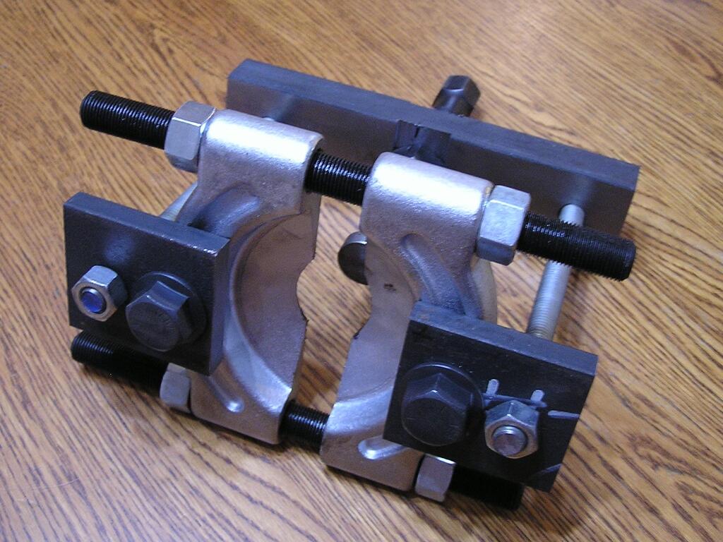

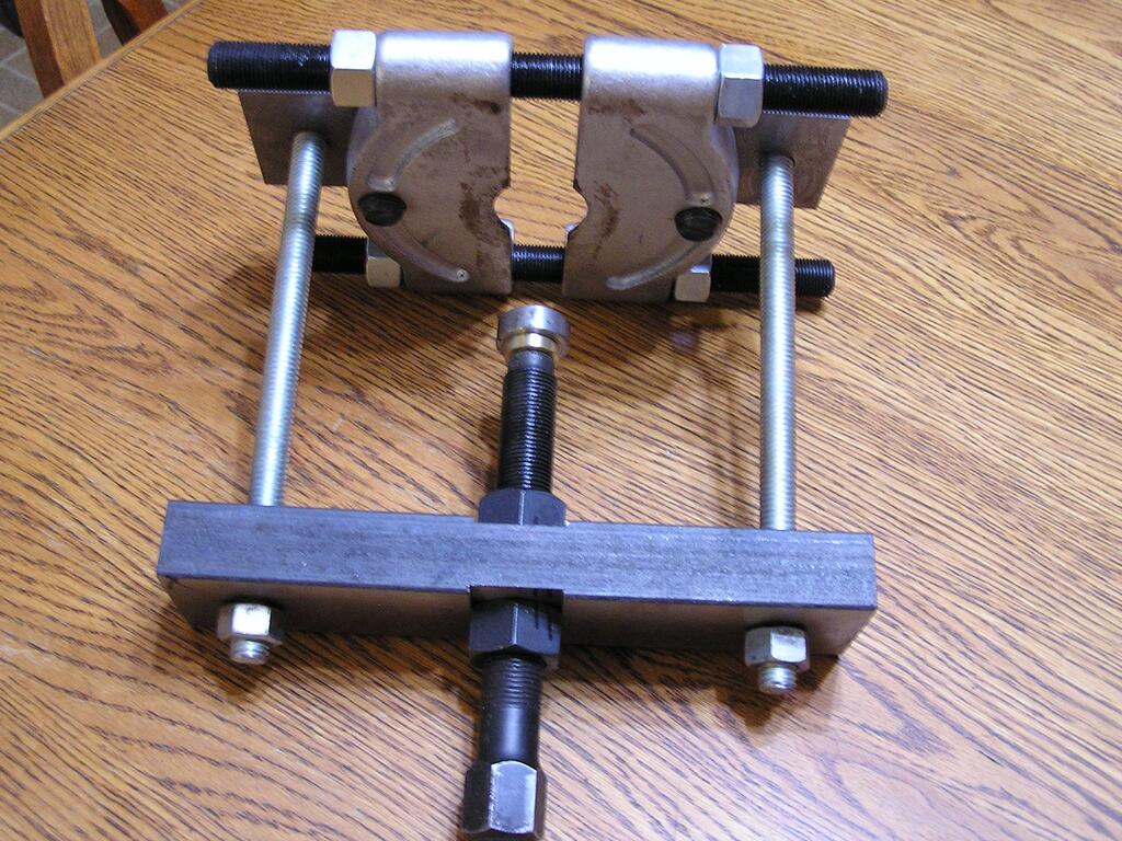

Achto 31,617 #6 Posted February 10, 2022 6 minutes ago, 41chevy said: I’ll make a puller to pull from the hub back. One like this is usually effective. 1 2 Share this post Link to post Share on other sites

ebinmaine 78,353 #11 Posted February 10, 2022 3 minutes ago, Brockport Bill said: Like 41chevy - - last yr i tried for a week to remove hubs with 3 puller, plus map gas heat, plus penetrant etc -- and rubber mallet - - nothing worked - finally had to take it to a shop Another reference point for why you should never use a three-jaw puller is that I've been told it will squeeze in on the diameter of the hub which is only making it tighter on the axle. Situations like yours is one of the multitudes of justifications I used to go out and spend some money on a 20-ton press. Share this post Link to post Share on other sites

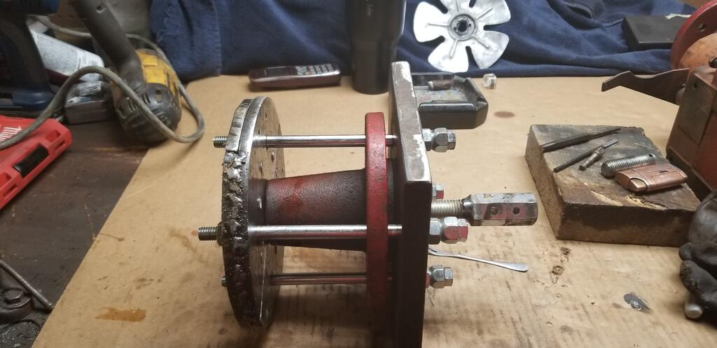

ri702bill 11,884 #14 Posted February 10, 2022 51 minutes ago, Achto said: One like this is usually effective Effective, indeed. Made this one last year as I posted before. Used the HF Large Bearing Separator, had the Snap-on fine pitch screw, made the rest. As others had noted in prior posts, smack the hub or puller while using it - the shock from the impact helps loosen it. A been there, done that tip - position the keyway at the 12 o'clock position, remove the 3/8" setscrew completely and flood the hole in the hub with penetration oil - FIRST! 3 3 Share this post Link to post Share on other sites

Jeff-C175 7,207 #17 Posted February 10, 2022 3 hours ago, ri702bill said: Made this one Bill, when using it, did you notice if the bolts on the bearing splitter were wanting to bend? Would this be a possible improvement on the design? Share this post Link to post Share on other sites

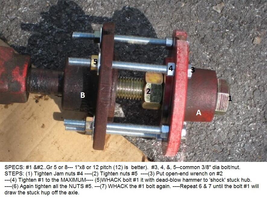

gt14rider 1,158 #23 Posted February 11, 2022 Pulls from back. 2 Share this post Link to post Share on other sites

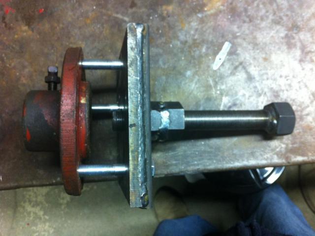

daveoman1966 3,882 #24 Posted February 11, 2022 (edited) Thius hasn't failed me yet... Edited February 12, 2022 by daveoman1966 3 Share this post Link to post Share on other sites
ri702bill 11,884 #25 Posted February 11, 2022 12 hours ago, Jeff-C175 said: Bill, when using it, did you notice if the bolts on the bearing splitter were wanting to bend? Would this be a possible improvement on the design? @Jeff-C175 No, the hardened shafts worked fine. Yes, it would be an improvement, similar to the puzzle disk that @gt14rider shared above. Bill 1 Share this post Link to post Share on other sites
