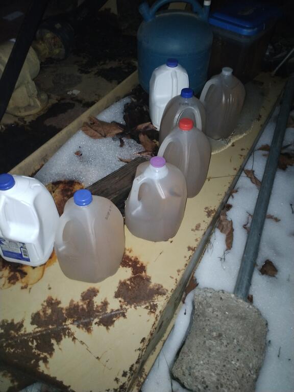

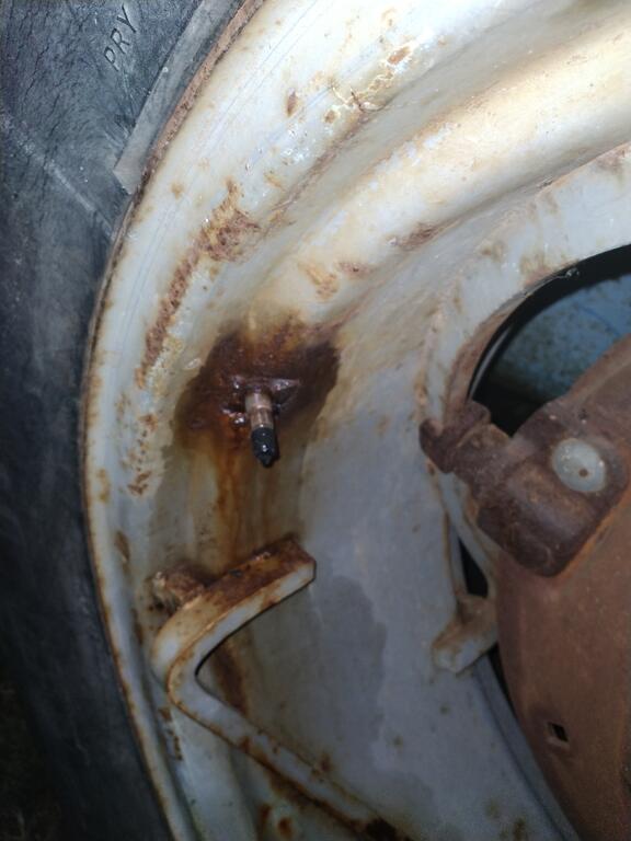

TJ5208 1,841 #1 Posted February 9, 2022 You guys think I should fill these tires. All four tires have tubes. I have me a good source of calcium chloride my dad's bigger tractors is leaking it out and I've just been collecting it we can't really stick it back in the bigger tractor because it's leaking it out I know the pros and cons of calcium chloride I just want your opinions on if these tires are well suited to try to weigh down. 1 Share this post Link to post Share on other sites

pfrederi 21,096 #5 Posted February 9, 2022 1 minute ago, TJ Salyers said: Well atleast my tractor has tubes but I always check on my tires before I even drive it. I could probably tell if it was leaking. Your Dad's tractor had tubes also. they didn't put calcium in tubeless tires. it would eat through rims in short order.... 3 1 Share this post Link to post Share on other sites

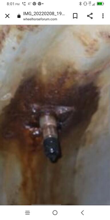

TJ5208 1,841 #6 Posted February 9, 2022 Just now, pfrederi said: Your Dad's tractor had tubes also. they didn't put calcium in tubeless tires. it would eat through rims in short order.... If it had tubes you couldn't unscrew the valve stem and look in the tire I'm going to go grab a picture so you can see what I'm talking about. 1 Share this post Link to post Share on other sites
TJ5208 1,841 #7 Posted February 9, 2022 Here's some pictures Share this post Link to post Share on other sites
TJ5208 1,841 #8 Posted February 9, 2022 So what you guys are saying is I should use washer fluid. Share this post Link to post Share on other sites
Achto 32,510 #9 Posted February 9, 2022 (edited) 19 minutes ago, TJ Salyers said: So what you guys are saying is I should use washer fluid. You will get a unanimous vote for washer fluid or rim savor on this forum. Calcium chloride will eventually leak and eat your rims. Trust us, we've all seen the effects. As for your dad's tractor I will guarantee that there are tubes in those tires. A - that valve stem is for a tube. B - I have not encountered too many rear tractor tires that were not tubed. Specially that vintage. C - if it didn't have tubes, those rims would have been long gone by now. Note: I would pull that tire off, clean and repaint the inside of the rim, replace the tube while you still have a rim. I've had to replace many rims because of a calcium chloride leak. 30 minutes ago, TJ Salyers said: Edited February 9, 2022 by Achto 3 Share this post Link to post Share on other sites
TJ5208 1,841 #10 Posted February 9, 2022 You can unscrew the valve stem off of it and then there's some threads that stick out and the liquid comes pouring out of it not trying to argue with anybody but I'm just trying to make a statement. 2 Share this post Link to post Share on other sites
Achto 32,510 #12 Posted February 9, 2022 Looks like this valve stem. 3 Share this post Link to post Share on other sites
TJ5208 1,841 #13 Posted February 9, 2022 Well that makes me look dumb Share this post Link to post Share on other sites
TJ5208 1,841 #14 Posted February 9, 2022 I guess I'll try to get some washer fluid even though this calcium chloride weighs a lot more that's the only reason I really wanted it. Share this post Link to post Share on other sites

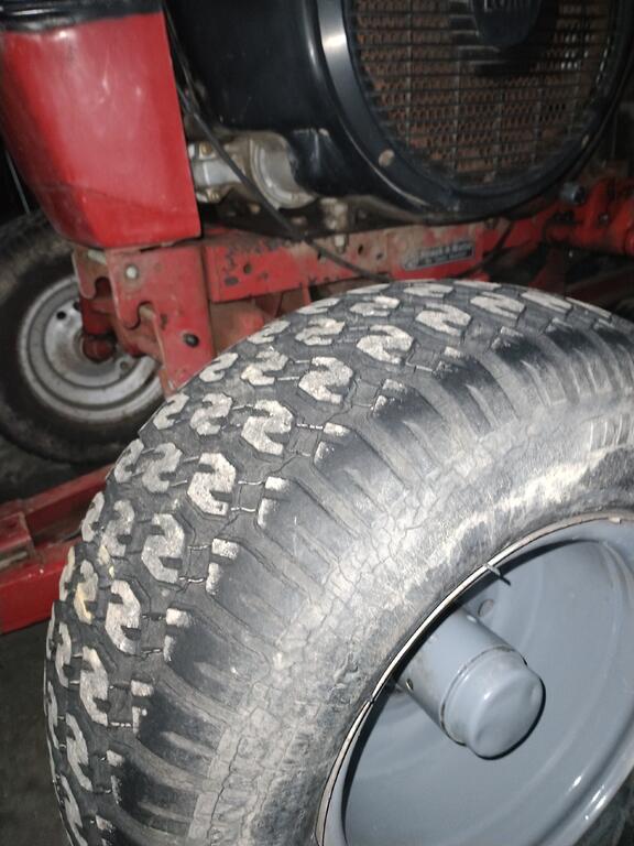

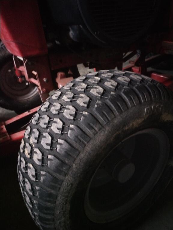

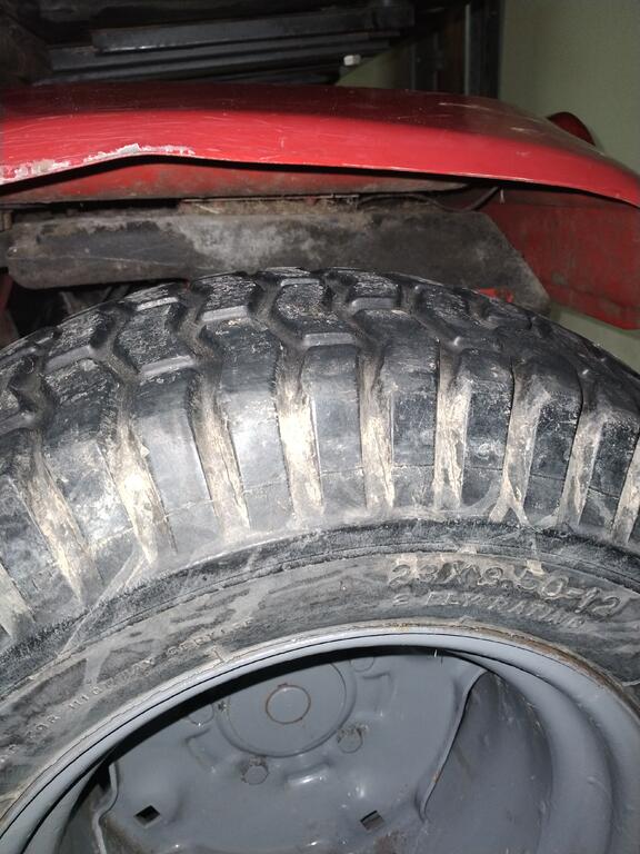

TJ5208 1,841 #17 Posted February 9, 2022 Here another question do the treads on the tire even look fit to even try to spend money on. Because I don't want to go buying a bunch of stuff for the tires and they be no good. 1 Share this post Link to post Share on other sites
Ed Kennell 47,119 #18 Posted February 9, 2022 Both are worn out and showing cracking. Put a set of chains on for traction till you get new tires and tubes. Then fill them with fluid. Come to PeeAaa in June and I'll give you chains. 2 2 Share this post Link to post Share on other sites
