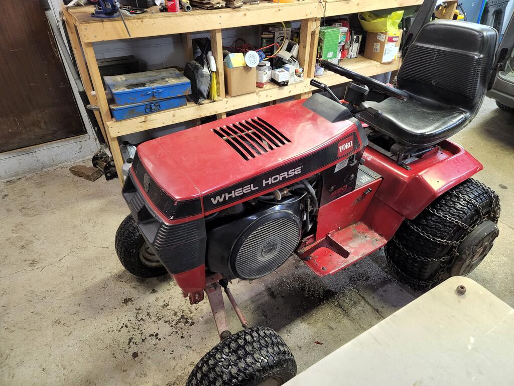

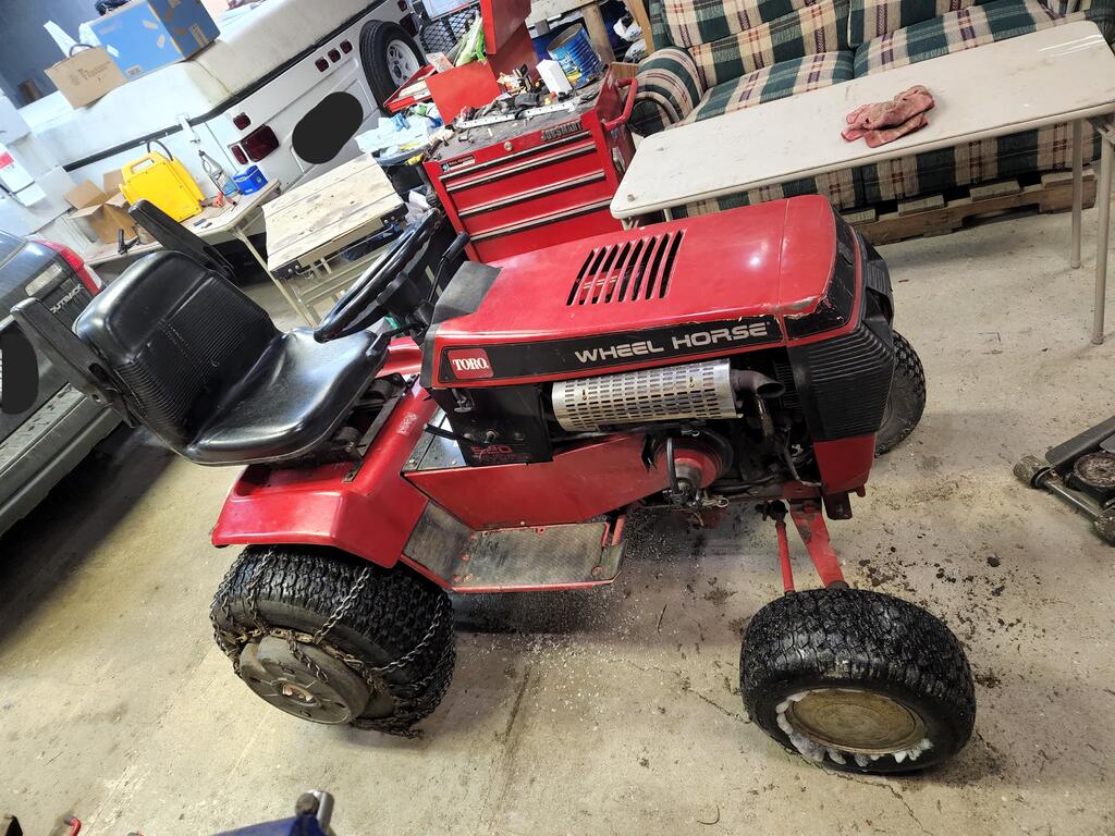

Dylan2342
The new Eaton 11 I got from eBay did the trick. I did laps around my house and checked forward and reverse. Now I can get ready to plow the next snow storm! The other benefit is I have a perfect box to package the Eaton 7 in for shipping. Oh and as you can see from the photos, the front tires are in dire need of replacing. Those are soap bubbles around the rim.
  • Excellent 4
Handy Don
LOL!
Congrats! Glad its back working for you. You're now among the Eaton experts, right?
Jeff-C175
10 hours ago, Dylan2342 said:
front tires
Can you simply tube them?  Looks like plenty of tread.
Bead leakage can often  be repaired by cleaning the bead and using bead sealer.
Edited by Jeff-C175
Dylan2342
tubing sounds like a decent plan. along with the bead there is some dry rot air bubbles elsewhere. the leaking tire and cleaning the carb are really what is left. I plan on regularly checking those hub locking screws though to prevent the axle splitting again.
  • Like 1
Jeff-C175
I thought about tubing mine but the dry rot was a problem.  There were radial cracks in both front tires about an inch from the bead that surely would have torn through with a tube inside.  Not much 'structure' left to the tires!
Sometimes it's best to just fit new tires, but if yours are leaking at the bead that badly, I wouldn't be surprised if you find a fair amount of rust inside...
