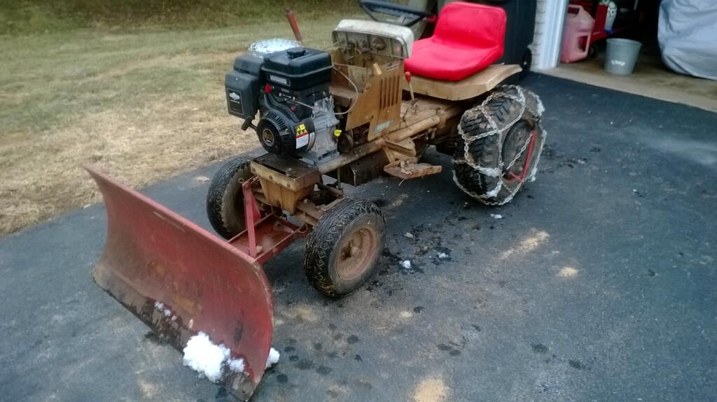

andyk 83 #11 Posted March 19, 2022 It can be done without cutting the hood, but would require some patience which I didn't have. I had a spare hood I cut up to keep the snow off. I used it for several years Share this post Link to post Share on other sites
