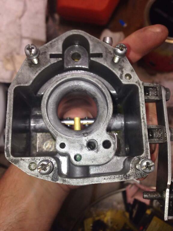

RED-Z06 2,718 #213 Posted February 15, 2022 14 minutes ago, TJ Salyers said: DEF New Carburetor Rebuild for Onan Engine P216G P218G P220G P224G OL16 OL18 OL20 LX720 LX770 LX790 B48G-GA020 B48G-GA19.9 146-0657 146-0478 146-6100 Late Nikki Performer https://www.amazon.com/dp/B07DVHQTWM/ref=cm_sw_r_awdo_navT_g_JPG7WCBXAT9EMM2ZC6RR Probably not necessary, in general onan nikki carbs come apart easy, little air and some cleaner they blow out and clean up fine...why i wish i had my original. 2 Share this post Link to post Share on other sites
TJ5208 1,841 #214 Posted February 15, 2022 1 minute ago, RED-Z06 said: Probably not necessary, in general onan nikki carbs come apart easy, little air and some cleaner they blow out and clean up fine...why i wish i had my original. Well I mean when I have to put it back together. I'll need gaskets and stuff. 1 Share this post Link to post Share on other sites
RED-Z06 2,718 #215 Posted February 15, 2022 (edited) 12 minutes ago, TJ Salyers said: Well I mean when I have to put it back together. I'll need gaskets and stuff. Doesn't hurt to have it on hand, ive never had an onan carb that the gasket was stuck to either side. I just take the 4 screws out, lift the top off, pull the float out by the hinge, blow out the bowl, aim air down the side towards thw main jet (its a huge orifice that rarely ever clogs) then blow out the pilot jet on top, its a simple carb, once the filter is off, probably 10 minutes away from being back together. Yours ran on mayonnaise...so it probably just needs to be blown out, its not likely corroded. Edited February 15, 2022 by RED-Z06 2 Share this post Link to post Share on other sites
lynnmor 8,839 #216 Posted February 15, 2022 Get a carburetor kit that contains the welch plug, many do not. Throw away the intake gaskets and get genuine Onan. Use the old float and needle if OK, but if the needle needs replaced carefully file the sharp edge off where it contacts the float to prevent it from hanging up. Toss any hose and clamps in the kit. The fuel filter will be cheap junk. Basically what you will be using is the bowl and flange gaskets, the welch plug and maybe the needle and the float. The rest is junk. 1 3 Share this post Link to post Share on other sites

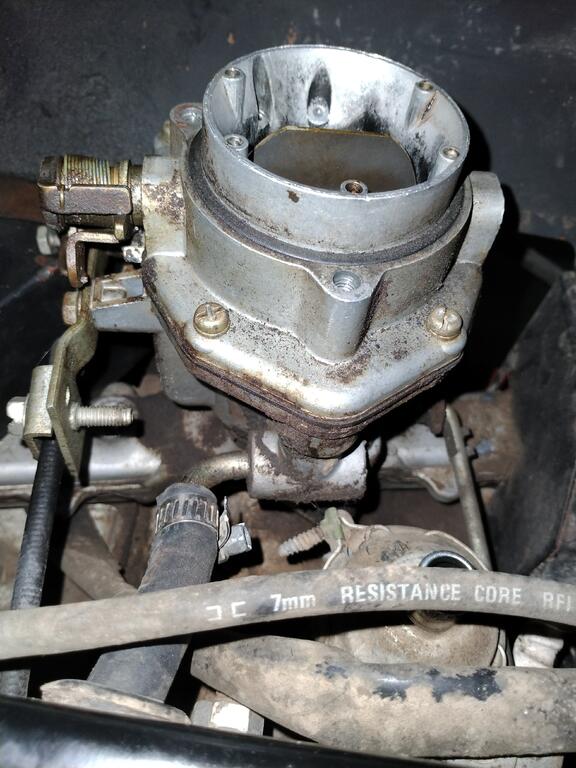

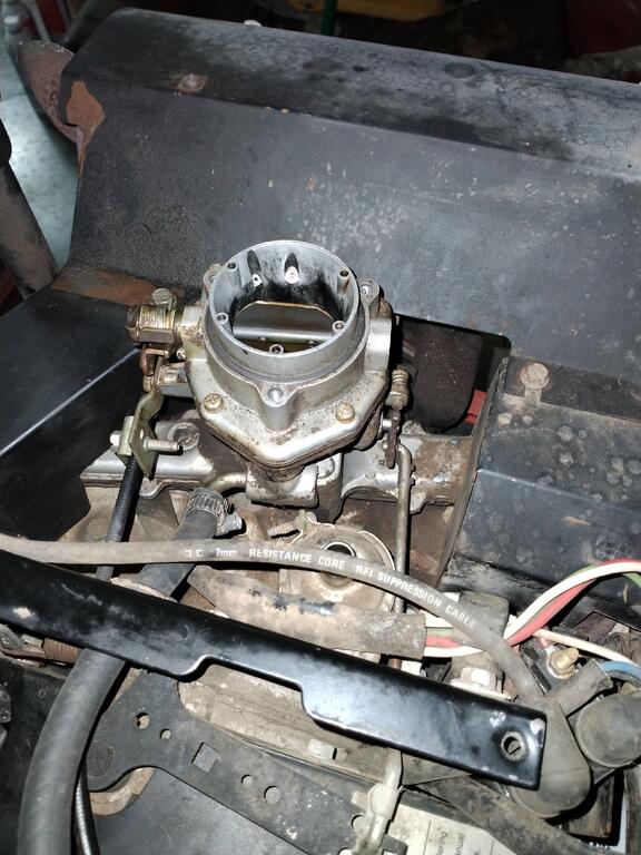

TJ5208 1,841 #217 Posted February 16, 2022 (edited) Well we tried carburetor cleaner it didn't help a bit so we're going to tear it down and rebuild the carburetor. Edited February 16, 2022 by TJ Salyers 1 Share this post Link to post Share on other sites
Achto 31,898 #218 Posted February 17, 2022 3 hours ago, TJ Salyers said: tear it down and rebuild the carburetor. At least take the top off the carb and clean the bowl out. I'm guessing that it is full of the same crap that was in the tank. 1 1 Share this post Link to post Share on other sites
TJ5208 1,841 #219 Posted February 17, 2022 16 minutes ago, Achto said: At least take the top off the carb and clean the bowl out. I'm guessing that it is full of the same crap that was in the tank. But if the crap was already in the carburetor I don't see how that could help. Share this post Link to post Share on other sites
Achto 31,898 #220 Posted February 17, 2022 2 minutes ago, TJ Salyers said: But if the crap was already in the carburetor I don't see how that could help. You can try to get a gallon of crap to go through the carb or just a couple of ounces. Was just a suggestion to try. Granted taking the whole carb apart & cleaning it would be better. Don't think that it needs to be rebuilt or replaced, usually a good cleaning does wonders. 1 Share this post Link to post Share on other sites
TJ5208 1,841 #221 Posted February 17, 2022 Just now, Achto said: You can try to get a gallon of crap to go through the carb or just a couple of ounces. Was just a suggestion to try. Granted taking the whole carb apart & cleaning it would be better. Don't think that it needs to be rebuilt or replaced, usually a good cleaning does wonders. Well cleaning is what I meant but you're going to take it all apart and put back together so that's why I said rebuild. 1 Share this post Link to post Share on other sites
RED-Z06 2,718 #222 Posted February 17, 2022 I guess i dont understand the reluctance to pull the top of the carb off and blow it out, these carbs are painfully simple, you'll spend hours trying to avoid something that takes minutes to do. 3 1 Share this post Link to post Share on other sites
TJ5208 1,841 #223 Posted February 17, 2022 4 minutes ago, RED-Z06 said: I guess i dont understand the reluctance to pull the top of the carb off and blow it out, these carbs are painfully simple, you'll spend hours trying to avoid something that takes minutes to do. So what do you mean by blow just like take the air nozzle and just blow in it or try to create pressure? Share this post Link to post Share on other sites
TJ5208 1,841 #224 Posted February 17, 2022 Is where the screws are is that the part I want to take off? Share this post Link to post Share on other sites
RED-Z06 2,718 #225 Posted February 17, 2022 Just now, TJ Salyers said: So what do you mean by blow just like take the air nozzle and just blow in it or try to create pressure? Like take a can of carb cleaner, put the straw on, blow through any hole you see, then put an air nozzle up to any holes and blow them out too. The pilot jet should unscrew and can be cleaned out manually, its the one recessed in the hole. The main is down in the bowl..just blow some air down its direction...they dont normally clog because they are huge. 2 1 1 Share this post Link to post Share on other sites
