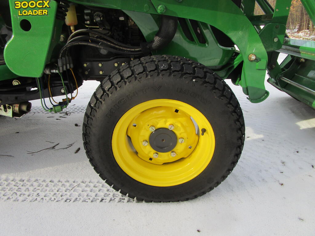

JCM 10,926 #1 Posted February 6, 2022 On a 4 wheel drive diesel tractor with a weight of just under 5000 lbs including the loader and rear weight box, would just a front set of chains help at all for traction and or steering? I have a couple places where I encounter that are off camber and could be an issue in the winter when moving snow backing up. I prefer not to use rear chains but considering front ones as I could install and remove by using the bucket to lift the front wheels off the ground. Thanks Share this post Link to post Share on other sites

c-series don 11,632 #10 Posted February 7, 2022 @JCMPersonally I wouldn’t hesitate to put chains on the front tires, as long as you’re not abusive (which judging by pictures you post of all the nice stuff you have I’m sure you are not!) I have chains for my pickup, I used to plow some really hairy driveways. On the rare occasion I put them on, and with a load of sand in the sander I could go just about anywhere! 1 Share this post Link to post Share on other sites
