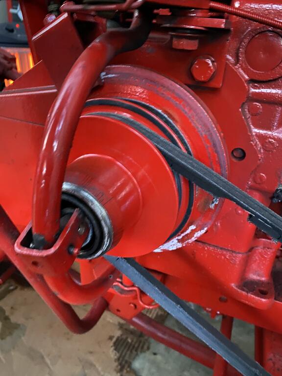

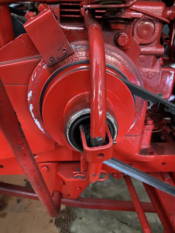

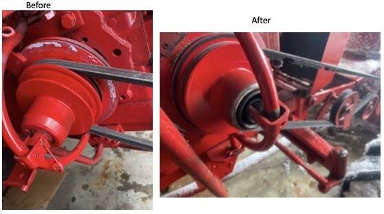

TonyBer 82 #1 Posted February 5, 2022 (edited) I was the person a few weeks ago that had to add a few threads on the PTO lever to get the clutch to engage in snow. Seemed to work fine unit today. Well I worked the machine fairly hard today in Pittsburgh and experienced PTO failure. Four driveways later I noticed the assembly damage and then the belt damage and it was extremely hot. FYI on Pictures...the first picture was from a few weeks ago and people on the forum said the belt goes on outside small pulley. When the damage happened today the belt was on the proper smaller outside pulley. I noticed after snow thrower quit working the damage done to the PTO clutch. I did get a new clutch plate from a member here and haven't installed it yet. Now, with the damage to the PTO, I'm gong to take it apart and see what happened. Any ideas? I have the cotter pin and the clip. How much damage did I do? Should I look at replacing the entire assembly? Thanks! Edited February 5, 2022 by TonyBer Share this post Link to post Share on other sites
wallfish 20,677 #2 Posted February 5, 2022 The extreme heat is most likely from the pulley bell housing slipping on the clutch material of the plate. It could also be caused by the belt slipping in the pulley but I see your groove is painted which will make that belt stick to the groove walls. Why the belt shredded is something to investigate. Change the clutch plate since you have one and it's a good idea to try and resurface the flat on pulley housing as well. The more contact surface area between the two the better it will hold. I use a belt sander to make them flat but a piece of 60 grit on a flat surface can do the same thing. Use a sharpie or marker to color the surface and the color will stay in the low spots as the high spots are sanded down. That way you can see what's going on. You can do the same with the clutch plate too. It's a good idea to re-grease the bearings as the heat may have boiled the old grease. After it's all back together adjusting the PTO engagement so it doesn't slip is important. It doesn't need to be crazy tight but you don't want it loose either. After doing this you will notice a considerable difference in the performance of the blower. 4 Share this post Link to post Share on other sites
squonk 48,217 #3 Posted February 5, 2022 Looks like your outer bearing is shot. Napa # is PP204RR6. You should have torn it all down and replaced the clutch disc and inspect the bearings like I advised in your other thread. 3 1 Share this post Link to post Share on other sites
8ntruck 9,346 #4 Posted February 5, 2022 The C shaped bracket that transfers the force from the hoop to the stub shaft in the pto bell looks a little wonky in the after picture. Check the roll pin that holds the bracket to the hoop. You will probably be replacing the bearings th the pto bell. Look at the stub shaft while it is out. If the C clip grooves in it are worn, replace the shaft. Good luck. 2 Share this post Link to post Share on other sites
Jeff-C175 7,211 #5 Posted February 5, 2022 (edited) 12 minutes ago, 8ntruck said: the C clip grooves in it are worn @TonyBer It looks like that C clip may have popped out. I've had that happen. When it does, the stub axle pushes in and the bracket contacts the bearing face and wears it down from the rubbing. Also, it looks as if the C clip that holds the OUTER part of the bearing into the PTO pulley is missing. The bearing appears to be 'out' also. Hard to tell with the small photos though... Edited February 5, 2022 by Jeff-C175 3 Share this post Link to post Share on other sites

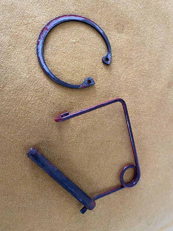

TonyBer 82 #19 Posted February 6, 2022 (edited) HI, this I the "Pin" that was in mine along with a C Clip barely hanging on before I realized what happened. Is this an appropriate Pin for my PTO setup? I included a few close pics of the PTO. Thanks. Edited February 6, 2022 by TonyBer photos Share this post Link to post Share on other sites
Lee1977 7,805 #20 Posted February 6, 2022 13 minutes ago, Jeff-C175 said: I do see that Lee, thanks. So on the straight clevis the pins are "loaded" then? The hoop does not press the end of the stub in? I don't think Toro changed back because the straight clevis was better. I think they did it because it was cheaper to make. I though I had one of each kind but I don't. My C-120 , 312-8 and 520-H all have the straight clevis. I've look through the drawings on the only 300, 400 and 500 that have 8 pinions and a 1 1/8" axle are the hydros. The 400 8 speed show 1 1/8" axles but only 4 pinions on the drawing don't know how many they put in. My guess another cost cut. Don't have a 400 and haven't seen inside there 8 speed transmission. 1 Share this post Link to post Share on other sites
Lee1977 7,805 #21 Posted February 6, 2022 (edited) 24 minutes ago, TonyBer said: HI, this I the "Pin" that was in mine along with a C Clip barely hanging on before I realized what happened. Is this an appropriate Pin for my PTO setup? I included a few close pics of the PTO. Thanks. Yes that's the right pin to the short shaft. The spiral pin holds the clevis to the PTO loop.. Edited February 6, 2022 by Lee1977 Share this post Link to post Share on other sites
Jeff-C175 7,211 #22 Posted February 6, 2022 8 minutes ago, Lee1977 said: The spiral pin hold the clevis to the PTO loop.. And from what I can see it appears that spirol pin is damaged. It doesn't look as if the pin goes all the way through and the clevis is 'hanging' on one side. I think I can see 'daylight' through the other hole where the pin should be. Either that spirol pin broke, or got worn all the way down somehow. So even if you install the new PTO assembly, you're going to have to repair that hoop and clevis also. 1 Share this post Link to post Share on other sites
Jeff-C175 7,211 #23 Posted February 6, 2022 @TonyBer That C clip you've shown is the one that holds the bearing into the end of the 'bell'. There's another C clip on the small stub that sticks out of the center of the bearing that prevents that stub from going INTO the bearing. That small clip often 'pops' out of the groove in the stub. That may be what caused your issue. Share this post Link to post Share on other sites
TonyBer 82 #24 Posted February 6, 2022 3 minutes ago, Jeff-C175 said: And from what I can see it appears that spirol pin is damaged. It doesn't look as if the pin goes all the way through and the clevis is 'hanging' on one side. I think I can see 'daylight' through the other hole where the pin should be. Either that spirol pin broke, or got worn all the way down somehow. So even if you install the new PTO assembly, you're going to have to repair that hoop and clevis also. Are you calling the Spiral Pin / Clevis same thing? Are you thinking I need to replace the hoop and pin...anything else? Share this post Link to post Share on other sites
Lee1977 7,805 #25 Posted February 6, 2022 2 minutes ago, Jeff-C175 said: And from what I can see it appears that spirol pin is damaged. It doesn't look as if the pin goes all the way through and the clevis is 'hanging' on one side. I think I can see 'daylight' through the other hole where the pin should be. Either that spirol pin broke, or got worn all the way down somehow. So even if you install the new PTO assembly, you're going to have to repair that hoop and clevis also. Yes it is pressing the the other pin into the end of the PTO bell. Share this post Link to post Share on other sites
