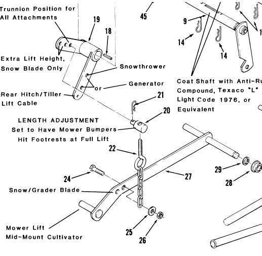

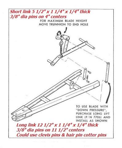

stevasaurus 23,857 #5 Posted February 3, 2022 Check out this picture to determine if you are in the right holes. If you have the star wheel adjustment, you might be able to lower that all the way and maybe raise a link or two on your chain. These will help, I also put a 2 x 4 under my blade to gain a link, but all of these will not gain you much. It seems height is around 3". 3 Share this post Link to post Share on other sites

daveoman1966 3,884 #7 Posted February 3, 2022 My C-160 Auto with hyd lift will raise the 48" dozer blade about 5" max. I also have the SOLID LINK to put down pressure on the blade. With that solid link, I can lift the front wheels 3 to 4 inches off the ground... That kind of DOWN PRESSURE is great for cutting thru hard-pack snow... 1 1 Share this post Link to post Share on other sites

ebinmaine 80,941 #9 Posted February 3, 2022 58 minutes ago, dwhjelm said: I have a 1989, 414-8 not sure what plow model is. It is a manual lift and turn blade. Using the diagram posted by @stevasaurusabove you should be able to narrow down the issue. Share this post Link to post Share on other sites

wallfish 20,673 #11 Posted February 3, 2022 3 hours ago, ebinmaine said: Dave do you find yourself constantly adjusting that or no? Don't know about Dave but there's no adjustment for a solid link. Just pins at the top and bottom for the connections. If you make one you can drill holes and use bolts with nuts and drill extra holes for adjustments if you find it necessary. 1 Share this post Link to post Share on other sites
