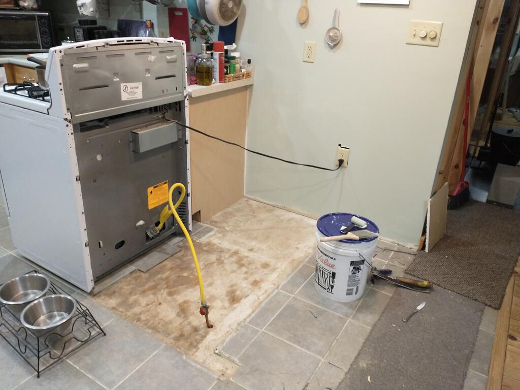

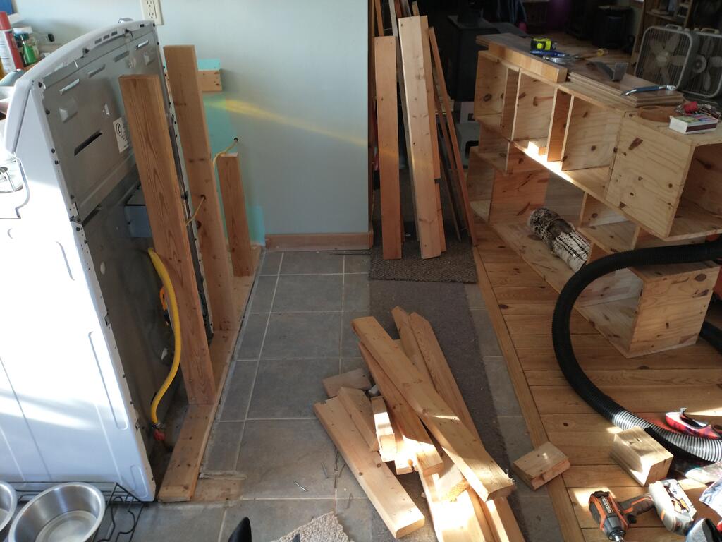

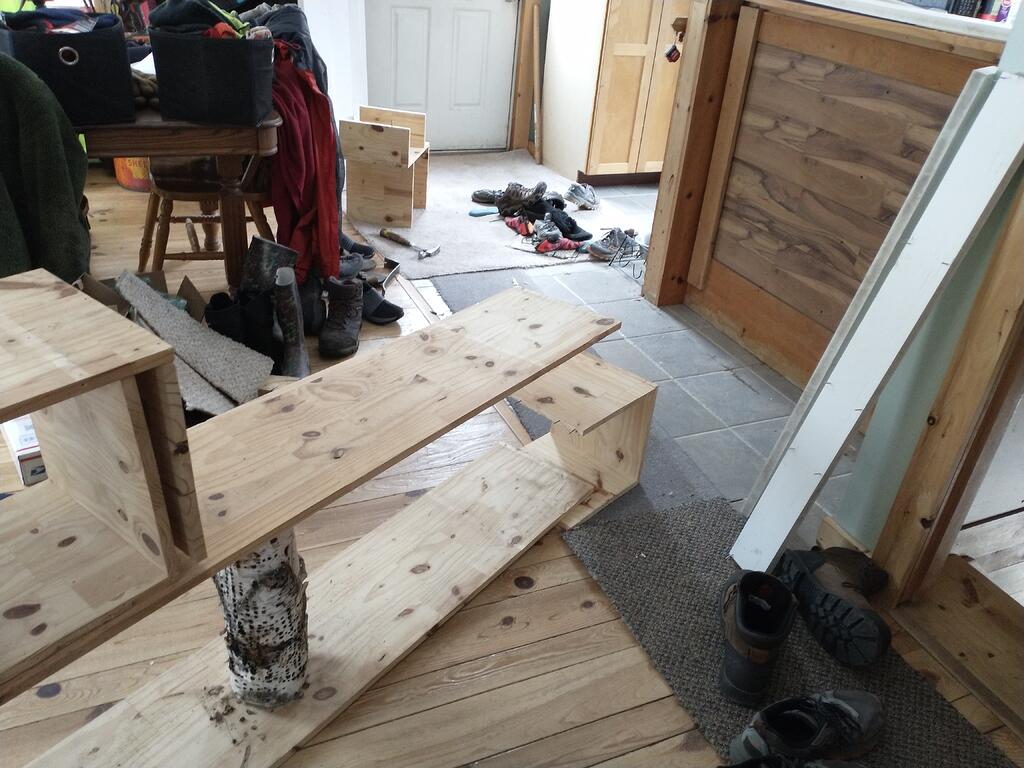

ebinmaine 79,551 #1 Posted February 3, 2022 So I get this text from Trina: I may have destroyed the kitchen!! 🤔😊 Today she decided to tear into moving the stove (over) and bar (out) of the kitchen. Here's some pics... Unfortunately we didn't think to get a true "before". You can see the bar off to the right in this shot. Partially removed. Bar gone. I'll get more pictures later. Basically on the far side of the stove as you see it there was a 2" thick butcher block section about 25 by 28. Absolutely stupid location because you couldn't even use it. We're taking the butcher block out, cutting it in half, moving the stove towards the wall, and laying out the butcher block on top of a counter sort of as a miniature bar but actual work surface this time. 7 1 Share this post Link to post Share on other sites

JCM 11,253 #3 Posted February 3, 2022 Don't tell me someone in that household is bored. Must be all this snow or something. In all seriousness please be safe with that LP Gas line. Nothing to take lightly. 4 2 1 Share this post Link to post Share on other sites

ebinmaine 79,551 #5 Posted February 3, 2022 Just now, JCM said: Don't tell me someone in that household is bored. Must be all this snow or something. In all seriousness please be safe with that LP Gas line. Nothing to take lightly. Bored??? How'd ya guess??? I keep tellin' you folks ya gotta keep the BBT busy or she'll go find something to do!! Appreciate the advice on the propane. Should be a straight shot remove and shuffle over. Don't even need to remove any fittings. We put the stove in. Just remove the yellow hose and slide the basement stuff over 3 beams. Reconnect. 4 Share this post Link to post Share on other sites
JCM 11,253 #6 Posted February 3, 2022 Mix a little dish soap with water and leak test those flared joints. NO COMPRESSION FITTINGS. 3 1 Share this post Link to post Share on other sites
ebinmaine 79,551 #7 Posted February 3, 2022 1 minute ago, JCM said: Mix a little dish soap with water and leak test those flared joints. NO COMPRESSION FITTINGS. Thanks for that. I'll tell the ball n chain to remember that soap. Only 2 fittings. Both flares. 2 2 Share this post Link to post Share on other sites

Pullstart 70,504 #19 Posted February 3, 2022 1 hour ago, ebinmaine said: Only 2 fittings. Both flares. No dope. Or tape. 2 Share this post Link to post Share on other sites
