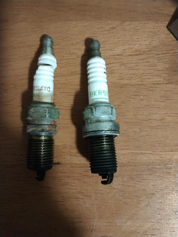

TJ5208 1,841 #128 Posted February 1, 2022 Sad day for the 520 previous owner did this no wonder it wasn't running right ended up breaking one of them. 2 Share this post Link to post Share on other sites
Jeff-C175 7,211 #129 Posted February 1, 2022 25 minutes ago, TJ Salyers said: Sad day for the 520 previous owner did this no wonder it wasn't running right ended up breaking one of them. Those were both in the same engine? Well, that ain't right! Ones got a tapered seat, thother has got a gasketed seat! 2 Share this post Link to post Share on other sites
TJ5208 1,841 #130 Posted February 1, 2022 2 minutes ago, Jeff-C175 said: Those were both in the same engine? Well, that ain't right! Ones got a tapered seat, thother has got a gasketed seat! Same engine 1 Share this post Link to post Share on other sites
lynnmor 9,022 #131 Posted February 1, 2022 Get NGK # TR4/3754 or Champion # RS17YX/909 spark plugs. The NGK are better, Champion no longer produces a quality product. Hopefully the heads aren't ruined from the wrong plugs being installed. I think you need to back up and go over this engine properly and skip the joy riding till it is done. For example, I haven't heard that you did a valve adjustment. We stand ready to help if you want to do it right. 2 Share this post Link to post Share on other sites
TJ5208 1,841 #132 Posted February 1, 2022 4 minutes ago, lynnmor said: Get NGK # TR4/3754 or Champion # RS17YX/909 spark plugs. The NGK are better, Champion no longer produces a quality product. Hopefully the heads aren't ruined from the wrong plugs being installed. I think you need to back up and go over this engine properly and skip the joy riding till it is done. For example, I haven't heard that you did a valve adjustment. We stand ready to help if you want to do it right. Would I need to do a valve adjustment because the tractor was only used to plow snow sorry just trying to make sense of what the valve adjustments do I've been trying to study up on this engine. 1 Share this post Link to post Share on other sites

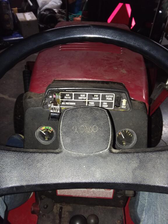

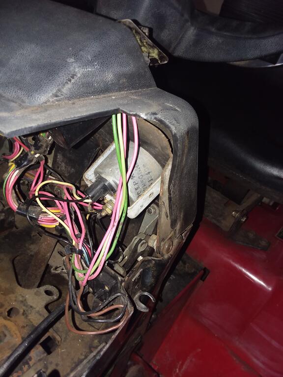

TJ5208 1,841 #145 Posted February 3, 2022 Is there anyway I can fix this Dash it's sticking out and I'm afraid I might break it if I try to do anything about it. 1 Share this post Link to post Share on other sites

Achto 32,432 #148 Posted February 3, 2022 1 hour ago, TJ Salyers said: Is there anyway I can fix this Dash Can you take a couple more pics of the area/ I can't quite see what is going on. 2 Share this post Link to post Share on other sites
