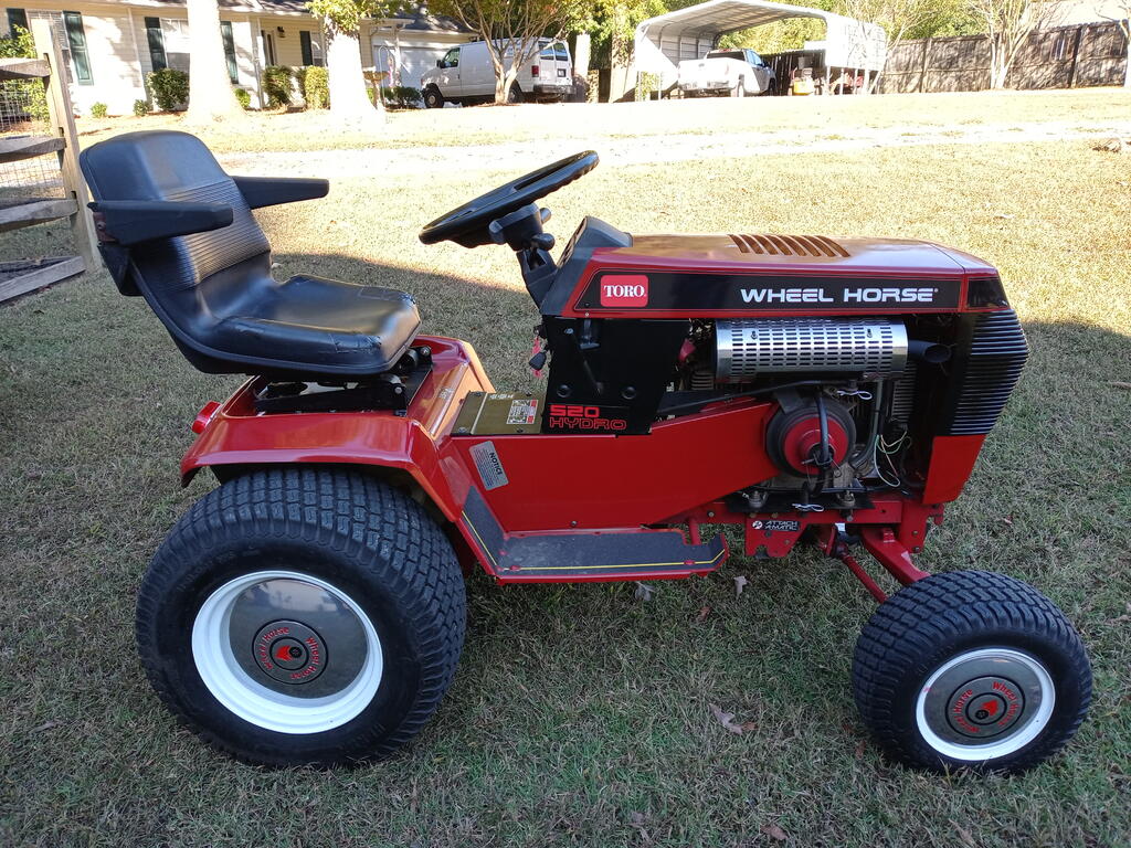

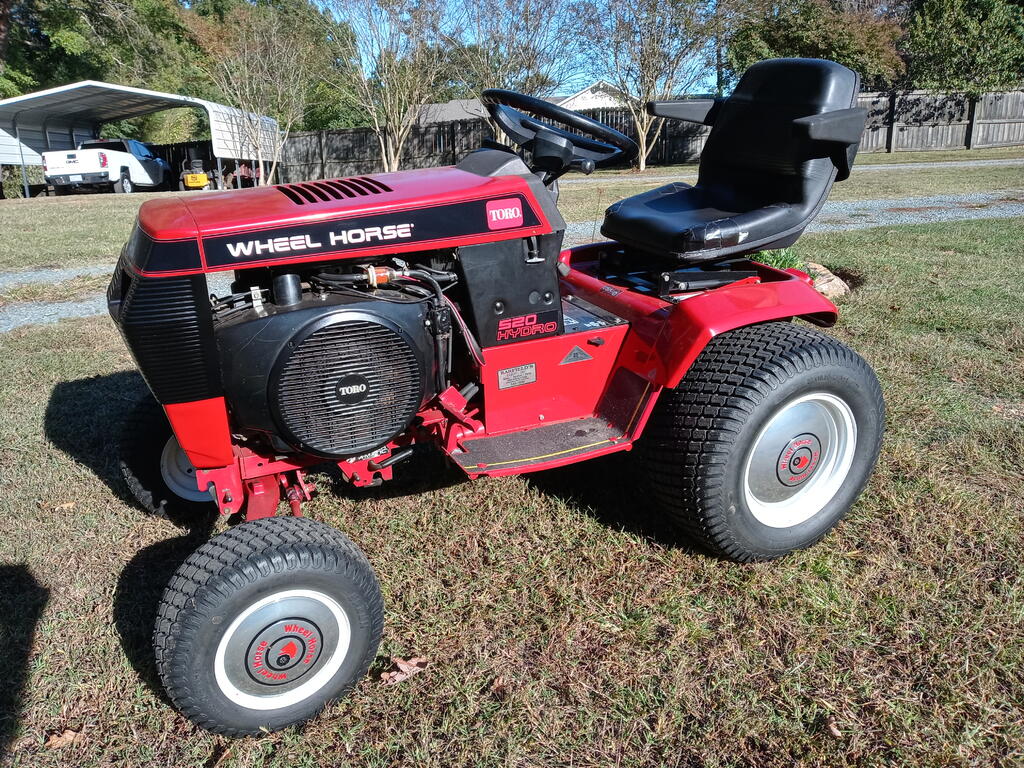

Horse Newbie 7,404 #102 Posted January 28, 2022 Not an 8-speed, a hydro… FullSizeRender.mov 1 Share this post Link to post Share on other sites
TJ5208 1,841 #103 Posted January 28, 2022 May I ask what that is have no clue 1 Share this post Link to post Share on other sites
Horse Newbie 7,404 #104 Posted January 28, 2022 (edited) If you mean my video, it’s my 1994 520H… not trying to hijack your thread. Edited January 28, 2022 by Horse Newbie 1 2 Share this post Link to post Share on other sites
TJ5208 1,841 #105 Posted January 28, 2022 7 minutes ago, Horse Newbie said: If you mean my video, it’s my 1994 520H… not trying to hijack your thread. Oh it's fine nice looking machine 1 Share this post Link to post Share on other sites
Horse Newbie 7,404 #106 Posted January 28, 2022 (edited) Far from perfect for sure, but I like it ! It was a lot of fun giving it a refresh after it being neglected for years. Edit: The neglect was from a PO, not me… I saved it ! Edited January 28, 2022 by Horse Newbie 2 Share this post Link to post Share on other sites
kpinnc 18,310 #107 Posted January 28, 2022 I think your choice of wheel color looks great Tim! TJ- Congratulations on the 520-8. If you take care of it, it will serve you for a long time! 1 1 Share this post Link to post Share on other sites
TJ5208 1,841 #108 Posted January 28, 2022 (edited) @kpinnc I plan on taking care of it I'm already trying to fix it up and I've only had it for 3 days. Edited January 28, 2022 by TJ Salyers 2 1 Share this post Link to post Share on other sites
Horse Newbie 7,404 #109 Posted January 28, 2022 @TJ Salyers I chose a gloss white powder coat for the wheels, and a shiny chrome powder coat for the hub caps because the hub caps were rusty and I really didn’t want to spend the $$$$ to have them re-chromed. Used red and black paint markers to do the horse emblem and black stripe on the hub caps… That was an idea I stole from @WVHillbilly520H 1 1 1 Share this post Link to post Share on other sites

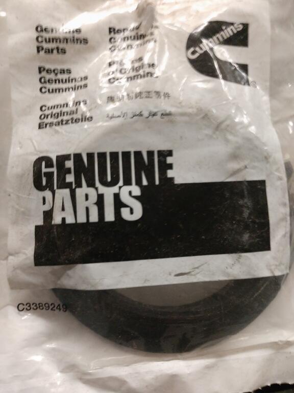

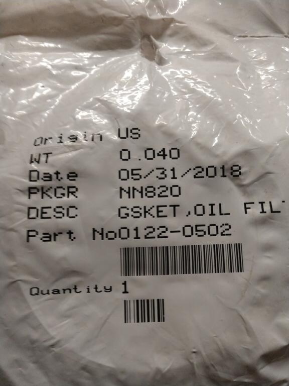

kpinnc 18,310 #111 Posted January 28, 2022 2 minutes ago, TJ Salyers said: @kpinnc I plan on taking care of it I'm already trying to fix it up and I've only had it for 3 days If it was mine, I'd pull that engine shroud off and make sure there aren't any clippings or other debris on the cooling fins. Especially the rear cylinder. And make sure you get an oil filter grommet to help improve airflow on that back cylinder. Part number below: 1 1 1 Share this post Link to post Share on other sites
TJ5208 1,841 #112 Posted January 28, 2022 Just now, kpinnc said: If it was mine, I'd pull that engine shroud off and make sure there aren't any clippings or other debris on the cooling fins. Especially the rear cylinder. And make sure you get an oil filter grommet to help improve airflow on that back cylinder. Part number below: Oh the shroud is clean well it's never been used to mow but the Shroud is clean and thanks for the part number. I love how Air goes in the intake from the flywheel. 1 Share this post Link to post Share on other sites
Horse Newbie 7,404 #113 Posted January 28, 2022 2 minutes ago, kpinnc said: If it was mine, I'd pull that engine shroud off and make sure there aren't any clippings or other debris on the cooling fins. Especially the rear cylinder. And make sure you get an oil filter grommet to help improve airflow on that back cylinder. Part number below: 1 Share this post Link to post Share on other sites
kpinnc 18,310 #114 Posted January 28, 2022 1 minute ago, TJ Salyers said: Oh the shroud is clean well it's never been used to mow Not the shroud, but you have to remove it to see the cylinder cooling fins. Not telling you what to do at all. Just offering opinions from seeing what happens when those Onans aren't kept cool. They are awesome engines- and it's not uncommon to see them with over 3000 hours run time. But if they aren't kept clean around the cylinders, they will throw the valve seats and self destruct. 3 Share this post Link to post Share on other sites
Horse Newbie 7,404 #115 Posted January 28, 2022 (edited) 16 minutes ago, TJ Salyers said: Well since this wheel horse is rare I don't think I'll be doing anything I can't turn back to stock. You find all kinds on here… from pure stock to highly modified. I like mine mostly stock too, but I’m not a purist. Like on my 1994 520H, the wheels are silver stock, but I just like Gloss White on my tractor wheels. Fix it the way you like it, as long as it’s an improvement. Edited January 28, 2022 by Horse Newbie Share this post Link to post Share on other sites

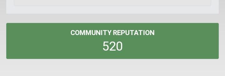

TJ5208 1,841 #117 Posted January 28, 2022 This is hilarious 2 Share this post Link to post Share on other sites
kpinnc 18,310 #118 Posted January 28, 2022 A good solid start! 2 1 Share this post Link to post Share on other sites

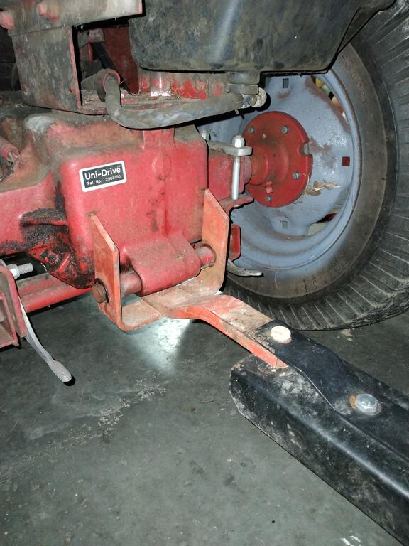

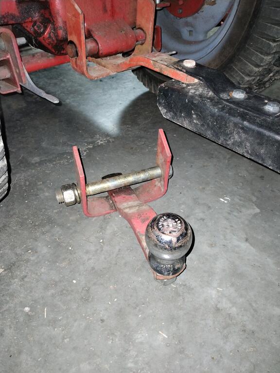

TJ5208 1,841 #119 Posted January 28, 2022 Changed the hitches on the 520-8 2 Share this post Link to post Share on other sites

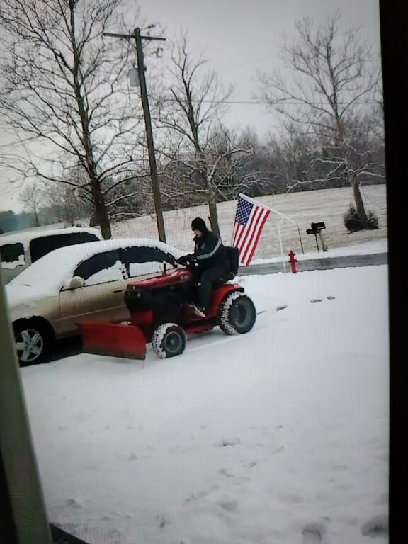

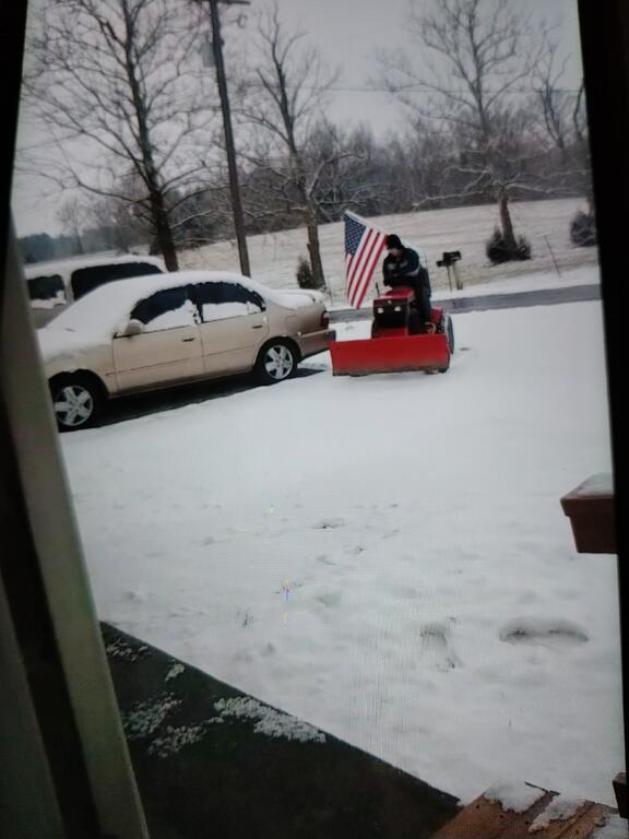

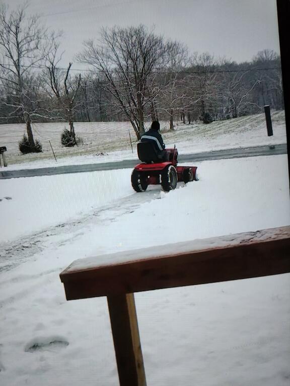

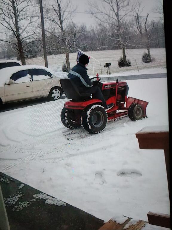

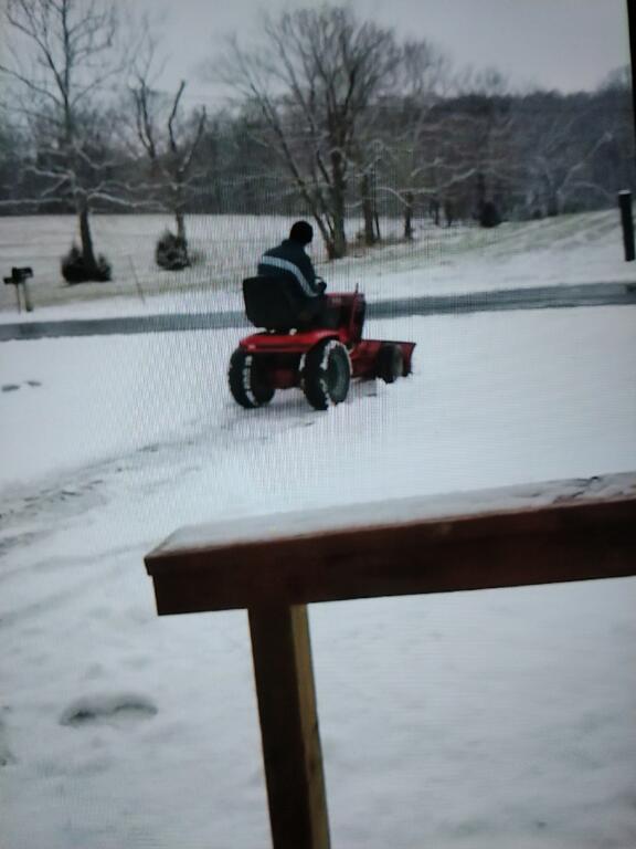

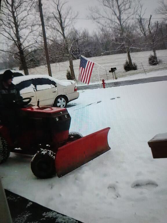

TJ5208 1,841 #120 Posted January 28, 2022 Pushed 2 inches of snow with the 520-8 3 Share this post Link to post Share on other sites
Horse Newbie 7,404 #121 Posted January 28, 2022 2 hours ago, TJ Salyers said: Pushed 2 inches of snow with the 520-8 Couldn’t wait to get out there could ya’. ? 1 Share this post Link to post Share on other sites
TJ5208 1,841 #122 Posted January 29, 2022 (edited) 15 hours ago, Horse Newbie said: Couldn’t wait to get out there could ya’. ? Nope first snow I have ever pushed with a Wheel Horse Edited January 29, 2022 by TJ Salyers 1 Share this post Link to post Share on other sites
Reddart 213 #123 Posted January 29, 2022 14 hours ago, Horse Newbie said: Couldn’t wait to get out there could ya’. ? Yeah, good thing he had the 520-8. My C-101 would have been bogged down in that blizzard. 3 Share this post Link to post Share on other sites

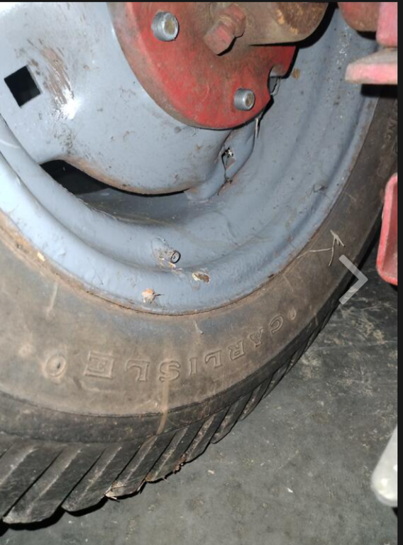

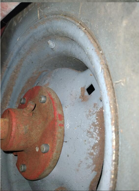

TJ5208 1,841 #124 Posted January 29, 2022 Is there anything I can do about this I have to pry the valve stems to get the air chuck to go on the I'm planning on filling all four tires. They all have tubes 1 Share this post Link to post Share on other sites

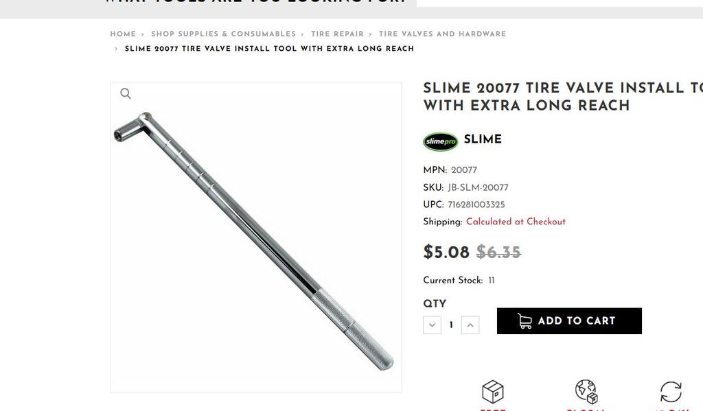

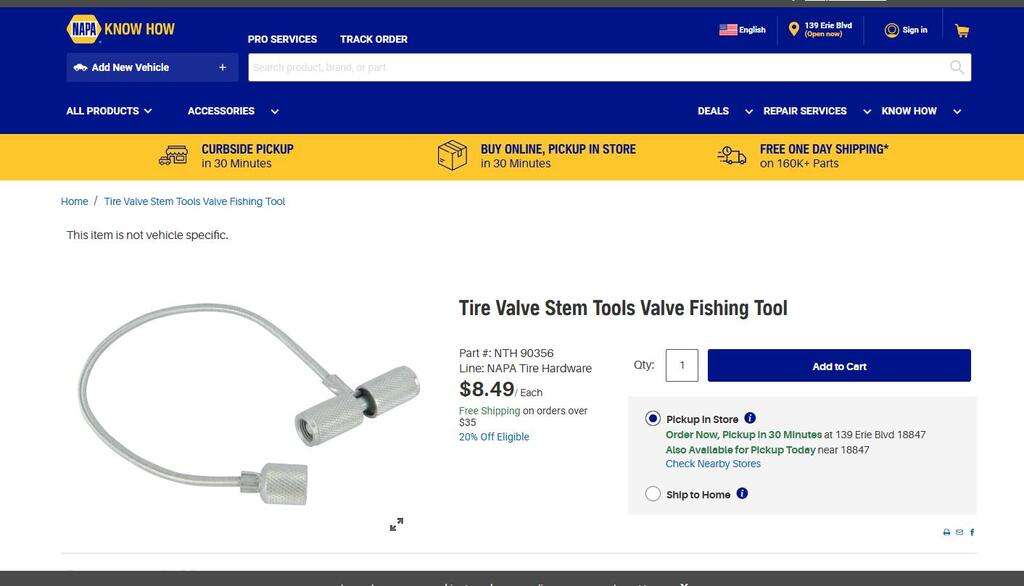

pfrederi 20,619 #125 Posted January 29, 2022 (edited) you thread on a tool like theses then you can pull the valve stem out further. I prefer the cable one Edited January 29, 2022 by pfrederi 1 1 Share this post Link to post Share on other sites
