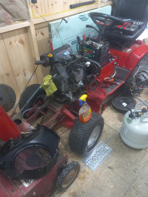

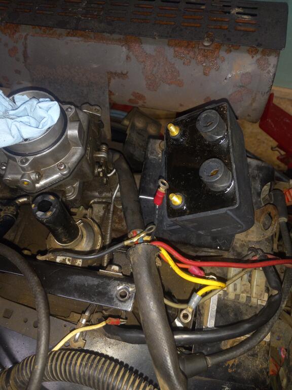

Cee245 856 #1 Posted February 2, 2022 (edited) Hi! I recently purchased a Harley coil for my P216g Onan on my 416h. My old one tested bad and it was backfiring before I got it in the shed. Hasn't been running good lately. How do I tell which is positive on the new coil? There are no markings! To top it off, I can't remember which wire goes where. There are 2 black(one from a condenser?), a red, a yellow that I see. I've looked at a schematic but I can't tell where they go. I know the spark plug wires don't matter which post they are attached to. Trying to get it running before the storm tonight! Edited February 3, 2022 by Cee245 Changed title since it's become bigger than fist thought Share this post Link to post Share on other sites

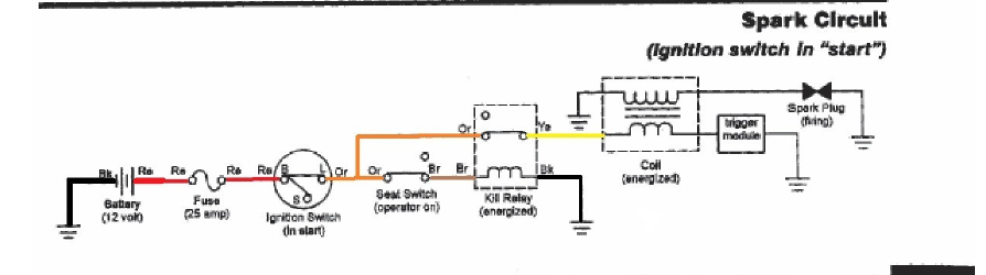

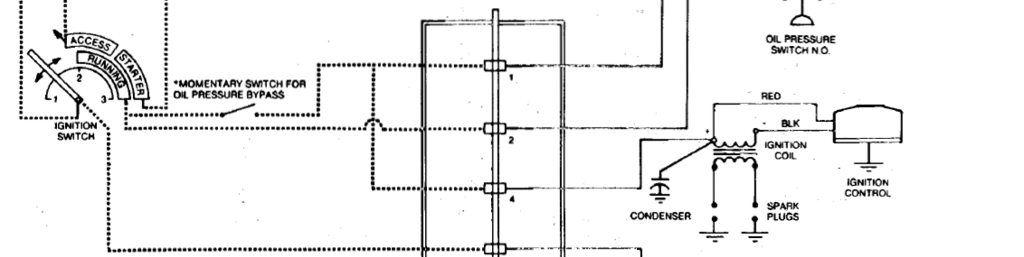

WHX?? 57,277 #2 Posted February 2, 2022 (edited) 38 minutes ago, Cee245 said: How do I tell which is positive on the new coil? The coil posts are not polarity sensitive as long as one sees 12 volts from the key switch and the other one sees the trigger module. To find out what wire is what is going to be a problem. You can easily find out which one is +12v by turning on the key and using a test light or DMM. The other wires go to ??? Might have to trace them out but one at least has to go to a trigger module. Hind sight 20/20 I know but you should have marked the wires before taking off the old coil. The wires should just drop on the new coil the same has the old one. Here it shows a yellow +12v wire from the kill relay to the coil but thats it. The yellow may change colors in the nine pin so be careful. These are from a '97 520 but should be the same? This one doesn't help much more Edited February 2, 2022 by WHX?? Share this post Link to post Share on other sites
Cee245 856 #3 Posted February 2, 2022 I'm showing 12v at the yellow wire with key on. I'm working on it now. Will update .. 1 Share this post Link to post Share on other sites

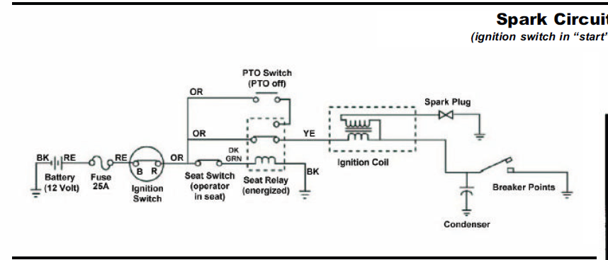

WHX?? 57,277 #4 Posted February 2, 2022 Heres another showing a points setup & just guessing the two blacks may be points and condensor??? Share this post Link to post Share on other sites
Cee245 856 #5 Posted February 2, 2022 It does not have a points system. It's a 97. I have a points system on my 86 417a. 1 Share this post Link to post Share on other sites
lynnmor 8,875 #6 Posted February 2, 2022 There are a pair of wires, usually red & white in a jacket, coming up from the trigger coil. The white wire goes to one terminal, all the rest go to the other. 1 Share this post Link to post Share on other sites

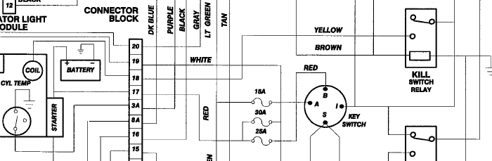

WHX?? 57,277 #7 Posted February 2, 2022 Service manual shows a red & black with the red being connected to +12v. 1 Share this post Link to post Share on other sites

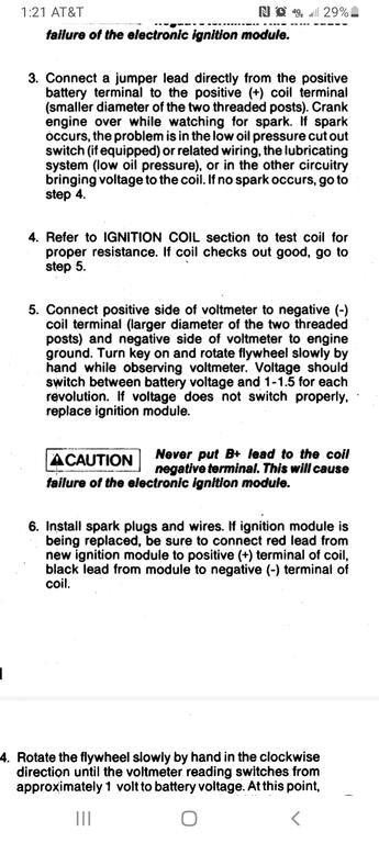

Cee245 856 #13 Posted February 3, 2022 (edited) I looked over wiring etc. It looks good. In the picture, I did step 5. My meter read about 0.88 and did NOT move when rotating slowly by hand. It says replace ignition module. Isn't that the thing under the flywheel? Side note, thankfully I have my 417 to take care of this storm while the 416 is down. Edited February 3, 2022 by Cee245 Add pic Share this post Link to post Share on other sites
lynnmor 8,875 #14 Posted February 3, 2022 1 hour ago, Cee245 said: I looked over wiring etc. It looks good. In the picture, I did step 5. My meter read about 0.88 and did NOT move when rotating slowly by hand. It says replace ignition module. Isn't that the thing under the flywheel? Side note, thankfully I have my 417 to take care of this storm while the 416 is down. Yes, that's the thing under the flywheel. Double check your steps to be sure that is the problem, pulling the flywheel can be troublesome. The ignition modules are expensive and used ones might have you doing a lot of work with poor results. Also check the ring that contains the magnets, a screwdriver should stick to it in two places, if it is black in color replace it with a new gray one, the older black ones have a higher failure rate. onanparts.com puts together a kit that provides the parts to do it right. I made a puller for the flywheel so I could use all four bolts, all you need is a steel plate about 3/8" thick with holes for the four bolts and a threaded hole in the center. Share this post Link to post Share on other sites
