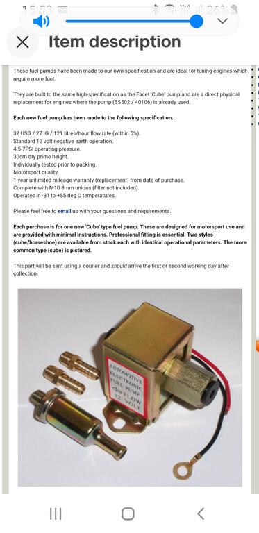

Mickwhitt 5,259 #14 Posted February 1, 2022 is this the kind of thing that will work? 1 Share this post Link to post Share on other sites
ranger 1,862 #15 Posted February 1, 2022 Loads of them for sale on “the bay”, Mick. Make sure you get one that has a max pressure of 2-3 psi, or fit an adjustable regulator, again quite reasonable prices. 1 Share this post Link to post Share on other sites
ranger 1,862 #16 Posted February 1, 2022 2 minutes ago, Mickwhitt said: is this the kind of thing that will work? That one looks to have a bit too high a pressure, you would certainly need a regulator with that. 1 Share this post Link to post Share on other sites

Jeff-C175 7,211 #20 Posted February 1, 2022 (edited) 1 hour ago, ranger said: too high a pressure, Agreed... @Mickwhitt there's a model that has 1-2 PSI of pressure. Facet/Purolator 60304 "kit" with fittings FEP304SV or 60246 NAPA 610-3021 Edited February 1, 2022 by Jeff-C175 2 1 Share this post Link to post Share on other sites
